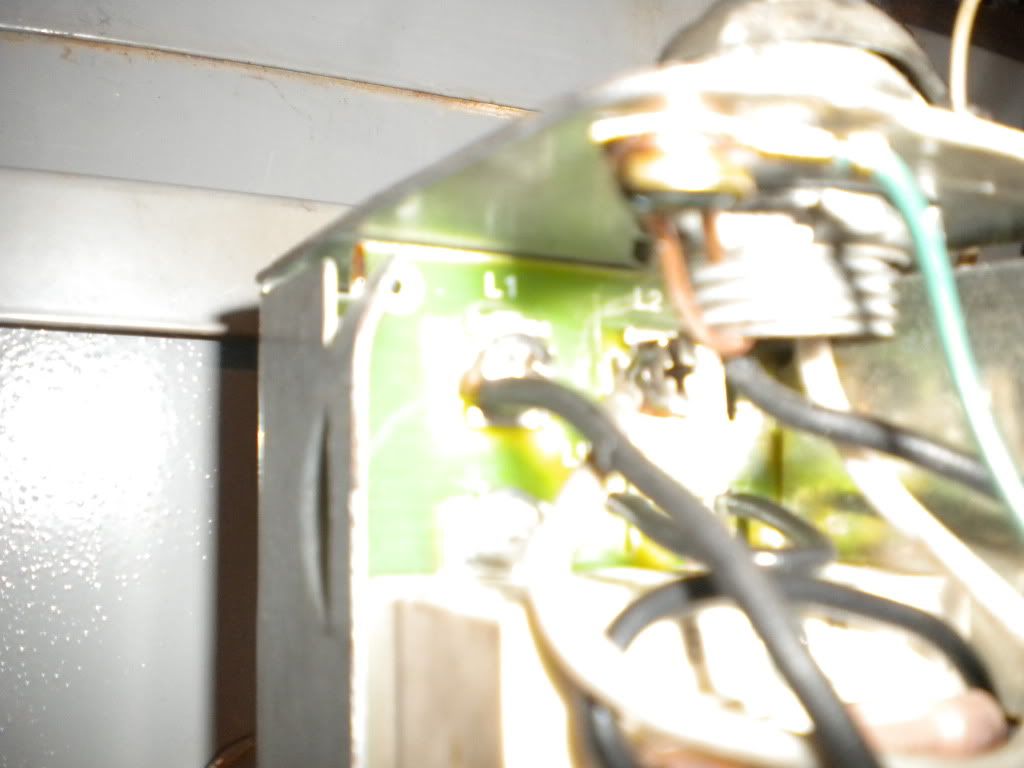

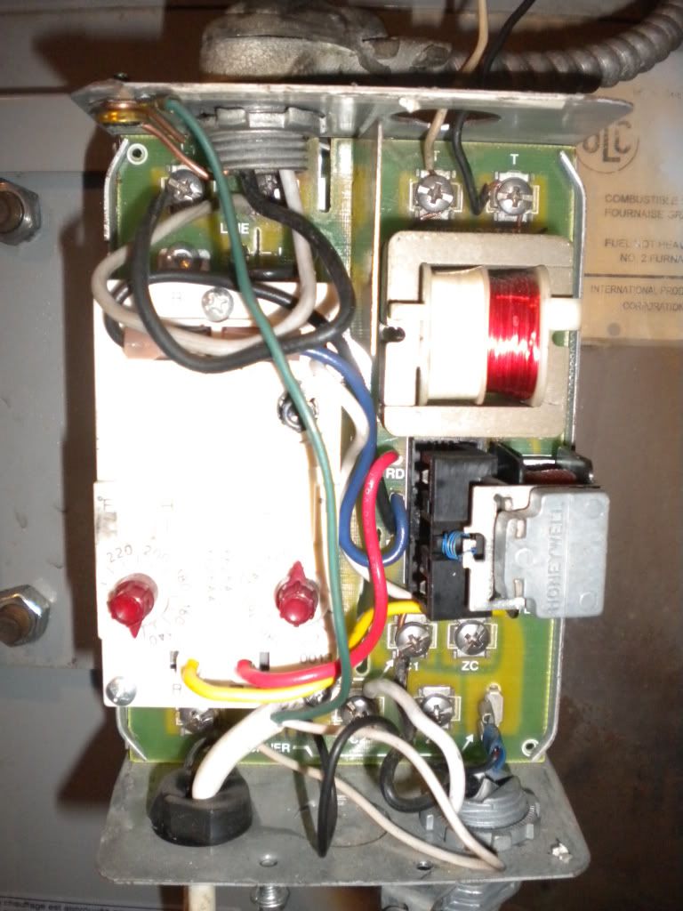

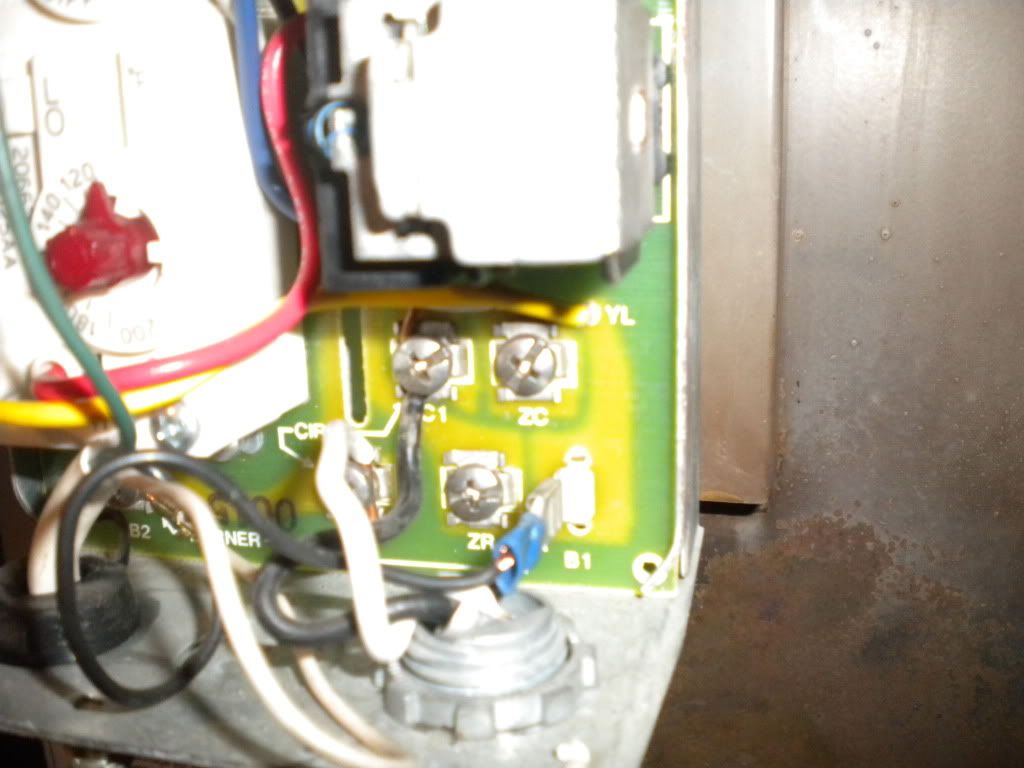

The wiring is as follows-
L1-black
L2-White
B1-Black
B2-White
C1-Black
C2-White
Clark HMT-14 145,000 btu. hot water boiler

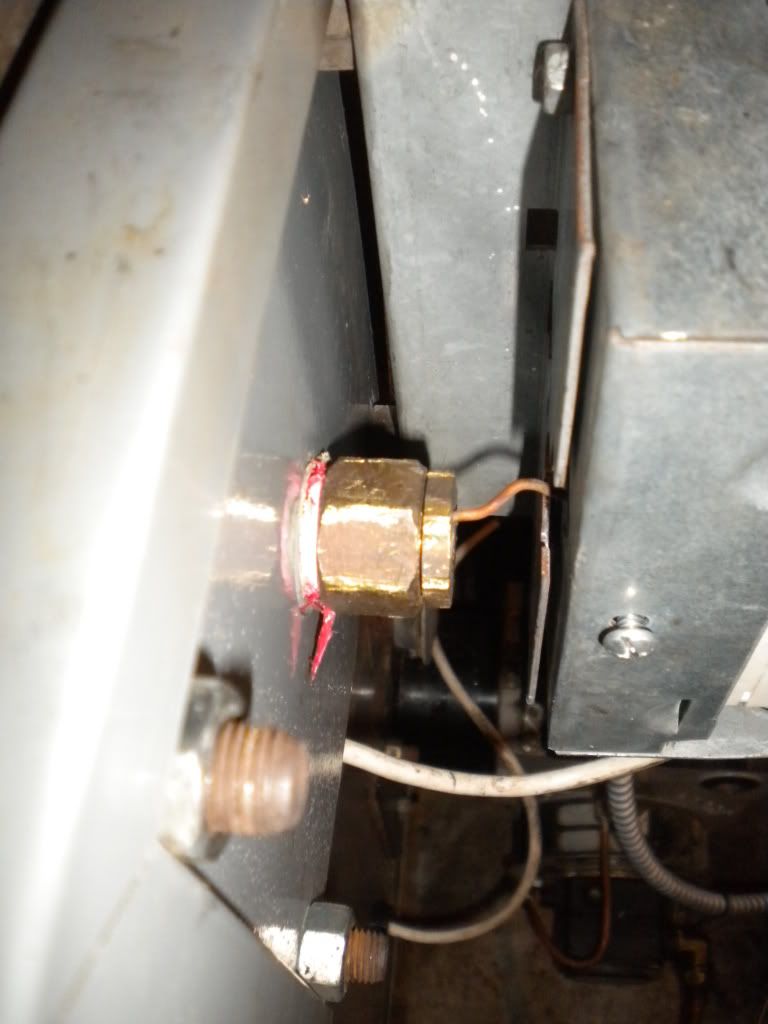

Is there a way to see if the capillary tube is damaged? I am assuming its the copper wire coming from the back of the relay into the boiler?
Here are some images to help if needed
I turned the LO and HI down while the boiler was off, I havent started it up yet until I get some opinions first

Sounds (and looks) from what I can see, that the wiring is OK... B1 and B2 are going to the burner? C1 and C2 are going to the circulator?
Did you install it or did you have someone do that?
Yes, it looks like a wire, but it's a very small tubing... the only way to tell is by carefully examining it... looking for 'kinks' in the tubing.
If the first picture is the tubing coming out of the aquastat, and into the boiler, then yes, that is the capillary tube.
Was the aquastat taken off when the boiler was moved?
And this is just installed in your home and this is the first time you've fired it up?

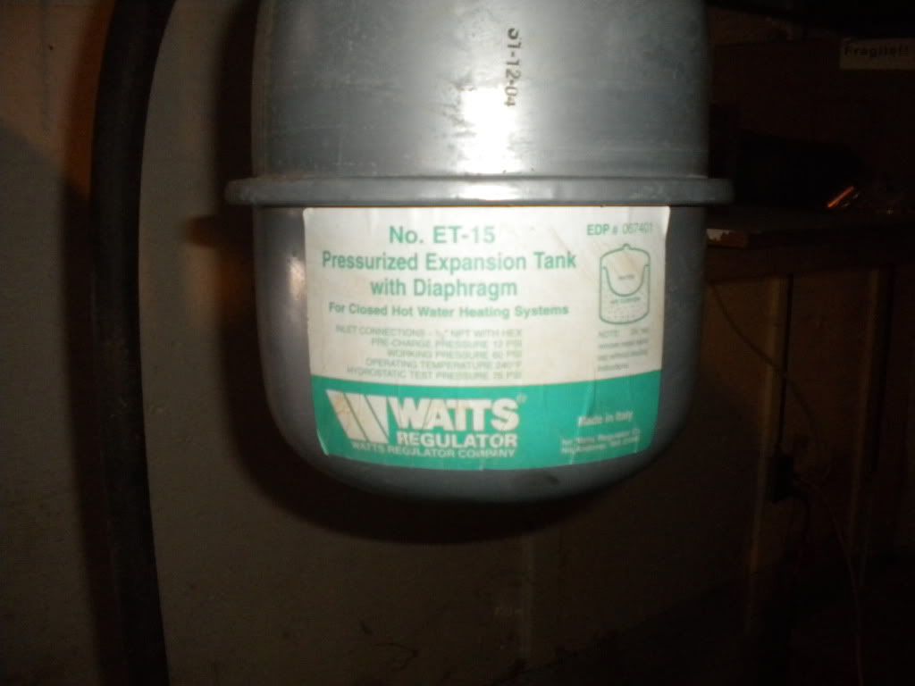

Your pressure problem is the fact that the expansion tank is not properly charged with air, and if it was a used one that came with the system, it may have a defective bladder... but first, try to charge it...
You must follow these steps...
1. Turn off boiler and allow to cool to 100F or less. CLOSE the water feed manual shut off to the boiler.
2. DRAIN ONLY ENOUGH WATER FROM THE BOILER TO DROP THE PRESSURE GAUGE TO ZERO. DO NOT DRAIN THE BOILER COMPLETELY! ONLY DROP TO ZERO ON THE GAUGE!
3. With an accurate tire pressure gauge and a small air compressor or bicycle pump, add air to the schraeder valve until you have 15 PSI in the tank.
4. Check the boiler gauge again, it will probably have risen from zero... Drain more water until it is again at zero.
5. Check the tank air pressure again. If it has fallen from 15, add more air to the tank.
6. Repeat steps 4 & 5 until you have 15 PSI in the tank, and ZERO pressure in the boiler.
7. When step 6 is satisfied, open the water fill and pressurize the boiler to 12-15 PSI when cold, and turn it back on. If the bladder in the tank is OK, the pressure should not rise more than say 8 PSI or so when it gets hot.

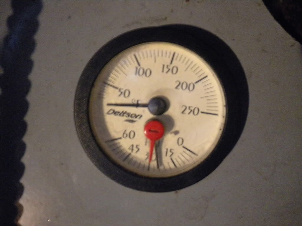

Okay so with the manual fill vavle closed i fired it up and still the same problem, pressure went up to 26 psi, the temp is reading only 75F
I am also noticing that when i move the LO to 120 it "clicks" on and the reading is showing 85F and pressure is 24 psi and no circ pump running, the high is set to 140. I can manually turn the LO up and it will click on, but if i leave it run the pressure gets too high so i turn it down to 120
Also, the temp gauge reads 80F and the pipes are too hot to touch, i lick my finger and it evaporates right away, could the temp gauge on the boiler be wrong? I had the boiler running for about 45 min turning it on and off because of the pressure being to high.

Yeah, if you can't touch a pipe that the gauge says is at 80F then something is definitely wrong! A human can generally grab a 120 pipe for a second or two... 80F you should be able to hang onto forever... And if the boiler is getting that hot, then it makes sense that the pressure keeps going up and up...

It seems that the temperature gauge is bad... if as mentioned earlier you can't grab an 80F pipe... that something is very wrong there. You need to determine that problem first...
Next, your aquastat doesn't seem to be in control of the temperature... and that also needs fixing. I've recommended that you check that the temp sensing bulb is fully inserted into the well and that the capillary tube has no kinks in it for it's full length.
I believe that what is happening is that the boiler is overheating and the pressure is going out of control. In a NORMAL situation, expansion tanks are PROPERLY SIZED for a certain temperature range. Water will expand a bit under 4% in volume when heated from room temp up to 180. THIS, with a bit of safety margin is what the tanks are sized for. If you heat the water PAST the safety margin, the expansion tank can't handle that extra volume, because the water will continue to expand, the hotter it gets...
So, the FIRST thing to do is to get an accurate temperature gauge on there. You are peeing into the wind if you try to troubleshoot without knowing what's going on...

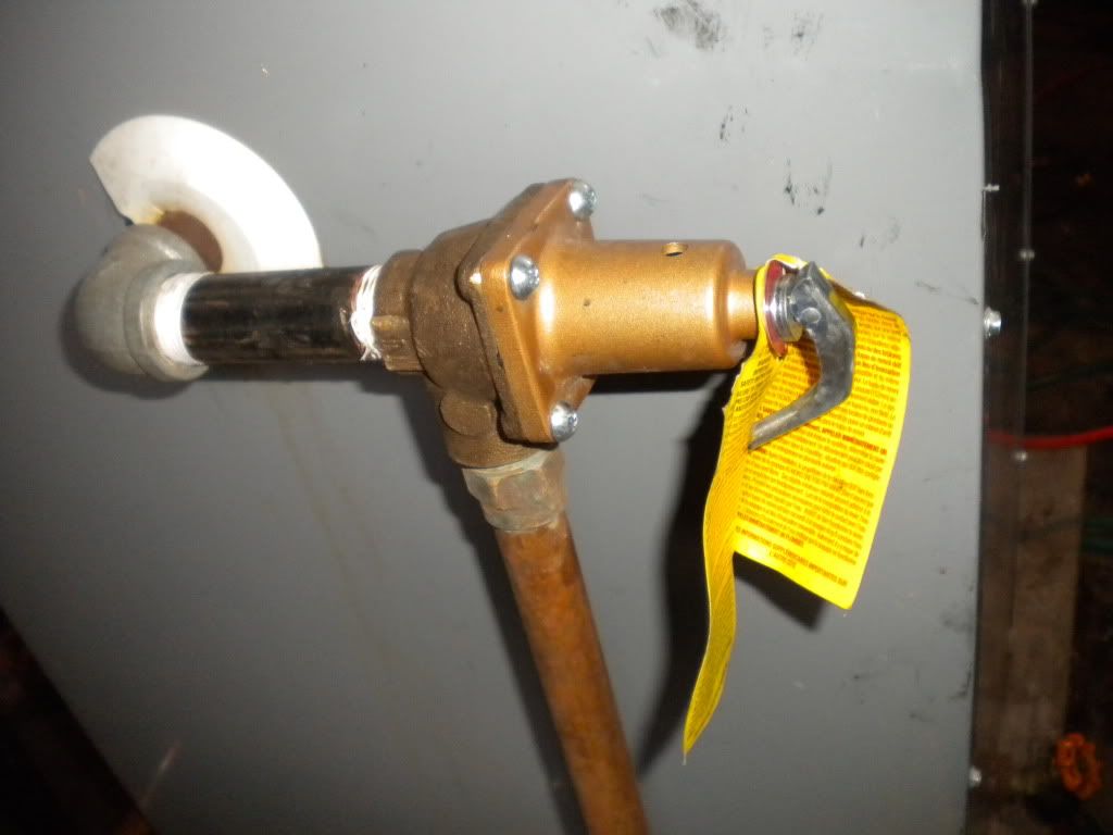

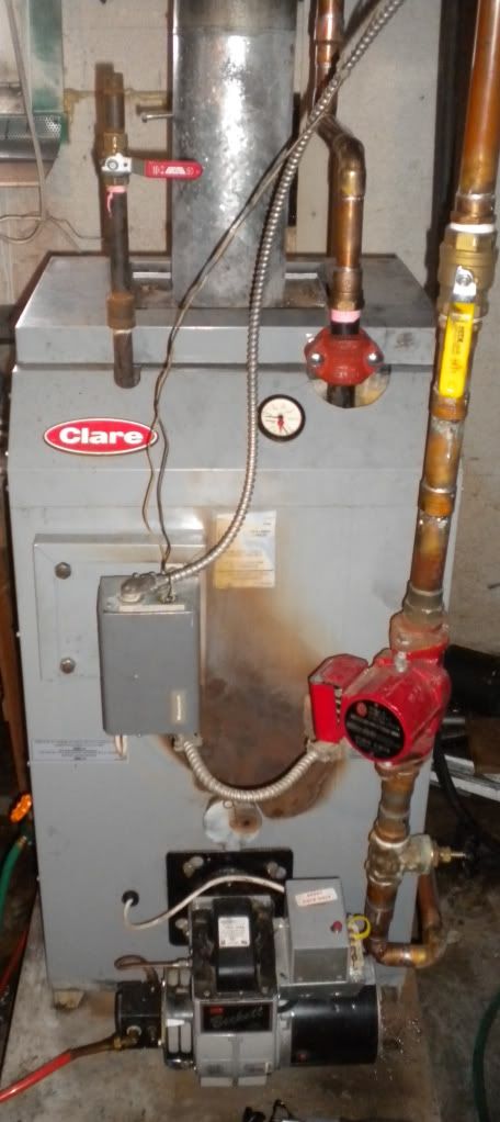

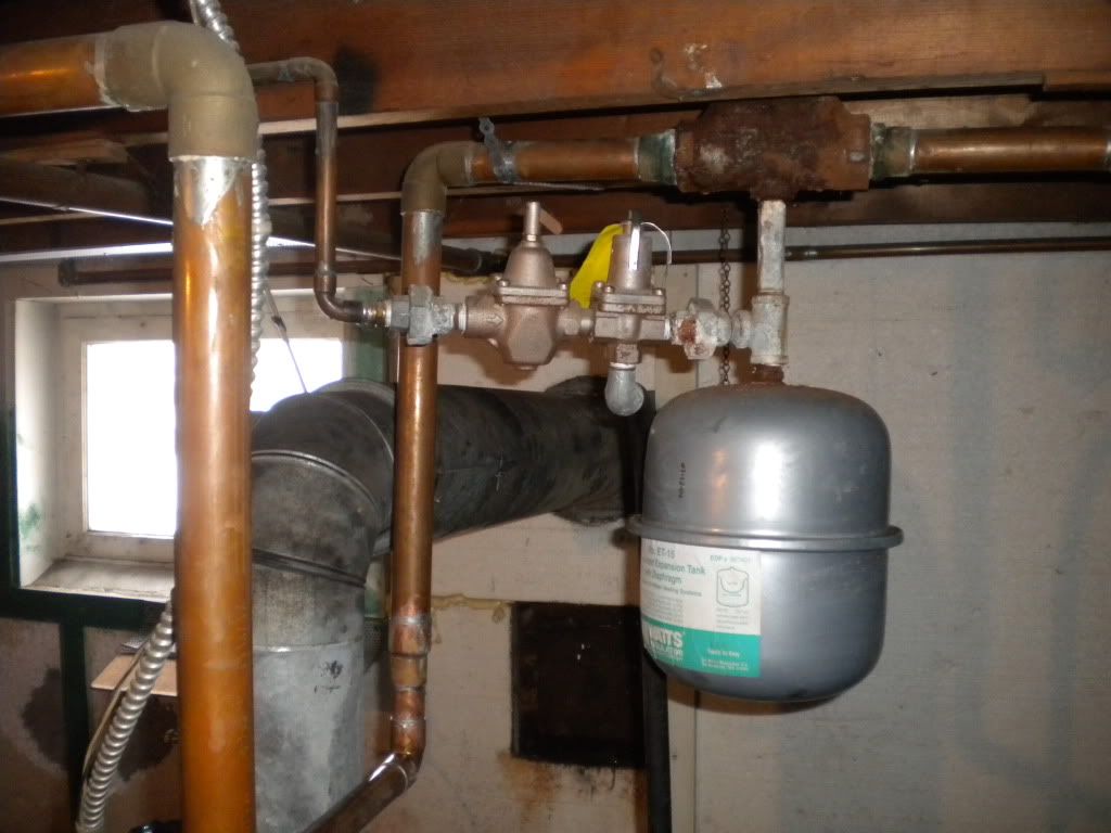

Let's see some more pictures of the installation...
I'd like to see:
The water fill piping... do you have a 'pressure reducing valve' installed properly?
The gauge and how it's mounted.
The expansion tank and how it's mounted.
(also tell us what SIZE the expansion tank is, and what type of radiators are in the home, whether fin-tube baseboard, or big ole cast iron rads with huge pipes...)
Pull back with the camera and let us see the WHOLE boiler system.

First, I'm kinda surprised to see a '15' expansion tank there. That was probably 'marginal' with the old system... and could well be too small with this one. I would recommend you go up to a '30' size tank.
I would replace that gauge... It looks to be about a million years old.

Okay I will get a bigger expansion tank and see if that works out

I removed the aquastat by disconnect the wires, unscrewed the bulb, took it out, replaced a plate and put the bulb back in. The bulb and capillary tube is attached to the aquastat. The bulb i pulled out was about 5" long, im guessing the well is the long piece
So that bulb went back into the same place it came out of then?
The 'well' is the tube in the boiler that the bulb is inserted into.

Received 0 Upvotes on 0 Posts
yes in the picture where you see the capillary tube behind the aquastat is where the bulb was origionally

OK, here's the thing... the type of aquastat that you have is designed to be used on a boiler with the coil. Not to say that it won't work on a boiler without one, it will... BUT, it is designed to keep the boiler warm 24/7, and you do NOT need, OR WANT that... because it will burn fuel for no reason at all.
I would recommend that you change it out for an aquastat that will allow what we call COLD START. ESPECIALLY because it doesn't seem to be working properly anyway. Take a look at this unit:
L7224U1002 - Honeywell L7224U1002 - 120 Vac Oil Electronic Aquastat
I'm not SURE that the tank change is going to 'solve' anything, but it will most likely help the situation... the new boiler might have more water in it... and if the tank was marginal on the old system, the extra water might have pushed it over the edge.

Another thought... it's pretty easy to get the circ pump turned around and pumping the wrong direction... Yours should be pumping DOWN and INTO the boiler. Is it?

Yes it is pumping IN the direction of flow shows that it is.
I will try a new aquastat and new tank

And a new gauge too....................

would it be worth taking the aquastat i have in my old boiler and use that? The old boiler used a cold start one as well or just buy a new one?
  #39
Old 01-18-11, 06:25 PM
NJT's Avatar
NJT
NJT is offline
Join Date: Oct 2006
Posts: 19,710
Received 8 Upvotes on 6 Posts
Assuming that the old boiler was also OIL fired, yes, as long as it works... why not?
Be sure to treat that little tubing gently!
What model is it? L8148A ?

Yes it is oil fires, it is an older one i think, L8048A, seemed to have worked fine before
