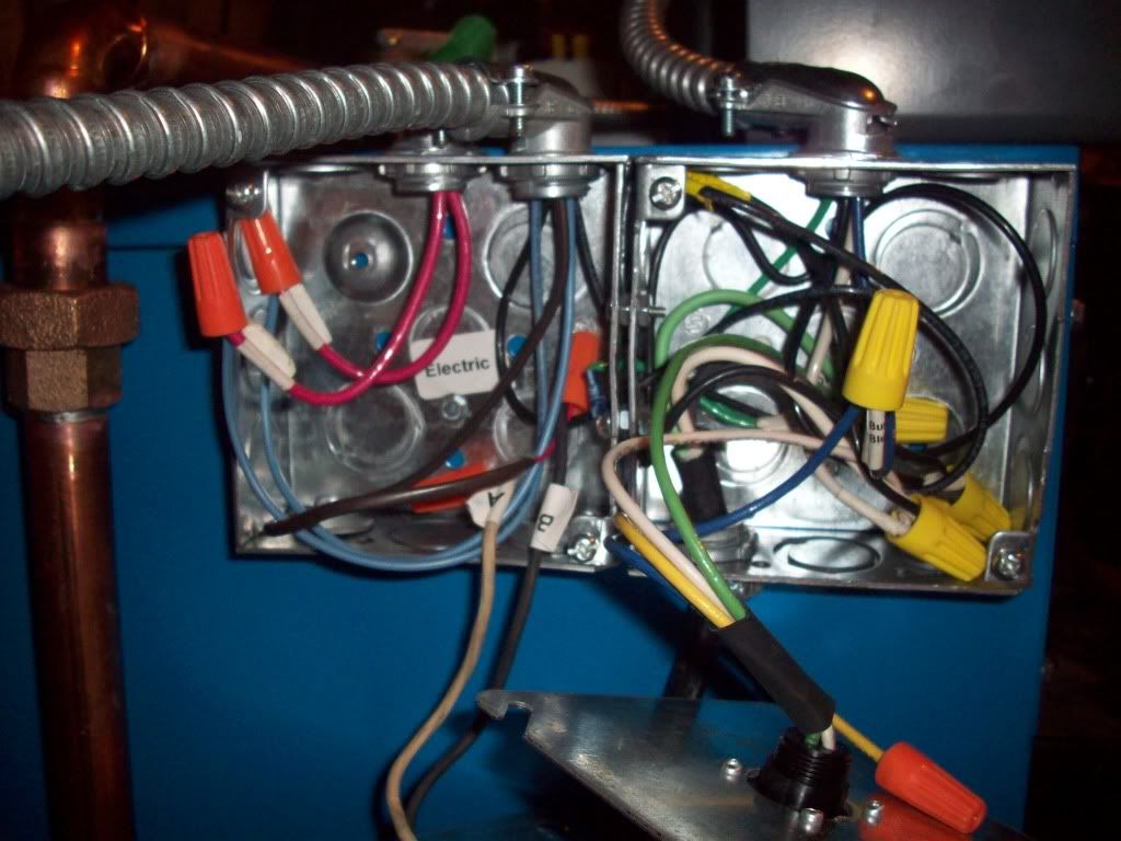

Now I did it... I tried installing the new primary (Carlin 60200-2) according to directions from AgSolutions (which differed slightly from the schematic from Carlin). The burner started up and was spraying oil, but no ignition. I double checked and everything was as directed. I pulled the new primary and put the old one back on, (following Kagi schematic) The burner started up and sprayed oil, but no ignition. Now I wonder, did the igniter get messed up by an incorrect primary hookup? I am 100% certain that I put the old one back on correctly, and all wires are where they were when I started.
I replaced the draft prover switch that the installer broke. Now it says I have insufficient draft, as everyone here has already pointed out (you guys are too smart!)
Installer removed all of the sealant and had adjusted the broken switch to such a low level that a mosquito fart would trigger it. So now I need to increase the draft. To test the boiler while installing the new primary I put the old busted one back on with the scabbed plastic hose and copper tube. It worked to convince the power vent control to allow the burner to start.
Allwayslearning>>>>> the vid helped, but I still feel clueless. My boiler temps: on at 140 off at 155. I dont have a tempering valve set up yet, and I can't get my floors too warm. Once I get the thing going strong I will tackle the tempering valve issue and kick it up a few notches.
SOOOOOO, how do I figure out the problem with the ignition? How do I convince my wife not to shoot me for thinking up this crazy idea?

If the motor runs, you should have an arc. I can't see how you could possibly
hurt the transformer. There is a rat's nest of wires in these things. The only
reasons for no ignition arc are; wrong switch position, loose or bad electrical
connection to the transformer, shorting of the secondary (arc) voltage
including @ the electrodes/retention head, or a bad transformer. Ck all
Connections including the factory crimped on connectors. If you are comfortable
doing so & need to, test the transformer. The temps I've posted are for the
benefit of the operation of the burner. The combustion chamber needs to reach
a stable temp for proper adjustment and efficiency. You need more differential
and a minimum start temp of 150. Until you fix this and the draft you are banging
your head against a wall. Please first things FIRST.

I will check all the wires and crimp connections tomorrow. Perhaps one of the wires pulled loose from the switch.

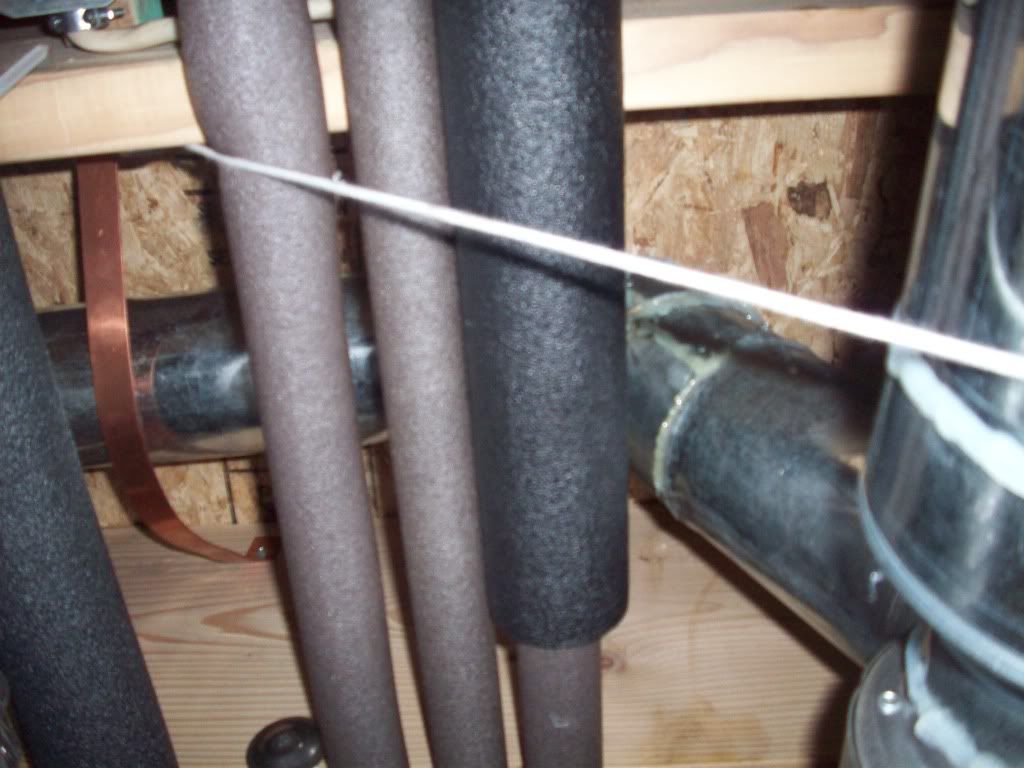

I ordered the draft inducer based on the recommendation of the installer, who I now know is completely incompetent. :NO NO NO: The inducer is 4”, and the flue is 6”, so it reduces in size at the inducer by 2”. The pipe is also single wall... I assume it should be double wall, right?

Let your wife shoot that installer!! I thought your stack was 8" into 6".
With 6" into 4" it's no wonder you have draft problems. As you now know
this burner is a different animal. Are you exhausting into a masonry chimney?
Please describe the stack system in detail. Double wall stack pipe is for insulating.
It will draft a little better (hotter conduit) but in your application won't make
a noticeable difference. As for your tempering problem, how much area are you
trying to heat? Where in NY are you located? How many and what type of zones do
you have? Can you simply install a bypass valve at the circulator to limit volume?
How was this area heated before & how well did it work? My burner is the same
as yours but my boiler & system are completely different. Someone who is truly
knowledgeable in hydronic heating can make your head spin if you can find one.
If you have floor heating, splitting it up so that you have a supply loop and return
loop with several taps & valves on each tap may give you comfort control as well
as allow you to use hotter water. I am now grasping at straws. Lets get the burner
to work reliably.

I am exhausting through the rim joist with a Tjernlund VH1-4. The boiler is an Axeman-Anderson NPO87. http://www.axeman-anderson.com/pdf/npo.pdf The flue connection at the boiler is 6". The house was always heated with radiant floor heat since we built 7 years ago, and was originally heated with a 50 gallon propane DWH as seen in the pix. It worked well, but was inefficient and expensive do to the undersized heat source (all we could afford at the time... $200 DWH propane dealer special) It is still used as backup and the boiler water is constantly circulated into the tank. Our house is approximately 2100 SF, super insulated. The heat is even and pleasant throughout. We are located in western NY, between Buffalo & Rochester, and we get lake effect from Erie and Ontario. We have two equal zones currently, 1st & 2nd floor, each with a Grundfos circulator pump, no zone valves. We have a supply and return manifold on each floor, with 4 equal loops on each manifold.
Back to the burner. I just checked all wires, crimps and switches. All crimps and switches had solid connections. I cut stripped and reconnected all wires at the terminal strip. All stripped ends are sound and fully inserted into the terminal strip and tightened appropriately. The bus bar springs are positioned correctly to make contact with the igniter. I put it all back together and plugged it in. The burner started up, motor spun, and oil sprayed, but no click, no ignition. There was plenty of oil flowing as evidenced by the cloud coming out of my barometric damper after I pulled the plug.
I have an HV probe for my Fluke 27 FM multimeter… what specs am I looking for to test the igniter? Any other ideas?

I forgot to mention, the electrodes are clean, and are gapped and positioned correctly. I traced every wire of the rats nest with the Kagi schematic and all connections are correct.

You could disconnect BOTH primary wires from the transformer & plug them
into 110 VAC. You should get an arc across the electrodes. If not there may
be a short or open under the transformer or in the blast tube. I can't post
how I usually ck these things because you could get knocked on your a**.
Maybe it's time to call that "installer" and get something useful out of him?
It will be nice if he has a spare, as it will take a while to get a warrantee
replacement from Kagi.If no warrantee, getting one locally will be faster & maybe
cheaper. You could return that new control. Older style transformers produce
lower voltages than the newer ones, and MAY require less electrode gap. They
are ok for a spare but I recommend the high voltage type. Wire it for constant
ignition! I think your original control is fine. As Rick pointed out, the light needs
to get through the combustion head. With a -7 nozzle and your draft condition,
the flame must have been dark also. My chamber is 18" deep & open at the top.

Ha! Finished shoveling? You are an optimist! I spent a few hours out there today, but I am no perfectionist. Pushing it around with a BX2530 loader bucket is not a pretty thing, unless you like giant snow sushi rolls coated in gravel. I can't afford the plow guy this year so it's good enough for me.
Ok... now shopping for 6" draft inducer and dreading the rework of the termination through the rim joist in the snow. I guess I'll step it down to the existing 4" hood near the hood, after the new inducer and see how it works :NO NO NO: (???)
It's still burning. I had to hit the reset a few times, and most of those would go... push click push click push click start. Then it would start and run fine till next cycle. The Inducer and draft fan are wired through the Tjernlund UC1 control, fed by boiler. http://www.tjernlund.com/tjernlund_8500004.pdf
Here is schematic for the boiler: [IMG]http://i915.photobucket.com/albums/a...tup/KagiWS.jpg[/IMG]
Here is a link to the primary control information (the one I want to use, not the one I am using) Carlin Combustion Technology - Technical Service Bulletin 011
I scored a $10.50 sparco 3/4" mixing valve on ebizzle including shipping like http://www.nofossil.org/manuals/am101mixingvalve.pdf. That should work well enough for me to raise the upper temp to 175 or so.

Why keep on guessing what the problem is? I know it's gonna be miserable work to do it, but just make that thing 6" all the way out when you get the new inducer. Otherwise, it will always be a question as to whether it is still an issue or not.

Why would you need the Carlin control? I think you'll need 6" all the way
but we'll see what happens. So, the TT on the burner commects to #s
3 & 4 on the UC1? What tells the UC1 that there is a call for heat,(terminals
A & B) an aquastat?
A & B) an aquastat?

The Carlin control is already in my possession, and would provide an alarm when it is in lockout. Terminals A&B on the UC1 are connected to the Honeywell L4081a aquastat. Terminals 3&4 on the UC1 are connected to the T terminals on the primary. L&N on the UC1 are pretty obvious… Line and neutral. Line is connected through the 750P-MT-120 LWCO. N terminal on the UC1 is connected out to the HS1 inducer (1.37A) and the inline combustion air fan (.35A). M terminal on UC1 is line out to HS1. MTR terminal on UC1 is line out to combustion air fan.

The recent silence on this thread speaks volumes! I'm frightened. Is that some
kind of rope as a hanger? If that stack comes loose it could kill everyone in the
building with co! Why didn't you punch through the foundation? Please find a real
furnace installer who knows local code! Make the draft inducer the last part of
the stack indoors. The piping downstream of the draft inducer is pressurized!
I might be off base, or be paranoid about safety but I wouldn't do it like that.
I don't know what is on the outside of your house, but I would have a masonry
thimble to a masonry or double walled stainless chimney with a cleanout either
way. Screws in every indoor joint. If you exhaust below the peak of the building
you WILL; blacken the siding, etch the windows and have the gasses enter the
structure. Again maybe what you have is acceptable, but it scares me!
PLEASE will some of you knowledgeable HVAC GUYS CHIME IN?

Sadly, I thought I did hire someone knowledgable to do the install, but now I realize I did not. I have a CO2 alarm right next to the boiler, but that is not enough to make me feel safe now.... I feel like I have been robbed by this installer.
I guess I should just shut it down and put it by the curb at this point, since I have blown the last of my money on this system as it is. Until I find a job I have no money to upgrade anything, and no one I have spoken with is even willing to come look at the thing.
The vent is direct through the rim joist to a Tjernlund hood, approx 1.5 feet above grade on the north side of the house. Everything was done per his suggestions. It does seem to be in accordance with the Tjernlund installation instructions. I am not sure about code here. Permits are not needed for any of this type of work in this town or county.
I guess the good news is that spring will be here soon, so I won't have to worry about how to pay for the propane for too much longer.

B-vent is only for gaseous fuels. There IS insulated metal piping for liquid fuels but I do not know the classification.
In my opinion you have learned an expensive lesson, heating with waste oils IS very much a "hands-on" operation. I would NEVER recommend waste oils for residential heating, even if the waste oil was free. There ARE methods of burning just about any kind of waste oil imaginable but there is also the strong possibility releasing many different, and some highly toxic, emissions into the atmosphere. Just because your region may not strictly control these emissions does not mean that it is a good idea.
What with your capital investment in the burner, centrifuge, settling tanks, air compressor and heaters along with the operating costs of all this it is probably a net loss unless you are paid to take the oil and even then if you have to transport and store a fairly large quantity of oil it just doesn't make economic sense.
I've burnt everything from waste jet fuel to number 2 (Diesel) fuel to high quality, low sulfur residual oil, to transformer insulating oil to the nastiest tank scrapings and "reprocessed" industrial waste oils you could imagine and the ONLY one that didn't require a fair amount of "diddling" was the number 2 fuel.
