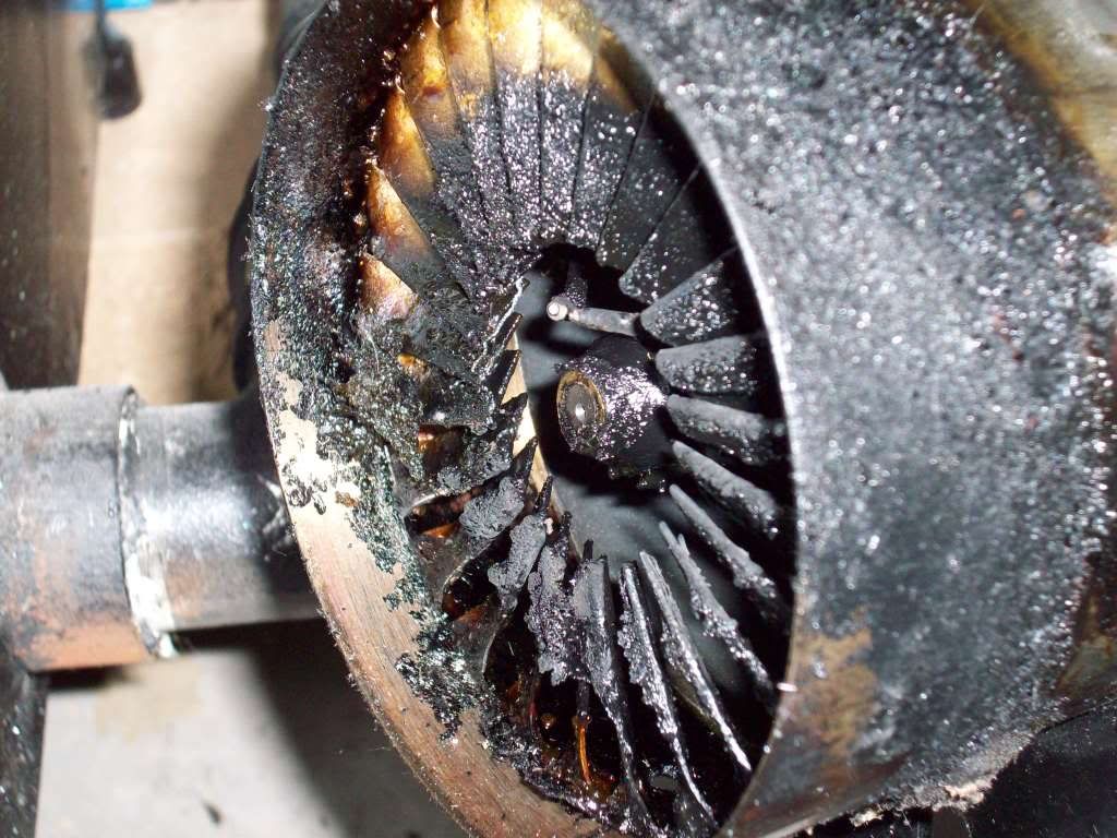

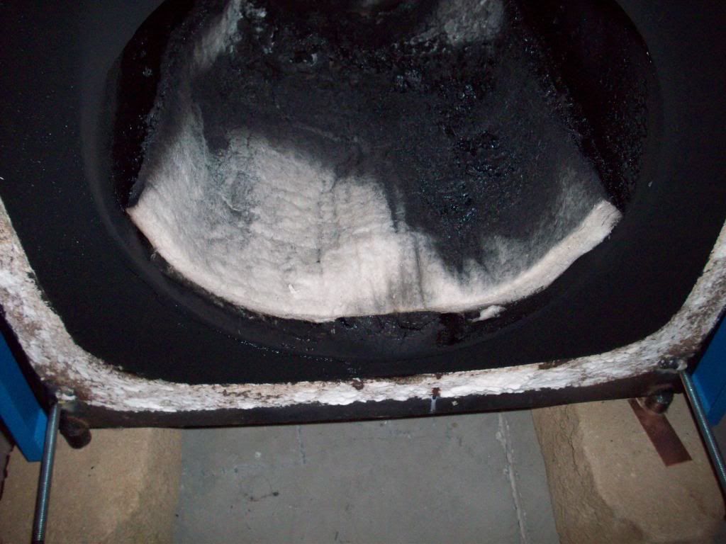

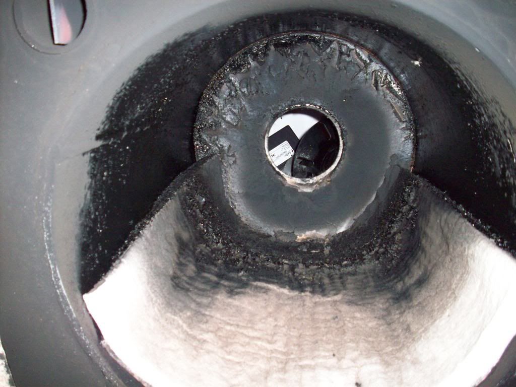

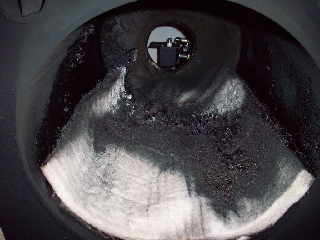

The inside view
Here are a couple of pics of the inside of the boiler. The retention head was all gunked up, and there is oil on the floor of the chamber under the burner. The manufacturer says that this is normal for an veg oil burner, but I have no clue. I burned the crud off of the retention head, and am not sure if I should leave the stuff under the burner. Any ideas?[IMG]

There is one 100 micon filter as supplied by the burner manufacturer. I clean the oil with a WVO Designs centrifuge and settling first. I am experincing a lot of shut downs now, so I assume that is the reason for the unburned oil.
running the oil pressure at approximately 2-3psi
That sounds crazy low to me... but then I have ZERO experience with WVO burners. I do see what appears to be a standard oil burner nozzle though, and I can tell you that they are spec'd at ONE HUNDRED PSI... so I wonder how this thing can atomize the fuel properly at 2-3 PSI.
How is the combustion adjusted in these things? Is there an air adjustment? other than the compressed air that is being provided that is... in other words, how does one arrive at proper combustion numbers? what gets adjusted?
One thing that you should know... that ceramic 'blanket' in the bottom of the combustion chamber... please do NOT breathe any of the 'dust' that comes off that material. ALWAYS wear a NIOSH approved respirator... the fibers that come off that after it has been fired are classified as possible human carcinogen in some states... and probably should be in all states...

Thanks Trooper, I am very careful with that stuff... I call it cancerwool. My small propane forge is lined with it, and I wear a respirator every time I fire it. I plan to reline the forge with castable when I can afford it.
The burner has an air regulator band as well as a regulator for compressed air and oil. Kagi suggests that PSI (2-3) for the oil delivery pressure, and 12 psi for the compressed air pressure.
The nozzle is a Delavan 30609-7... Patriot Supply - 30609-7
You have many good questions. I don't have any good answers. The air regulator band is still at the setting done by the installer (approx 1/2" opening, as suggested by the manufacturer)

Ohhhh... that nozzle is NOTHING like a standard OB nozzle! ESPECIALLY the price... yikes. It looks like a coaxial design, I'm guessing that the air goes down the middle and the oil comes in around it. I know that it's foolish to try and disassemble standard nozzles for cleaning, but wonder if it's an option for these? If your oil is that clean, and 0" of vacuum on the gauge, I would like to think that it's not clogged.
Has Kagi been ANY help at all? I'm thinking you should show them the pics and see what they have to say.

I sent the photos to AgSolutions. They said that some buildup is normal with WVO, and once I get it dialed for regular fail free operation that build up will be minimized. I will send the pics to Kagi tomorrow.

I have one of these beasties burning wvo. To start with, how big is your chamber?
At 18" deep I run a -2 nozzle. The pics look like you are overfiring. I made some
simple mods to this unit and it now runs for a couple weeks before needing to be
cleaned. Anthony at Ag & Tonys jr & sr at Kagi were very patient and tried hard to
help, but I had to really dig in myself in order to get any sort of reliability with wvo.

Kaowool alternatives
I shut the boiler down to change out the controller and check on the condition of the combustion chamber. The retention head and nozzle are clean now, considering the length of time that the boiler was running, (when compared to my earlier pics). The condition of the C-wool on the bottom of the chamber doesn't look so good. The crud built up has caused the kaowool to lift and pull away from the bottom. I am not sure if I should try to clean it or replace it. I am taking steps to reduce the build up in the future. Are there any less scary alternatives to Kaowool?
