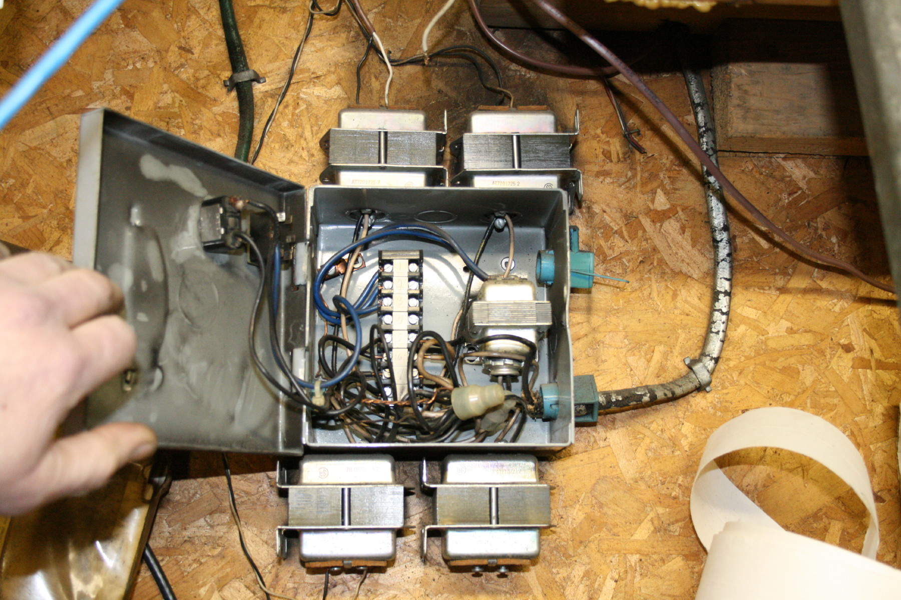

Here's the box with the transformers.

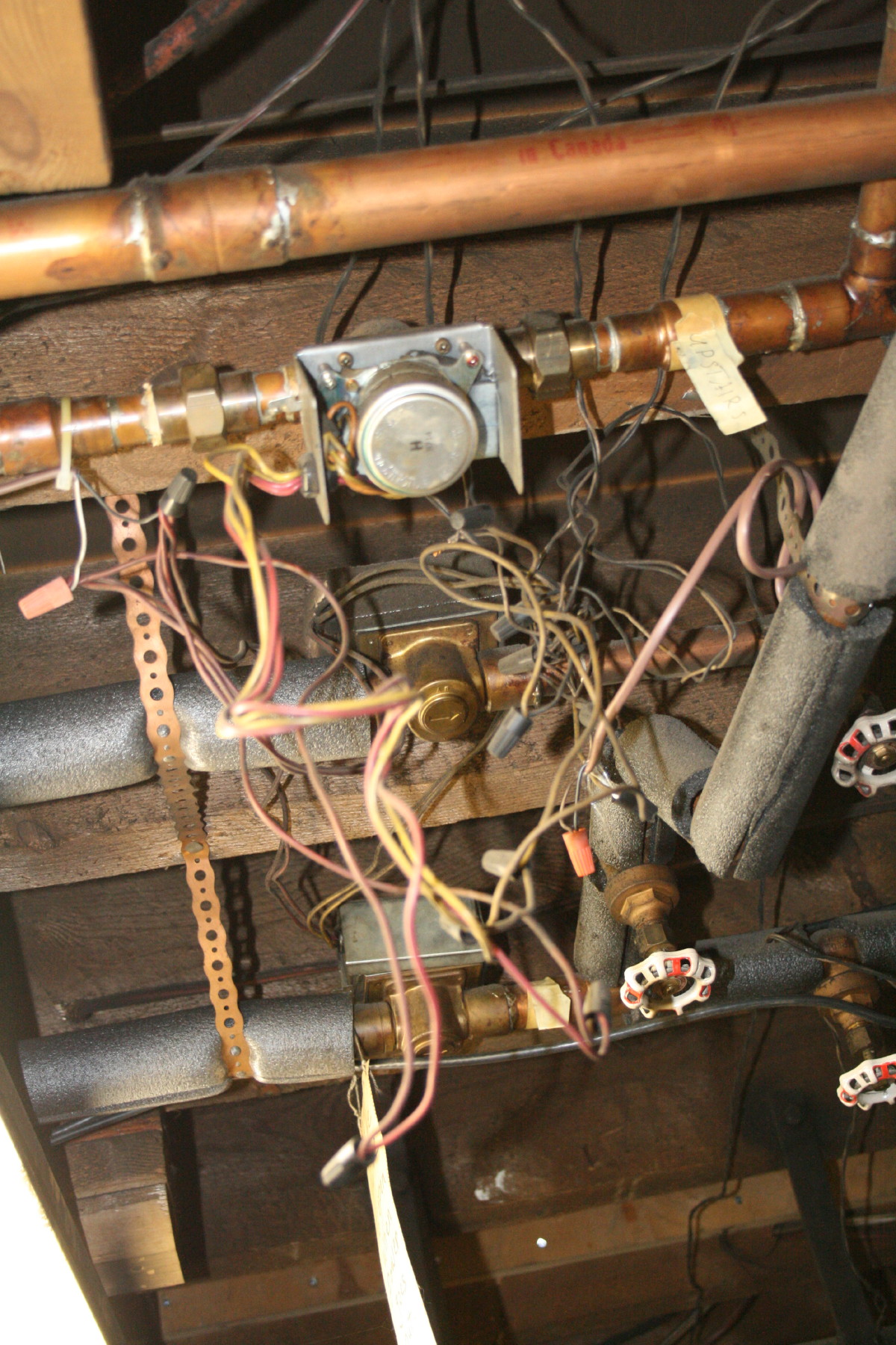

And just for the sake of showing how sloppy the wiring is, are are the zone valves...
I'm very handy at pretty much anything, and can do everything myself; I just need some instruction at this point. The wiring mess has always bothered me, and now seems like a good time to clean that up while fixing the noise issue.

A little more information. A search of the transformers' part number reveals that each one is a 40va unit(24V output).
It also appears the transformer inside the box is connected to nothing at all, and seems to have run to the previous water heater(an oil fired unit that's no longer here). The bottom right transformer is also not doing anything, and is marked as "spare", yet it, too is powered.
To be fair to the installer, his wiring is indeed nice and tidy, up until his reaches the existing wiring; it's the old wiring that is very rough and sloppy, but he simply tied into the mess and made it work, instead of stripping away everything and re-wiring the whole of it. A lot of old, obsolete "stuff" was left behind, some still connected. some just cut off and left in place. I guess I'll begin by removing all the obsolete 'stuff' and maybe try the spare transformer in place of the upper right one where I see the blackening. that's also the main floor zone, and the one that sees the most demand, so it would make sense that if one is failing, that would be the one.

Got her beat! It was indeed the transformer inside the box that was the noise maker! Took all of 5 minutes to properly remove and disconnect it, and when I flipped the breaker back-on... silence! I had to try really hard to hear the soft hum of the other 4 transformers. the basement was asking for heat, so I'll let it cycle, then shut it down and disconnect the 'spare' one, too. It's making heat, therefor, it's also using electricity for nothing...
I guess that noisy one had failed completely, but since it wasn't powering anything(grrr!), we didn't 'see' any problem. But what a racket it was making!

I see some blackening above the upper right transformer; that can't be good!
Check the temp on that transformer after the zone has been calling for a while...

Good idea to check if it gets hot under load; it didn't.
The blackening is soot, which the furnace room has plenty of, from 20+ years of wood burning. I guess that they previous owner 'blew' the walls to clean them but missed this spot. Or perhaps the heat from the fried internal transformer created a chimney that carried some of the soot left behind the box, upward. But for sure, it's not charring.
