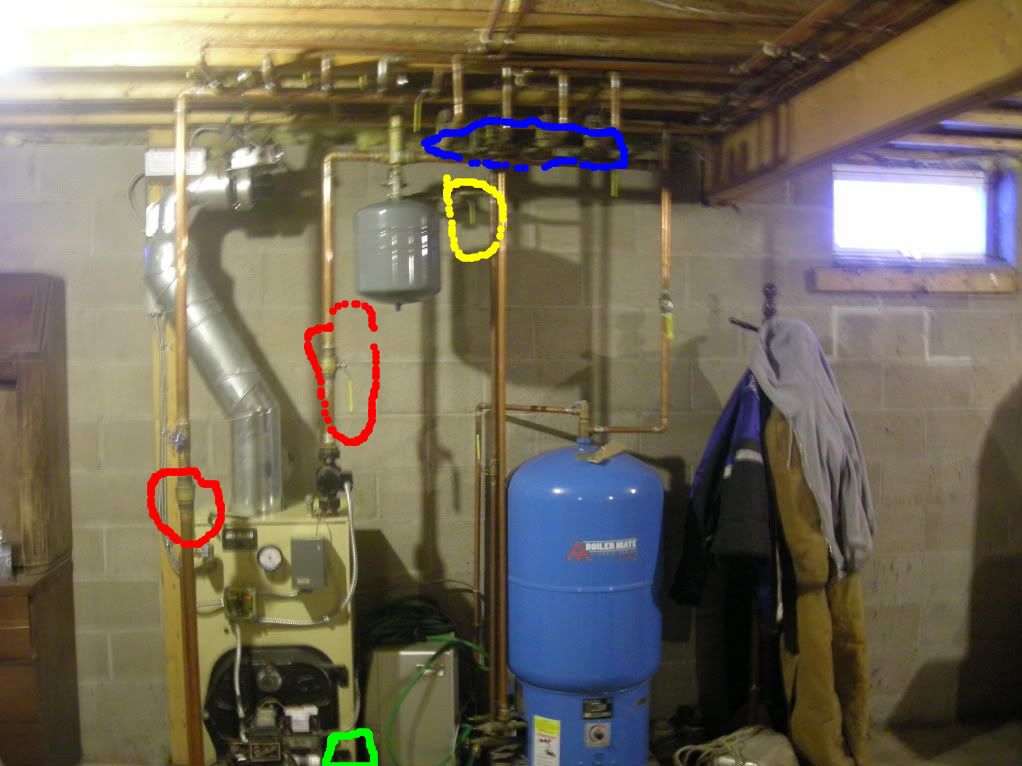

I am going to replace the leaky pressure relief valve this weekend and want to get it right.
The pic is a bit fuzzy but:
1) Cool boiler
2) I shut off the lever circled in yellow, this the valve where you add the water very fuzzy).
3) To change the relief valve I would have to shut the valves circled in red and let the water out at the valve circled in green to zero and replace the valve.
4) Then re pressure the system to 12 to 15 cold
If I wanted to check the air in the air tank I am assuming I would shut the zone valves after the tank circled in blue (very fuzzy and hard to see) and leave the right hand red circled valve open. This would include the air tank in the isolated zone.
With the pressure at 0 pressurize to 12 psi.
Another question is how much water will come out to get the pressure to 0
Sounds pretty straight forward and I did a search so I think I got it.

Yes all you say is correct. Close off valves to boiler mate if their there.
I would say about a gallon of water or so to get 0 psi. I would also change the airvent (little can above exp. tank) while your at it.
Also when you fill the boiler make sure the auto fill valve fills boiler to 12 psi. This is what they are preset to.

Dropping the pressure in the boiler to zero will allow you to change the relief without water coming out UNDER PRESSURE, but you may still have some flow out by gravity... the water above the level of the relief valve may want to flow a bit... but with the two red valves closed you might get lucky and none will flow. In any case, be prepared to work quickly when you take the old valve off... have the new one ready to go within reach... and please, don't freak out with the teflon tape! TWO WRAPS is more than enough, and keep any tape or pipe dope off the first two threads of the valve. You want those first two threads METAL TO METAL.
I'm betting way less than a gallon... wouldn't surprise me if it's less than a quart!
As for the tank charging, you can actually do this with the zones open/closed, don't matter... as long as the pressure at the tank water side is at zero.
Here's the thing... if the air charge in the tank IS very low, there will be water in the tank. When you add air, you will push some, but not all of that water out. When that water pushes out into the system, the pressure in the system may rise. So, after the first dose of 12 PSI air in the tank, check the boiler gauge and drain a little more water if needed to drop the boiler back to zero. Then recheck the tank. Repeat until the boiler gauge stays at zero, and the tank stays at 12.
If you get any water out of the air valve, replace the tank.

The thing above the expansion tank says spirovent, micro bubble resorber. Do they go bad?? I am pretty sure I heard air come out of it when I flicked the relief valve. Changing that looks a little more into it than I want to go, especially if it is not bad. Don't know if I could get it off with out cutting and sweating some pipe. Pipe is threaded in on both sides.
Thanks I thought I had it right, but it's nice to know for sure.

Yeah, I thought it looked like a Spiro... I'm sure it's OK. The top does unscrew on those if needed to clean them out, but don't fix it if it ain't broke.
Is there something between the tank and the Spiro? A valve perhaps?

One more thing I wanted to mention... because I know you are going to ask at some point...
When your boiler starts up, and the pump runs, I would expect that you will see the pressure gauge on the boiler drop, perhaps as many as 5 PSI. Not to worry about that, it's because of the pump position in relation to the expansion tank.

Nope, just a T to the valve where you add water. I do lose 5 psi or so when the Pump is on. I have researched pumping away. As far as the air tank the Plumber said he had to blip the schrader a few times because it was leaking bit. I check it and it is still holding fine, but I thought I would take the time to change it when I had the pressure down

Well I changed the Pressure relief valve and the schrader tonight, it took more time for the boiler to heat up after than it did to change both . All went smooth, it was less than a quart that came out to go to 0 pressure. Filled the pressure tank to 12 and when I opened up the auto fill valve the pressure went right up to 12 an stopped. There was a little seepage (very little like a few drops) from the relief valve when I checked after the boiler was up to temp, but that was it. 3 hours later all is still dry so we will see if this fixes it. All I have left to do is to re sweat and reinstall the copper drain pipe from the valve
My cap is plastic but it does have an O ring seal on it.

All I have left to do is to re sweat and reinstall the copper drain pipe from the valve.
Do yourself (and the next guy who has to change the safety valve) a favor and install a union so that you don't need to unsolder the piping to change the safety valve. You should change the safety valve every five years just as a matter of preventive maintenance.
