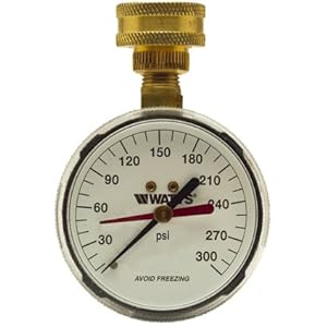

Is the gauge something pretty simple that I could do? My skill level is such that after watching someone change the regulator, pressure release and expansion tank, I could do it without a problem.

Cantona, you can easily fashion a gauge with hose thread fittings that you can screw onto any boiler drain and verify the pressure. Here's a pic of one that I use made with junk from the garage.
An old washin machine hose and a few fittings...
If you don't have a junk box, you can purchase an adapter at HD or Lowes that will let you fit a gauge to a drain valve. They won't have an appropriate gauge on the shelf though... you need a 0-30 or 0-50 PSI job, and this you can pick up at a real plumbing supply, or a swimming pool supply...
You could start with this also, about $10 or so... found in the lawn sprinkler section usually... and remove the useless for our purpose 300 PSI gauge and replace with an appropriate one:
image courtesy amazon.com

what was the gauge made of? gold? $60 seems a whole lot for a gauge. real quick i just saw one for $40 online, which is still a little high. where are you located? my truck is in the shop, but if i had it here i would just give you one

All the advice given so far is to change that pressure and temp gauge. Once you do that then you willknow what controls may need repair for proper operation.
So from what you are saying is with pressure off the boiler you still read 8-10 psi. So your 25 psi reading may be off by 8-10psi. So that may mean you are at 17 psi. Sound normal but again I would not go by that.
The temp is the concern also. You did say its staying at max 180? But that may be wrong also. Sometimes you can get a idea by touching the piping at the boiler. You should not be able to touch it for a mere moment. If you do it all the time you kind of get used to what 180 feels like and when its in the 200 plus range its instant, get your hand off the pipe type thing.
For $60 bucks I would have bought the gauge. The aquastat might be good and was just set to high, and with the exp tank failure probably cause the whole issue in the first place.
