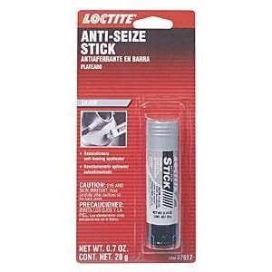

I think it's 'Loctite' that makes the anti-sieze in a very convenient 'chapstick' type tube. I'll never go back to the can and brush...
image courtesy amazon.com
hmmmm... whatever happened to the rule, I before E except after C ?
Oh, one more unrelated point. Do NOT use this stuff on wheel lugs on your car/truck! and please don't ask how I know!
