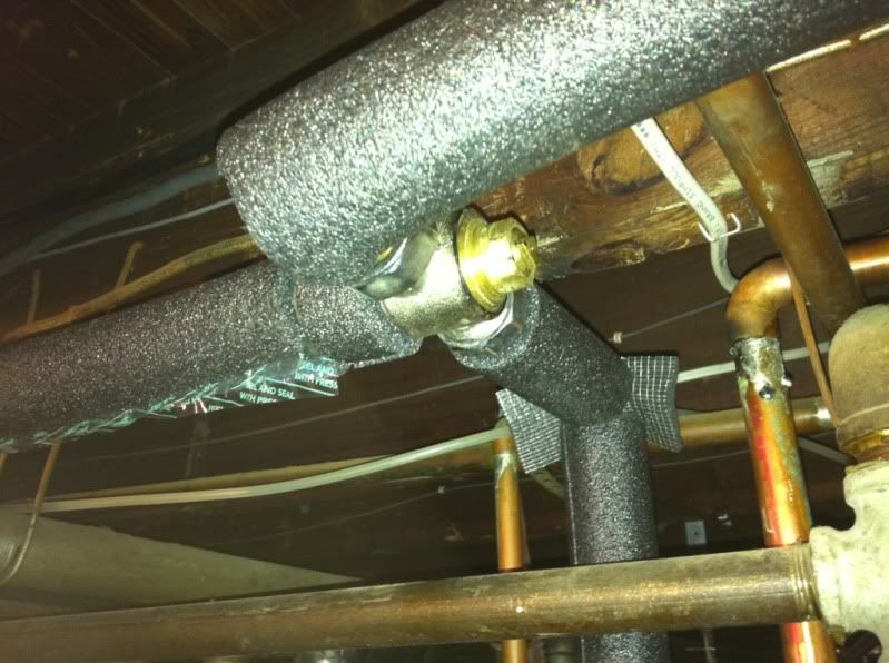

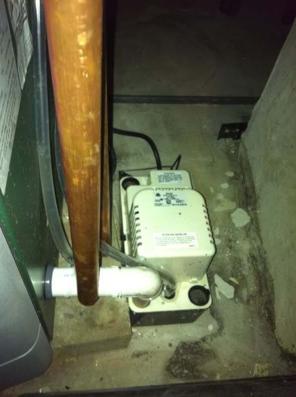

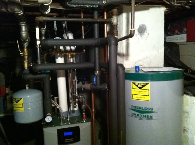

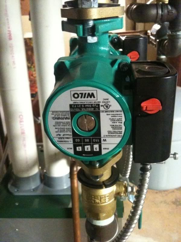

Hi neighbor! Thanks for the late night reply.
A few pics I had on my phone are below. Pretty sure they did a good job. They put in an outdoor reset, temperature modulating valve on the indirect, backflow preventer on the fill line, etc.
Note that some of these are from before the unit is even fully installed... I'll take and post some more as soon as I can. Thanks!
Not that we will nit pick it
Sadly for me, good for you, I don't see anything I can nitpick either...
If you do take more pics, stand back a bit and get some wider angles.

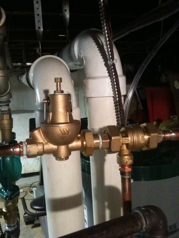

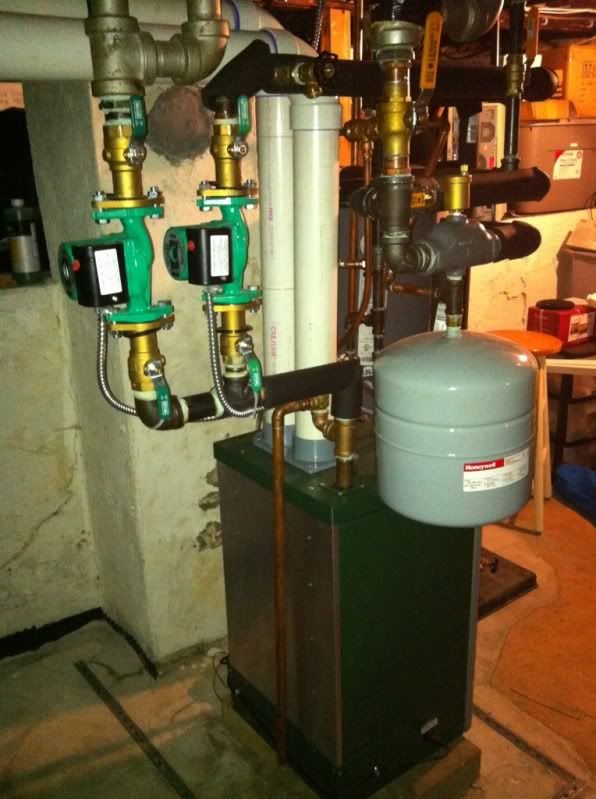

I took some more phone pics... Did the best I could, our basement is a mess right now...
Still would love to know if there are pictures or a pictoral DIY of how to do the cleaning with the chemical agent mentioned in the OM.
