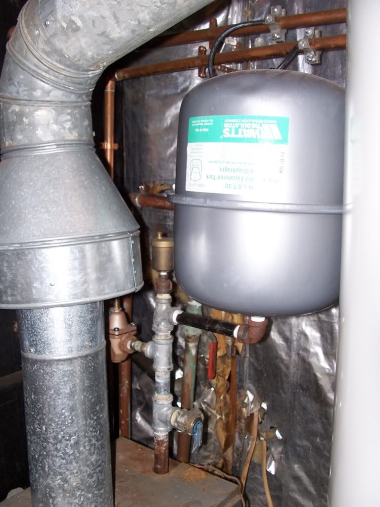

I am a firm believer that a micro-bubbler like the spirovent is more important at lower water temps due to cooler water being harder to get the air out.
Remove the loop with the air vent. Just another place to suck air in if pressure drops. The spirovent is all you need.
I would probably consider a single zone instead of two zones since the second floor zone is so small. Then just balance. Better chance of modulation and consistently lower water temps allowed.

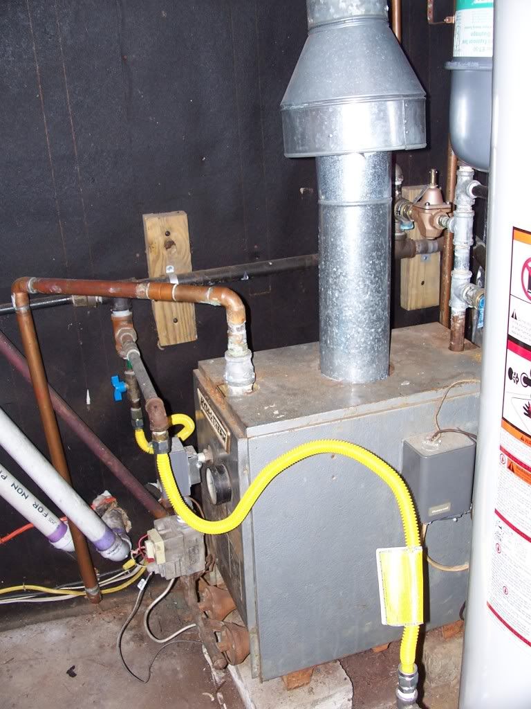

I see some galvanized pipe and fittings in you natural gas piping. Some areas do not allow galvanized, only black pipe. I think the concern is the sulfur concentration of the gas. And, I think galvanizing may be more likely to flake off in plug orfices, etc.
#77
I will be 6ft under before i worry about flakes.
