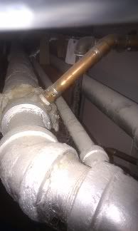

Rude, it sounds like your system may be ummmm... less than 'up to code'... 1/2" pipe from a relief valve going to an unknown location somewhere on the other side of a wall is kinda 'flaky'... I'm betting, guessing that your relief valve may not be an ASME rated part... and 1/2" pipe isn't large enough.
Can you take pictures? Set up a free account at Image hosting, free photo sharing & video sharing at Photobucket and upload your pics there. Come back here and place a link to your PUBLIC album for us to view.

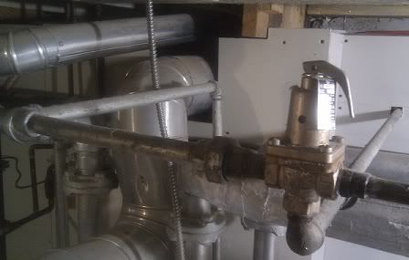

Upon closer inspection, I think the pipe goes from relief valve to floor drain, and just travels inside of the wall framing for a bit. And it looks like 1" pipe (at least 3/4") and not 1/2". Here's a couple of pics, let me know what you think. Thanks.

That is not your pressure relief valve. That would be your pressure reducing valve/auto fill valve. That auto fills your system to a preset pressure and does not allow the city's pressure to make it higher.

I see. I saw relief valve (30 lbs) written on there and figured that was what it was. I'll take another look.

I believe that's a combination unit... but I can't recall seeing one like that... usually the 'combos' are two separate devices.
Your pic is rather small, but I see two 'settings', one 12 PSI, the other 30 PSI.
In any case though, that wouldn't be up to modern codes. All modern boilers have a relief valve mounted right on the boiler itself, and it is rated to pass the full flow of a catastrophic failure. Your valve might not be able to do that. That's why they changed the codes.
Most jurisdictions now require a backflow preventer in addition... like this:
image courtesy ccallis.com
This prevents boiler water from getting into the domestic supply.
Is there another relief valve on the boiler itself?

I checked the boiler for an on-board relief valve but couldn't find one (I think the boiler is original to the house which was built in 1925)...definitely not up to code. The only other thing of note is a 2" copper pipe tied into one of the outlet lines near the boiler itself, but I'm not sure what it does or where it goes (I know I know...more sketchy plumbing).
