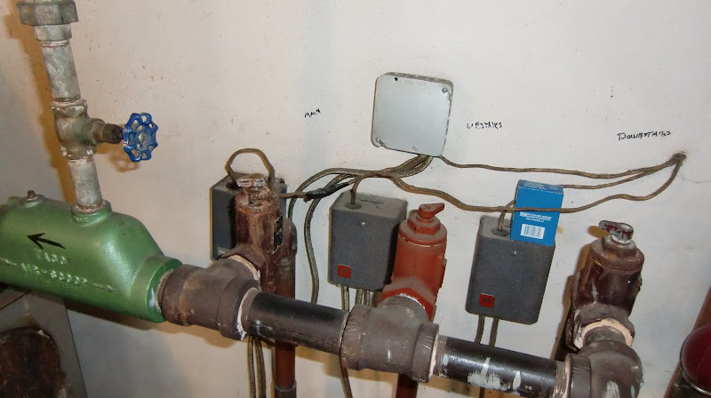

I couldn't figure out how to insert the pics in my post, but here is a link to my picasaweb. You should be able to see some pictures of my setup. Thanks for looking.
https://picasaweb.google.com/1005156...eat=directlink
Old 10-22-11, 10:21 PM
lawrosa's Avatar
Super Moderator
Join Date: Dec 2010
Posts: 18,014
Received 41 Votes on 36 Posts
You have issues. I am 99% sure. ( Just incase I am wrong I left 1%)
The proper flow of the air scoop is the direction the factory arrow is pointing. And that arrow is correct. Erase that arrow that was marked with marker ASAP. That is wrong.
Next, and I am pretty sure those pumps are upside down. They should be pumping towards the boiler.
Check the arrows on the pump impeller housing. The should all be pointing UP!!!
The "flow controls" are backwards also. Should be pointing toward the wall.
This is your whole issue why the house is not getting warm. The feed is at the top of the boiler and the return at the bottom and someone reversed the flow.
Check all arrows and let us know.
If I am correct:
Turn the flanges ( Impeller housing) around on all pumps if this is the case. Then the motors will need to be rotated 180 degrees so they are oriented as they are know.
Turn all flow controls around. The arrows should be pointing to the wall.
After further looks at the pics I would say I am 100% sure. I retract my 99% statement from my first sentence.
Also "dont " call the company who is listed on all those tags hanging from the expansion tank......
Mike NJ

It appears that the flow is reversed through the boiler. The supply water should come out of the top tapping and return into the bottom tapping. I find it a bit odd the way they piped those flow control valves. They could have just entered the bottom tapping instead of using in elbow into the back.
I installed a B&G flow control valve just like yours on my system. I put it on the return side of the boiler. I had to remove it from that location because there wasn't enough pressure on the return to lift the check. It greatly reduced the flow in my system. I wonder if that is the problem you are having with your house not getting very warm.

It looks to me like the pumps are pumping in the correct direction, toward the bottom of the boiler. The discharge comes out the side of the volute of a centrifugal pump - the suction goes to the center of the volute.

Bob, how long has this been running like this?

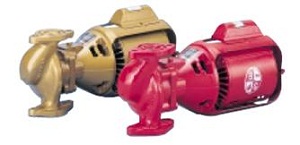

The circulators are pumping down.
How do you know? Let's see a pic of the other end of the pumps.
In this picture, the pumps are pictured with the flow DOWN, you can tell by looking at the volute... the water enters the center of the impeller and is centrifugally thrown outward to the outside of the pump housing.
image couretsy deppmann.com
I find it incomprehensible how this could have been installed and run in this fashion since it was installed back in the mid-late 50's... and not one person ever noticed it. That's why I'm questioning this assumption.
I have no doubt that if the flow were made proper, IF it is in fact reversed, your heating costs would be less. The boiler simply isn't designed for reverse flow. Pumping cool water in the top ... it just is not thermodynamically designed for that! I think you would hear all kinds of ugly noises coming out of that boiler as the water 'percolated' inside... the fire at the bottom of the boiler is designed to get progressively hotter as it is pumped in cooler at the bottom and hot out the top.
I'll tell ya though... that boiler itself is pretty long in the tooth... ya know I'm thinking that given what you have to do to reverse the flow, IF you have to do so, and the age of the boiler, your best advice at this point might be to replace the whole mess.
That blocking plate on the boiler has been leaking for a LONG time!

This is an older photo -- it's hard to see, but the arrow does point down. Yes, my tank is underground, and those are copper pipes going into the concrete. The system has been running for 50+ years, I guess. We bought the house 2 years ago, so that's the only history I know for sure. It doesn't make a lot of noise. I've had several people out, to do cleaning and inspections, etc. and I even had one company out to give me an estimate on a new boiler, and nobody ever told me it was set up wrong. Maybe they just didn't have the heart to tell me, or maybe there's something I'm not telling you that would clear things up. The reason I came to the forum is that the last guy estimated over $700 to change the B & G to a Taco (using my Taco) and replace the Flo-Valve. I decided to put in the Taco myself and live with the Flo-valve until and if I could do it myself.

The pumps are definitely discharging downward and into the bottom of the boiler, which is correct.
No they are not. They are pointing down and flowing into the circuit and pumping toward the feed.
To pump toward the boiler they need to point up.
Look at the pics again. That header above the pumps goes to the boiler. So the pumps need to pump towards that header an to the boiler.

Mike, I see now - you are right and I was wrong. That magic marker arrow on the air scoop does, indeed, show the actual direction of flow. The whole system is back-asswards. Unbelievable.

That system has not been running like that for too long. Those flow controls were recently refitted. You can tell by all the teflon around the joints. Fingerprints and smear marks on the pipe.
Also the impeller housings look newer and probably were replaced at the same time.
I think its all related to when someone installed that air seperator.
Now why in the work did they do this??? The world may never know.....
You are wasting fuel keeping it this way. Some of the others can chime in and let you know more about the pyshics, but it seems you have your mind set on leaving it.
IMO if I had to pay your oil bill for the winter, those parts would have been turned around already. It would probably take a half day to complete.
Thing is though... I don't believe you can turn the impeller housings over. The oil would all leak out!
I'm not sure all that white stuff is teflon tape... maybe on the center one that appears to have been replaced... it looks much newer. But wait... you aren't talking about teflon TAPE, are you? Maybe teflon DOPE is what yer thinking?
This entire system seems to me to be original 50's vintage.

Yeah... Lo0k at those nice new tees and nipples. Fresh paste IMO. Looks repiped to me when the seperator went in.
As far as the pumps, he has one taco that he replaced, so I would just replace the other two.
Mike NJ
Of course you can! You remove the "bearing bracket" by removing the four capscrews holding it to the pump body and then you may insert the pump body in the piping any way you desire. Re-install the bearing bracket with the oiling holes on top. That means you have four positions to mount the pump.
While there is no doubt that the system is running backwards as far as flow is concerned I seriously doubt that making it "right" would change any of the dynamics of the system except possibly making air elimination slightly easier. Increased fuel efficiency from changing the flow is doubtful. Since it works at least in an okay manner I see no reason to change it. As for the Teflon (or whatever) on some of the fittings...just because some fittings have been changed since originally built does NOT mean that these new fittings were not installed in the same manner as the original.
I do strongly suggest that bobkirby get some water detection paste from his oil supplier and test for water in the bottom of his tank. If there is any water then I can almost guarantee that corrosion is taking place and if not leaking now it will soon. Unless you have been tracking the fuel consumption vs. degree days for years you simply cannot know if the tank is leaking or not.
Wouldn't it make a difference? Cool water coming into the top of the boiler, and hot water coming out the bottom? Heat transfer from the burner to the water would be less, right? Stand-alone hot water heaters aren't ever designed that way. Why?
  #34
Old 10-24-11, 06:33 PM
Join Date: Mar 2006
Posts: 18,493
Received 33 Votes on 25 Posts
First of all, a domestic water heater is not a boiler BUT if used as one it really would make little difference which direction the flow was through the unit.
Secondly, while a modern boiler may be designed for a particular direction of flow that wasn't true fifty years ago. Those old boilers are basically a tank with a few tubes for heat transfer. Except for an area very near the inlet nozzle (fitting) the temperature throughout the boiler is going to be within a few degrees at most.
