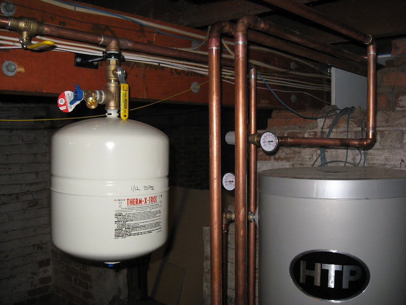

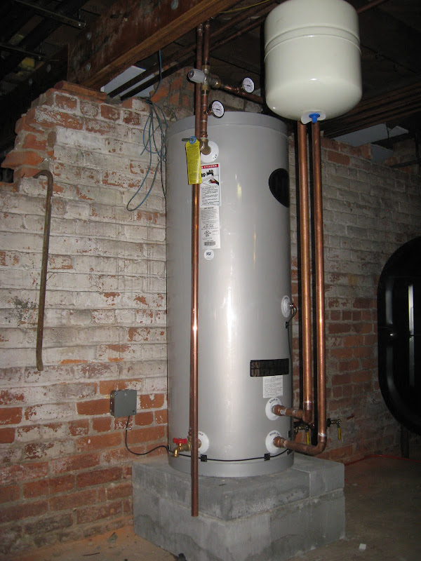

INdirect sizing
Looks like I will be replacing the indirect HW heater as well.
Possibility of 3 showers and laundry at the same time. No whirlpool tubs.
Given my 170k heating capacity, what do you guys think of the Superstor SSU-45? Will do continuous 3.95gpm with 161k.
Any advantage to oversizing the tank?
The Buderus LT-200 will do 2.42gpm continuous with 109k and holds 53 gallons. However that is also based on 209f water versus superstor at 200f. However, it holds 53 gallons.
So, smaller tank with higher continuous output, or larger tank with reduced continuous output..
Any other good tanks I should look at? I looked at the Smart 50.

supply house pointed me at a "Heat Flo" indirects. At first glance they looked to good to be true.
upon further investigation they need a 14gpm flow rate! 1" tappings on the indirect.
Decided to go with a 45g superstor.

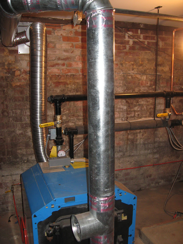

I just got the pipe insulation and some double-pole switches.
I set the boiler pumps up on a separate relay from the burners so the control can do post-purge.
Downside is when you turn the burner off, the pump will still run.
The direct vent kit was a complete fiasco, with wrong parts, un-needed parts and so on. I *knew* the direct-vent kits were a hassle, which is why I was *extremely* specific from day 1, but it still got all screwed up.
Field controls won't send out parts; you can buy the concentric termination, or the entire kit. There were parts checked off in the packing list that weren't in the box.
I don't have the second boiler in yet. I will take some update photos.

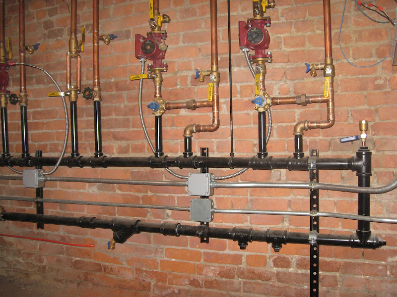

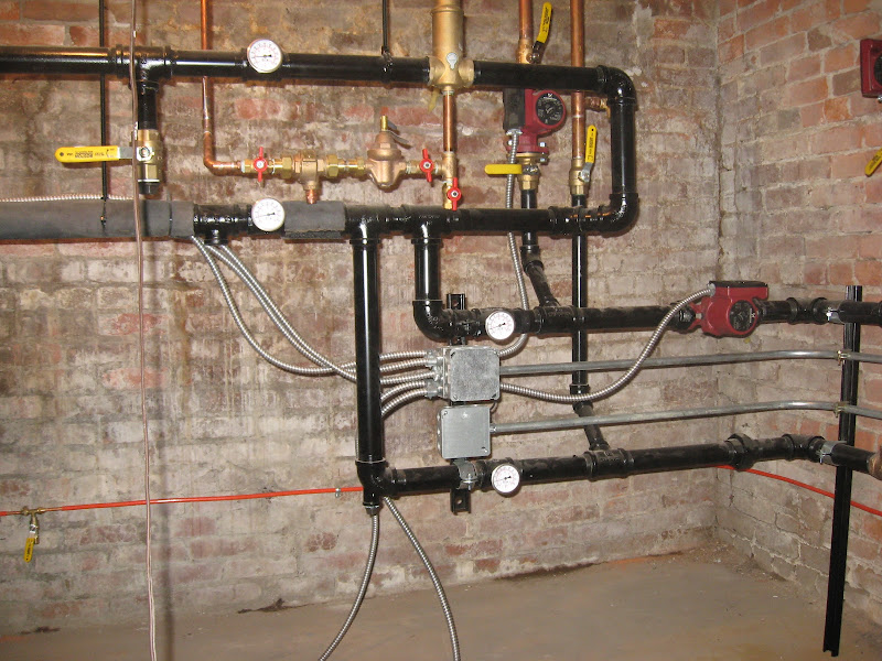

Unexpected addition to the workload:
Direct Vent from hell (and my handy brickwork)
There's a lot of freakin wires
More Electric (top boxes are line voltage, bottom boxes are sensor wiring)
Command Central
I'm reusing the Honeywell relays I have.. so that's what the 4 offsets are for. Installed a CO alarm. 5 switches to turn off the 4 zone circs and the DHW pump for servicing.
