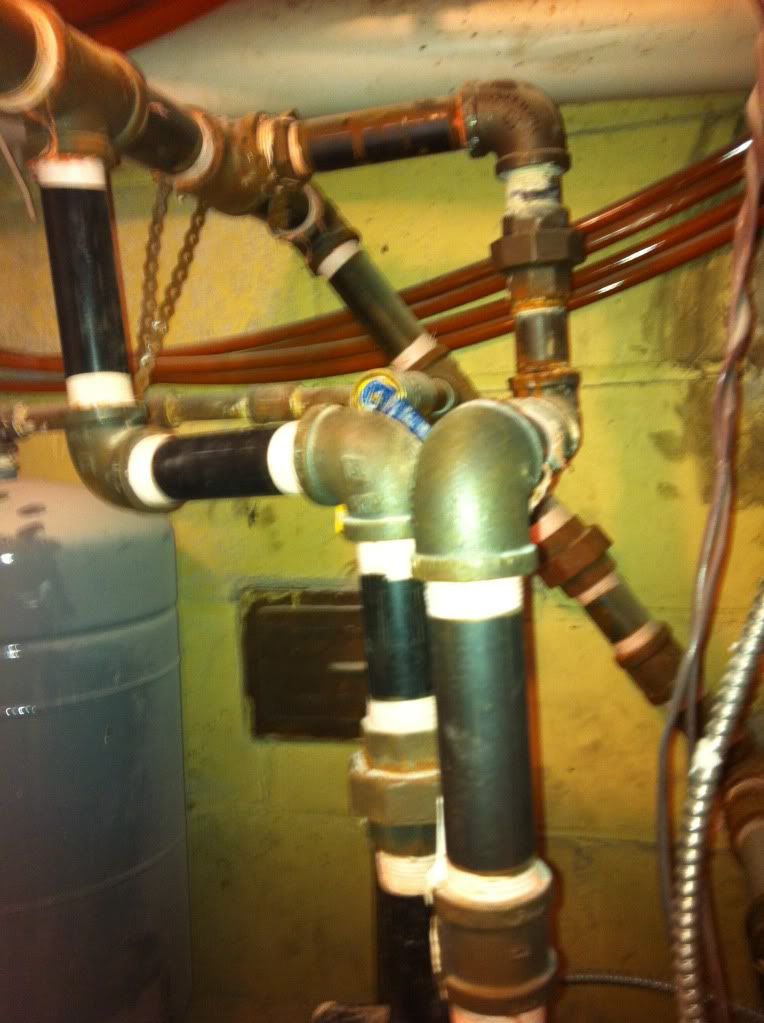

hey all,
I have had a slant fin b200 natural gas boiler for aboutr a year plumbed with a 2 pipe primary/secondary scheme. I have recently run into some problems. It started with 2 radiators not heating. Those radiators are fed from a branch that feeds 7 raditaors (4 of which have no flow control valve). The branch is fed from a 3/4 pex tube that come from a manifold. Each port of the manifold produces 2gpm max. I figured that the 2 gpm simply could not feed 7 cast iron radiators. I had a friend (mechanical engineer) come in and he added t-fittings to the feed and return line and connected the 3/4 pex that feeds the afformentioned branch to them. This seems to have worked as now all the radiators in the house come on and are fairly well balanced.
A new problem has now developed. When the boiler runs it will not get past 140f unless I restrict return flow to the boiler. I am assuming the problem is that too many gpm are flowing through the boiler and not allowing the boiler to heat the water. At the same time the return water temperature is higher than it should be. With a supply temperature of 140 the return temperature will be ~135. This is not good because it is pushing the boiler out of condensing mode. I am assuming the problem is the primary/secondary plumbing. When I restrict the secondary (return) the primary pushes more water down into the secondary/return basically pushing just heated water into the boiler's return. I am wondering if I should just remoed the primary/secondary system?
What I did notice is that slant-fin mandates the use of a Taco 0011 circulator pump on the return side. The installer, however, used a taco 1400-45 pump which flows 25gpm more. I am wondering if my system is just over pumped....There are two pumps, return pump is the 1400-45, supply side pump is a taco 0010.
any insight is appreciated!

Hello,
What happens if you turn down the temperature setting for the boiler?
Certainly, the more flow the lower the delta T betwee the inlet and outlet.
There is a table 2b, for indirect heaters on page 26 that show various DeltaT's for different flow rates.
The 1400-45 is in the table, and it might too much pump, but it depends on the head loss.
It's for indirects but gives an idea.

hi, thanks for reply.
I made a mistake. The Taco 0011 was for the smalle b120 boiler, I have the b200. Here is what the manual says "0013 for B-200A" So I need the 0013 not the 0011....the difference is 2gpm so 33 not 31 which is still a lot less thatn the 0014's 55.
It says it came with it but mine did not, unless the installers kept it and gave me a 0014 thinking I need more flow. I can only assume they mandate the 0013 because they want a certain amount of pressure/flow through the heat exchanger.
I should note this. I partially closed the new 3/4 loop I had installed. With it about 80% closed the boiler went from 140 to 165 degrees. That, however, is internal temp...the manifold read ~140 on the feed and ~110 on return. The problem is that the boiler's return reads ~134. Seems to me that the primary/secondary is allowing hot water to affect return temps.

Well it turns out I have the proper pump. It is a 0013 and the supply circulator is the 0010. I am wondering if maybe the 2 pumps just make too much flow for the boiler. I believe the 0013 has 31 head-feet and 35 gpm and the 0010 is not far off of that. With that much feet-head and ~60gpm it seems like quite a heavy flowing system.
I have another question. The boiler came with an outdoor sensor for outside reset control or as slant-fin calls it, weather compensation. I have set it up and it works quite nicely. There are two control options for this. You can either control the boiler just with the outside sensor or you can select outside sensor and thermostat.

Apparently the installers did not install the boiler to the exact specs in the manual. The diagram in the manual indicates that there should be an isolation valve above the pump between the pump and the closely spaced T's, and there should be a flow check valve between the pump and the boiler. Neither of these are plumbed in.
I must admit that I don't know how these things will help. I am assuming that the isolation valve just lets you close down the entire return (maybe even the whole supply and return since they are connected), and the flow check valve limits regulates the amount of flow through the boiler. Is this correct?
I may just swap the pump out for the taco 0013-f4-1ifc which has an internal flow check valve installed. I am also wonering if maybe the supply side circulator pump is too big. I read a few articles that state the old gravity systems are fairly free flowing with minimal head loss. They suggest that too big of a circulator will cause the water to skip through the radiators and the boiler. I am thinking maybe I should install a smaller circulator pump that flows less GPM...maybe even a speed-control pump.

The radiators are 2 pipe cast iron with the pipes on the same side. Some of the rads have no vales...smallers rads near doors or in washrooms. I am guessing it is because you want those areas warmer. One of the problems I originally had was 2 radiators were not working. These radiators were fed by a 4" trunk line that fed 7 other radiators. The trunk line was fed from a 2gpm 1/2 pex output from a manifold. 4 of the 7 radiators there have no valves to control flow so I figured the problem was that 2gpm was not adequate to supply 7 rads. That has been rectified.
This is my tentitive conclusion:
Before I had weak flow through the return side because the manifold was severely limiting the gpm in the return loop. This caused more primary side recirculation (just heated water flowing back to the boiler return from the closely spaced t's). This meant the boiler heated up rapidly to the full 185 set point because it was just cycling warm water. Since I rectified the radiators that were not coming on the boiler is struggling to produce 140*. I believe this is because of increased flow. The more free flowing return is not overwhelming the boiler. ie. too many gpm's flowing through the boiler not allowing the boiler to heat the water. Basically before there was too much restriction, now it is too free flowing.
I am not sure but could the system be working correctly? The point of modulating boilers is to restrict output temperatures to keep a delta-t of ~20 correct? It seems that whatever the supply side temp is the return side is between 19-25* cooler. When supply is 150 return will be ~128-131.

If piped properly piped p/s systems create what we call hydraulic separation. What this means is the flow of one pump will not affect the flow of another pump. So you thoughts of combined flow is not correct if the p/s is piped properly. Your pic's and sketch will show this.
The backward flow between the boiler tee's is a result of the flow in the boiler piping greater than the flow in the system. This can be normal or maybe not. It is normal when all is correct and the system is zoned and not all zones are open. What does not go out to the system will flow back to the boilers. When everything is not correct like piping, pump sizing, boiler sizing etc.
When boilers piped with p/s are over sized, even when all zones are open, this will happen anyway due to boiler flow requirements being higher than the system needs.

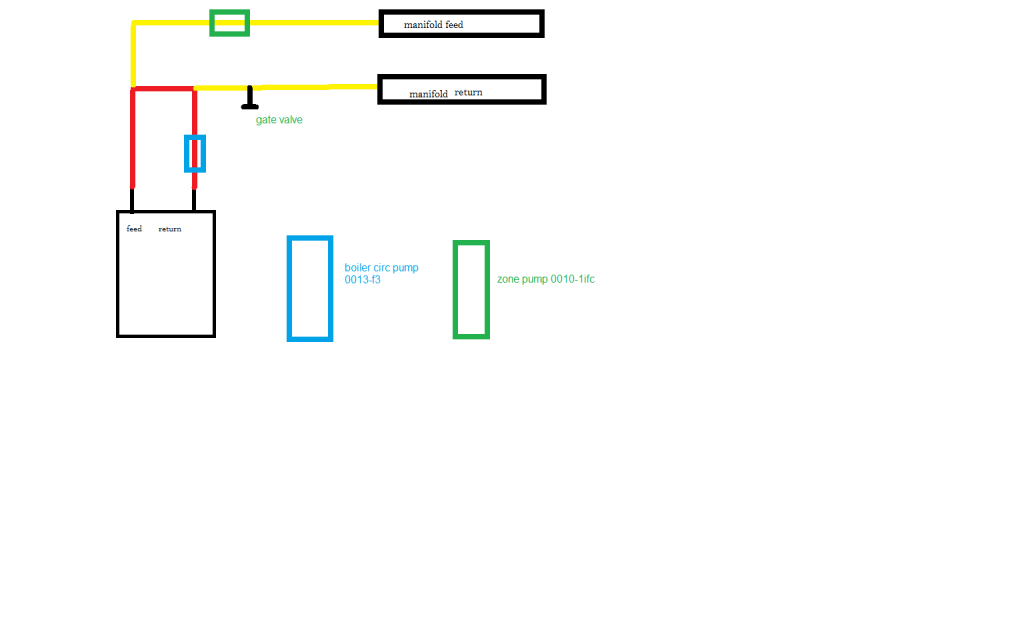

this is a sketch of the system. I did not add in the second zone or the dhw. I can make another one with those if you want. I figured this is fine to show the basic setup. From what I have bene reading I would say it is a p/s system in parallel.
here are the pics. please excuse the quality.
well I have no idea how to post pics. I tried every different way and it won't work. It just shows the [IMG]www.hhhh[/IMG] thing.
The original purpose of p/s was to speed up the heating of boiler water and to keep colder water out of the boiler because cold water causes condenstation which is harmful to non condensing boilers. The closely spaced t's allowed a mix of cold return water and hot water from the supply side to circulate through the boiler.
I am wondering if possibly the flow from the return side of the heating circuit is preventing the water from the boiler supply from circulating back into the boiler. ie. that the force of the return water is pushing the supply water and not allowing it down the closely spaced t's. This, I would argue, would prevent the boiler from heating the water as it is outmatched by the amount of cold water in the system.
that or it could jsut be a by product of modulation...the heat system is working well with the outside-reset + thermostat system. I am just nervous to see if the boiler will be able to have a higher temp when the outdoor temp falls.

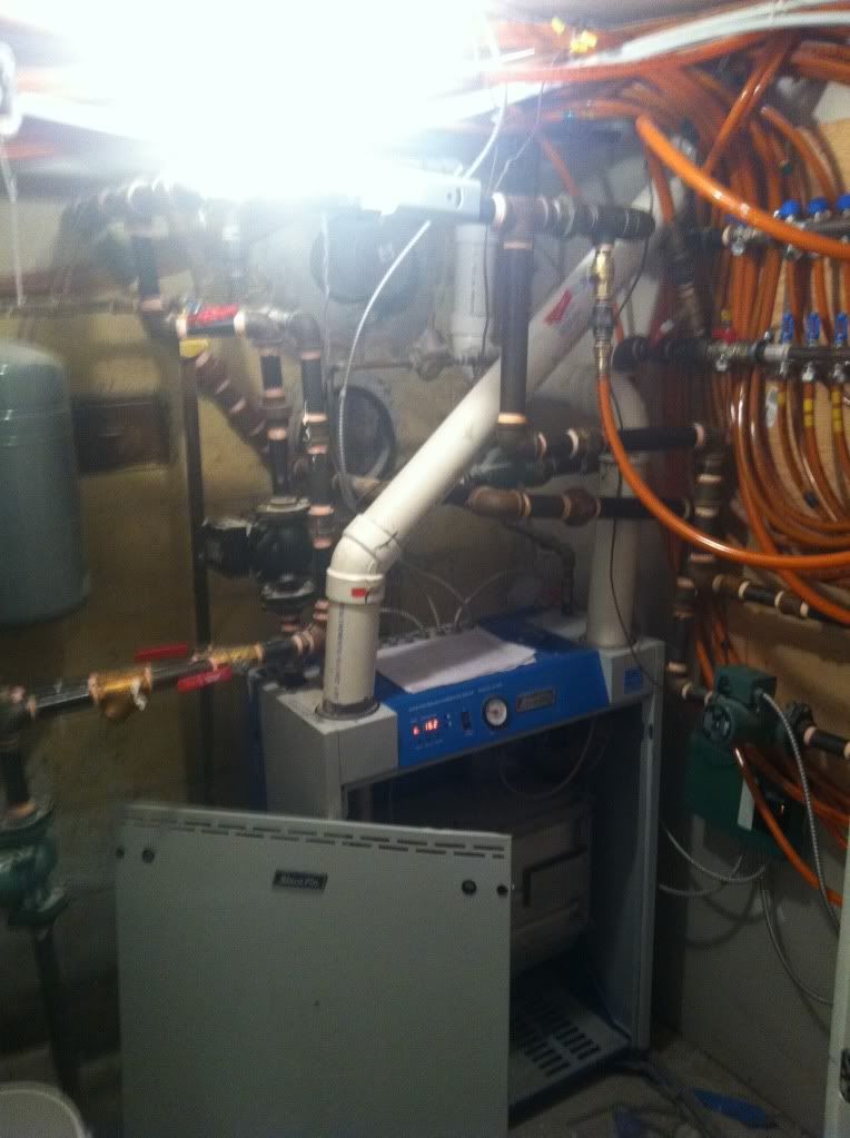

boiler pictures by 50benlamond - Photobucket
includes a diagram and several pics.

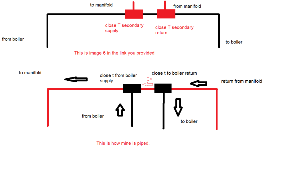

p/s creates hydraulic seperation so the flow of one pump does not affect the flow of another pump. The flow backwards between the tees is dependent on more flow required through the boiler and less flow in the system.
To achieve hydraulic seperation you need the proper distances. It looks like the tees are too far apart and the distance from the tees to the elbows are too close. If the distances are not correct you loose hydraulic seperation.
See this link for more info.
http://www.comfort-calc.net/primary-..._tutorial.html
See drawing #6
See drawing #6

What would you think about piping the manifold so the end of the feed side feeds back into the return side? That would allow non-used feed water to return through the return side allowing warmer water back into the boiler.
In pic # 20 it looks like you have a circ on the feed and one on the return. Is that correct?
I can barely see but the tees for supply and return are indeed next to each other correct?

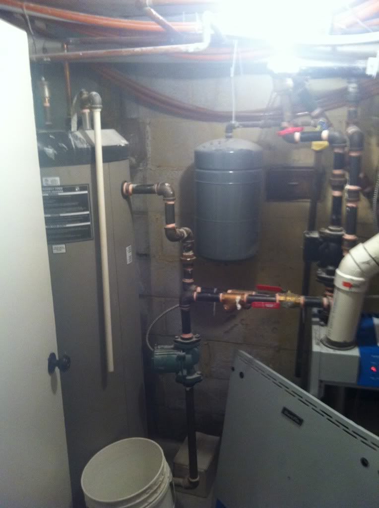

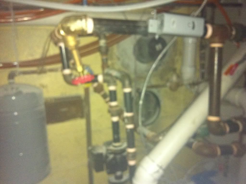

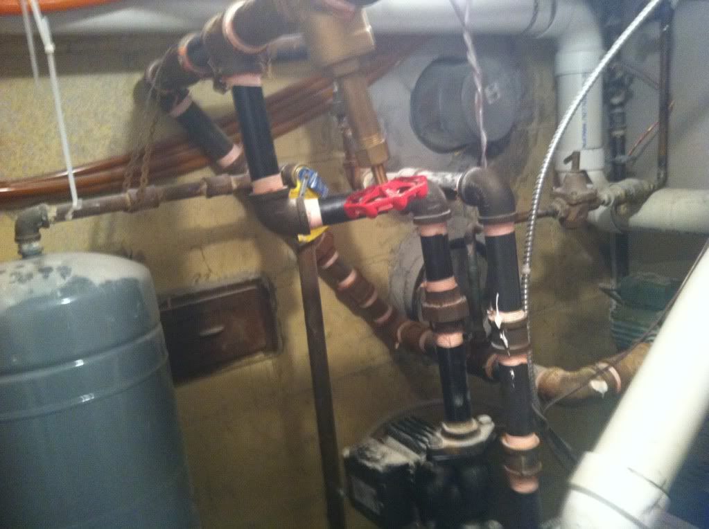

In this pic you can see the supply and return at the boiler. The line with the black pump is the return.
Here again is a view from a different angle.
In this pic you can see where the closely spaced t-fittings are. You can clearly see the closely spaced-t for the return side...If you follow the supply line you can can guess where the supply closely spaced T is. It's right around where the support strap for the expansion tank is.
Yes, there are two pumps. The one pump is the black one for the boiler return, the other pump pushes the supply water to the manifold. I would say the t-fittings are not more than a foot apart.
best pic. you can see the supply and return close T's.

Well I guess one issue is no flo control on the indirect HWH line??? I think I read that in one of your posts. The pumps dont have built in checks right? Thats just a Y strainer in line with the indirect?
I guess I will read your previous posts to update myself. I am not a pro in this area and others here have better knowledge them myself. I only point out what I seen so far.
Looks kind of messed up. Possibly you can take better pics.
The weil mclain site has good piping diagrams for thier ultra boiler. Possibly you can look over that documentation.
Mike NJ

The indirect water heater pump does have a check valve. The taco 0010-1ifc has a built in check valve. Both of the "green" pumps are the same with the internal check valves. There is no check valve on the boiler return line though.
I can try to get better pics but it's hard because it is tight in there. The boiler seems to be installed properly as per the Slant-fin manual, other than no check valve on the return side. But that would just stop water flow when the pumps are off, correct?
I am wondering if I should put a balancing valve on the heating circuit return to limit the amount of water going through that circuit.

Perhaps you could work on a fully detailed drawing of what is what and the flow directions.
Peter
It's beyond my ability see into that maze and understand what is going on and in what direction. Sorry. Others here may have more talent/experience for that, than i do. The back lighting doesn't help either.
Peter

Seems like things are confused.
First way back you wanted cooler return temps, to ensure condensing.
Now you want to by-pass the radiators, which will result in increased return temps.
The temperature of the supply water from the boiler can be 130 or 200 and the exact same amount of btu's will be delivered to the house - this is flow rate depedent.
No need to worry about how hot the water is leaving the boiler.
For example: 160,000 btu's are produced by the boiler and the heat load is 160,000
At a flow rate of 25 gallons a minute, a supply temperature of 140*will deliver 160000 btu's to a like load and the return temperature will be 125 degrees
Just because the supply is not 190 degrees does not mean the full amount of heat is not being delivered.
If anything as Mr. Beck noted, the boiler may be too big.
Was there a heat loss done for the house?
200,000 input btu's is a monster boiler, is your house huge and uninsulated?
Peter

I would want the piping as illustrated. It shows 4 check valves total.
It shows the two flow checks as you stated and you are missing one? Your zoned with circs correct?
Page 27 here.
http://www.slantfin.com/images/stori...bcat_ba_40.pdf
Page 37 shows the info on firing rate vs blower speed. Your unit only has HI/LO. You can simply clock your gas meter I believe.
I would not get nutsy with changing any default settings though. You can really mess things up if your not sure what your doing in regards to tweaking.
