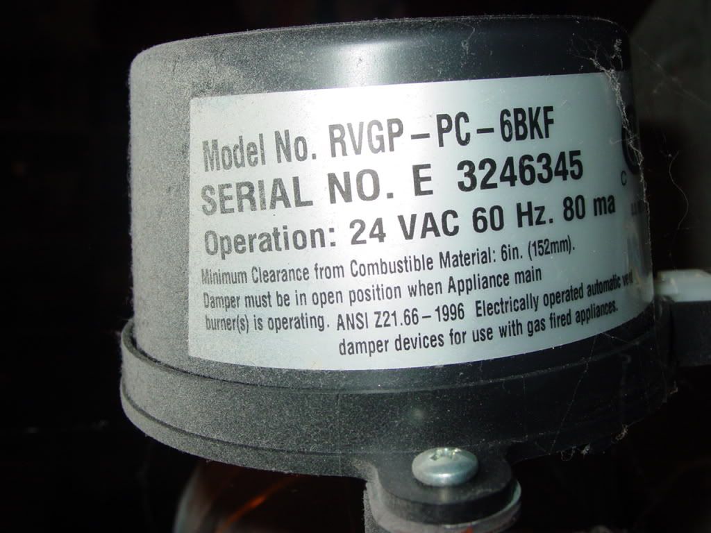

I have taken some photos, hopefully they are each worth 1000 words.
I have no limit switches to set from what I know, my old boiler did, however it was also about 80 yrs old and about as big as a small size car. From what I can tell the temp is set to 170*F for the hot water temp. When the thermostat clicks on, flame on, pump goes, chimney valve opens and radiators get warm. Everything is working great, other then the fact that the house is old, and this heat doesn't seem to keep it warm. I'd like to try keeping the pump circulation for a few minutes after the water has been heated.
