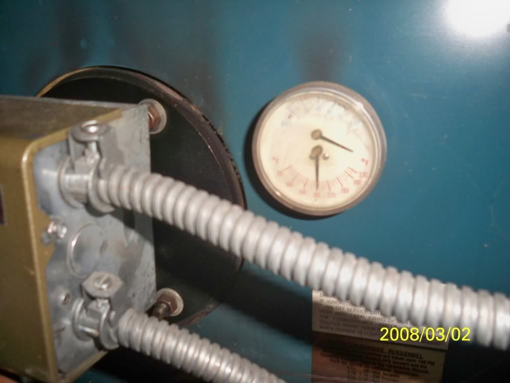

My v-7 oil fired boiler is used for hot water and heat the house. The boiler is running all day yet the house is still cold. I went downstairs to do some inspection and realized that the pressure gauge is not functioning at all. I don't know for how long the gauge's been broken. What could be the problem? Should i shut the boiler down? Is there a safety issue? Please help

Hi Maple, What leads you to the conclusion that the gauge is not functioning?
I will be the first around here to suspect a pressure gauge, everybody knows that... but is the gauge reading zero? If so, how do you know that you don't actually have zero psi in the boiler? It's possible!
Old 12-18-11, 01:50 PM
Join Date: Dec 2011
Location: usa
Posts: 7
The needle is all the way to the right

if the gauge is all the way to the right and the relief valve has not tripped and released any water, then I would say the gauge is no funtioning of course.
As far as the house being cold, you can have several issues. Not enough water possibly? A circulator or zone valve thats not working?
If you can do this today I would absolutly shut off the power to the boiler until you can get the correct pressure reading. Then we will need to take it from there. I know its cold here in the east, but if you have no heat anyway shutting it down for saftey purposes is more then resonable.

Thanks ... i just bled all the boards and it's better in here. But the needle on the gauge pressure is still all the way to the right. See attached pictures

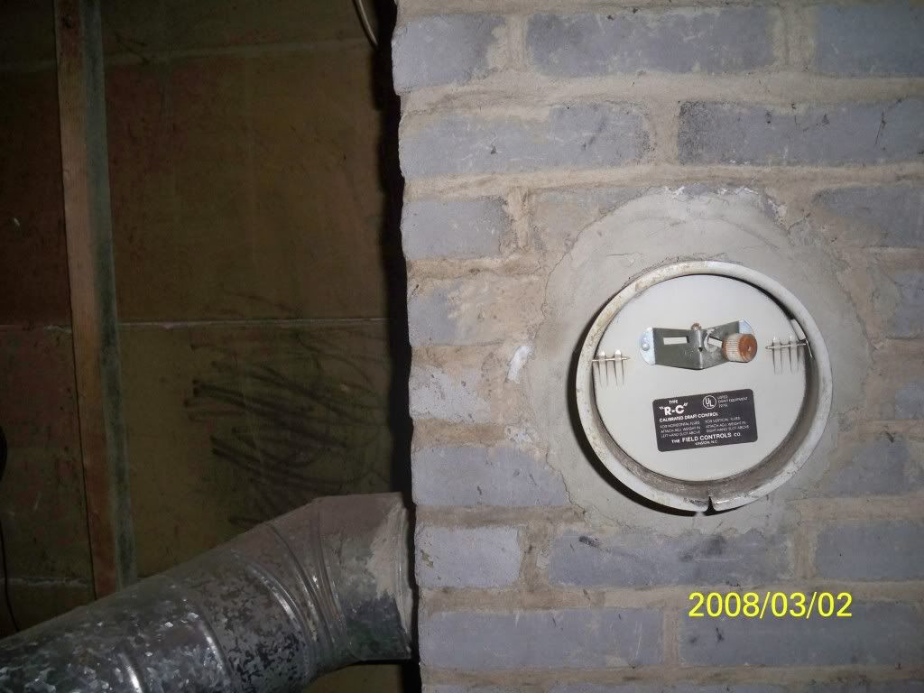

Is there a barometric damper on that flue pipe?

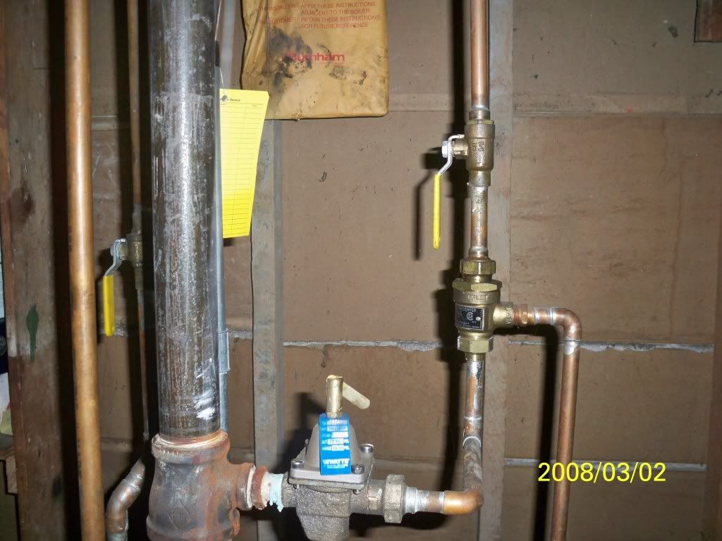

Show us a pic of the stuff above the boiler too.
Old 12-18-11, 03:40 PM
Join Date: Dec 2011
Location: usa
Posts: 7
The expansion tank is on top of the boiler.. see picture
Yes there is a damper on the flue ..see pic

You can get a gauge and hook it to that valve to the right of the burner. Hook it up and open the valve. At least it will give you some indication of the psi.
Also I have to say that I am not sure of the implications of that elbow for the flue directly coming off the boiler. I am sure there is a rule but I cant remember right now. I am sure its not a show stopper.
Now why you bled and how seems an issue. We will not know anything until we know what your pressure is.
Also do you hear the circ running on a call for heat?
And looks like the pressure gauge reads 180F? Is that working do you think?
Mike NJ

Your gauge is toast. That needs to be replaced. You can do it yourself if you are up for it, or you can do what lawrosa suggested. What you really need is a gauge with a scale much smaller than the one lawrosa posted. So you will have cobble something together using the proper gauge. with the hose bip connection on it, you can hook it to the boiler drain. Then in the warmer months, replace the gauge on the boiler.

The baseboards were cold while the boiler was running. So i bled to get the air out. Yes i can hear it. How easy is it to replace the gauge? It looks like there is a broken spring or something inside the gauge.

Good... I can't tell if the photo is crooked, or if the damper is... but those should be installed plumb and level. That horizontal should be horizontal, no big deal, just sayin'

I plugged a pressure gauge to the drain and i am reading only 10 psi

Although many draft regulators are mounted in the chimney like this shows but in reality the draft regulator is supposed to be in the pipe in the flue gas flow. With oil heat the chimney base below the pipe should be backfilled.

Your system should have a minimum of 12 psi when cold.

Too low. If you are unsure how to raise the pressure, please call for help - he can do that when he comes to replace the gauge.

If the boiler is hot 10psi is too low, mine reads around 18 or so at 170 and 12 cold.
