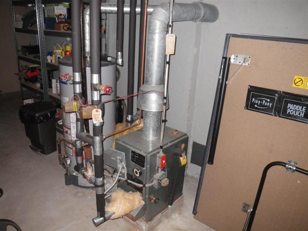

There is one pump and 2 valves for each zone. The highest temperature I saw on the gauge was 190, I assume it's high limit. I believe i don't have ability to adjust the high limit - there is no control for it and manual has nothing mentioned as well. I don't recall the exact pressure, but I think it's 25psi working and 19psi when boiler is not firing, but the water might still be hot. I will double check tonight.
I examined the individual baseboard and i do not have air bleed valves on any of them, so it looks like i have a centralized air removal contraption close to the boiler.
I think the flow is adequate, the problem that I have it's just a combination of multiple factors: the coldest room is at the coldest corner of the house, the last in the zone loop and the baseboards are more obstructed than others.
I think it would still make sense to try to tip the balance of heating from one room to another, i will make sure that the system works with best efficiency.
I will do more measurement and temp reading and report back!

15psi @ 140F
20psi @ 200F
These are with the boiler not firing, I believe 200F is high limit, but i will try to verify later. By the way, is it too high? Should see if I can lower it (I don't think my boiler has it adjustable though).
I measure the temp of the pipe coming to the second floor and leaving and it was around 160F. It was actually few degrees higher on exist. I couldn't get a good reading of the temp where the pipe comes to the second floor, so it most likely off. But even if exit temp is 160F and the boiler temp is 200F it should provide enough heat. I believe the design drop is 20F, but I also think that the pipe is bare in the wall and it loses good amount of heat before it gets to the second floor. I insulated the hell out of it in the basement where i could, but good chunks are still bare where I don't have access.
Well, at least I got good reading of the temp in the cold room, so I could compare it with a temp after i do some "improvements" this weekend
I will report back.
I will also measure the length of the all heating elements...

20psi @ 200F

how much fin tube is in the colder rooms compared to the bedroom and i mean pulling the covers and measure fin to fin not copper or covers...and was carpeting installed after the baseboard was in with the colder rooms 160F-170F pipe temps should heat up any size roomyou might be short on fins in the colder rooms.removing the fins...take a needle nose and grab one at a time twist it of...and trash them unusable...tin foil.armaflex tubing on theraw copper lines in and out of the fin area would help....are the wall tempertures real cold or pretty consistance with the nights.if the supply heated water rises to the second floor is it one straight run then back to the boiler or balanced off a header with valves to each baseboard section..
#22
jeeze... punctuate much?
The pressures look good... IF and only IF the pressure gauge is accurate... yes, there I go again... my mantra.
200 may be a bit on the high side... was that temperature taken just at the exact moment the burner shut down? or some minutes afterward?
There must be a high limit control on your boiler! and it's probably adjustable.
What controls do you see mounted? gray boxes, etc?
I think I mentioned the black electrical tape trick... those infrared thermometers do suffer from inaccuracy due to the 'emissivity' of different materials. If you compare readings from two different materials, or maybe one shiny and one dull of the same material, you will not get true differential readings.
That's the reason for the electrical tape. It lets you compare apples to apples.
Impossible... try the tape trick. Does your gun have an laser spotter?
coming to the second floor and leaving and it was around 160F. It was actually few degrees higher on exit

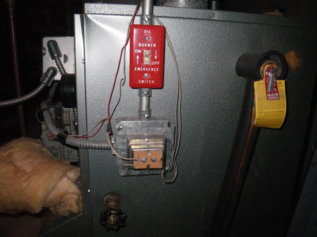

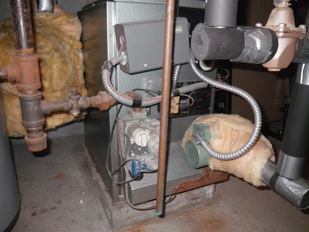

#28
That gray 4x6 -ish box on the front is the aquastat... cover slides straight off, might have to loosen one screw on the side to release cover... temp dial inside.
I think one of the kids got their cotton candy stuck to the front of your boiler!

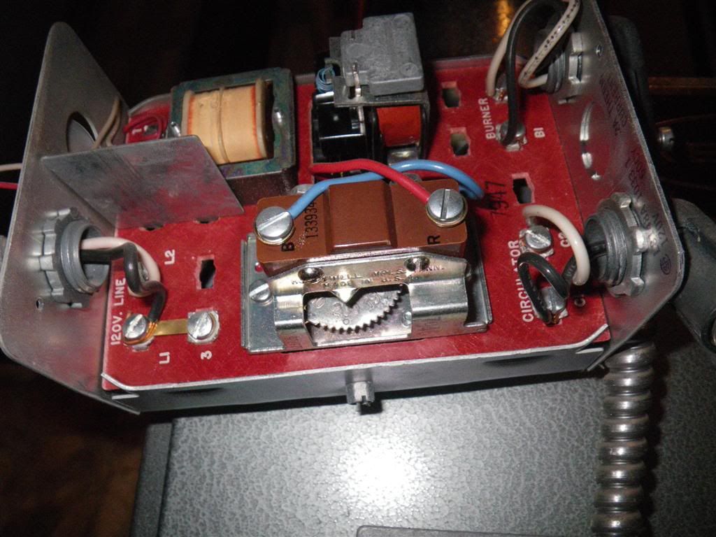

#29
Join Date: Dec 2010
Posts: 316
Received 0 Upvotes
NJTrooper,
So if I can adjust the aquastat, should I ? Should I set it at 180F? What will it do to to efficiency, boiler life span, etc?
Also I caught the boiler at the end of the firing cycle and the temp was 195. I assume it climbs to 200 after fire is out due to cast iron exchanger being hotter then 195.
And I have cotton candy all over my basement. I plan on putting a suspended ceiling there and then clean up the rest. The pump and the expansion tank are wrapped - don't know if that does much, but i don't think it hurts ...
update:
the low temp for aquastat seems to be around 170F.
I took under the cover of the grey box and there is a dial on a bottom as you said. it's set somewhere between 195 and 200, so it seems that the temp gauge is accurate at least.
please let me know if i should adjust it. i assume high temp gets adjusted and the low one is high minus some predetermined value?
update:
#30
Since you are dealing with cold rooms, those rooms will probably only get colder if you reduce the setting. So, no, I wouldn't decrease it... nor would I increase it because you are about at the highest point that you want to be.
What model is the aquastat? L8148E ?
You mean that if the heat call continues and the burner goes off on high limit, it will come back on around 170 ? ( i.e. the 'differential' is about 25° ? ) that may be a little high, I think the 8148 is usually around 10-15 fixed diff... but as long as it's REPEATABLE and consistent, it's not a problem, maybe even a benefit...
