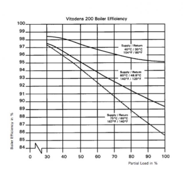

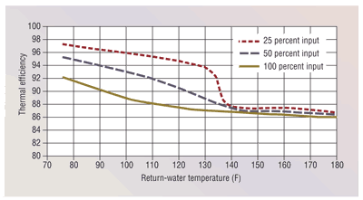

For a clean slate design your #1 is the best. Examples are numerous, Boiler Buddy, etc.
4 ports provide hydraulic seperation between boiler & system, total asynchronous operation of both, cool water to boiler to cause more condensing (at least at the start).
With my given 2 port buffer tank setup, your #2 with buffer on return works well, extends both on & off cycles. With the cool water from the return, it would seem to make more sense than having the buffer before the system load,
BUT
I have read feedback from a DIY type who very Carefully Monitored his own system where he moved his buffer between return & supply. Same load, flow, etc. etc. and the buffer in the supply caused longer cycles by about 15%
Possible reason is in how most modcon computers reacts to supply / return temperatures, cool temperature return at the start causes modulation to ramp up say 100% fire, this shortens the burn time vs. warmer water coming back AND can lower efficiency.
Some experts think that the burner modulation ratio has a higher impact on modcon effeciency than the commonly repeated: return water temperature is everything. It is both, I will post a graph.

It would seem that the benefit of lower return temperature giving us the extra heat from latent heat would out way the efficiency loss. Taking heat from the flue gasses that normally would end up outside is a benefit. You can gain about 9% from latent heat dependent on water temperature that will fluctuate. The more btu's produced that end up in the water that heats the home is the most efficient. It is not all about efficiency but cost to heat the home.
The buffer on the return will benefit also in modulation as the micro-zones call and the tank is not cold water it is usually warm. So at the beginning of the cycle we feed luke warm water and pick up the tank temp as the system runs longer. We will modulate the boiler quicker than cold return water back to the boiler.
