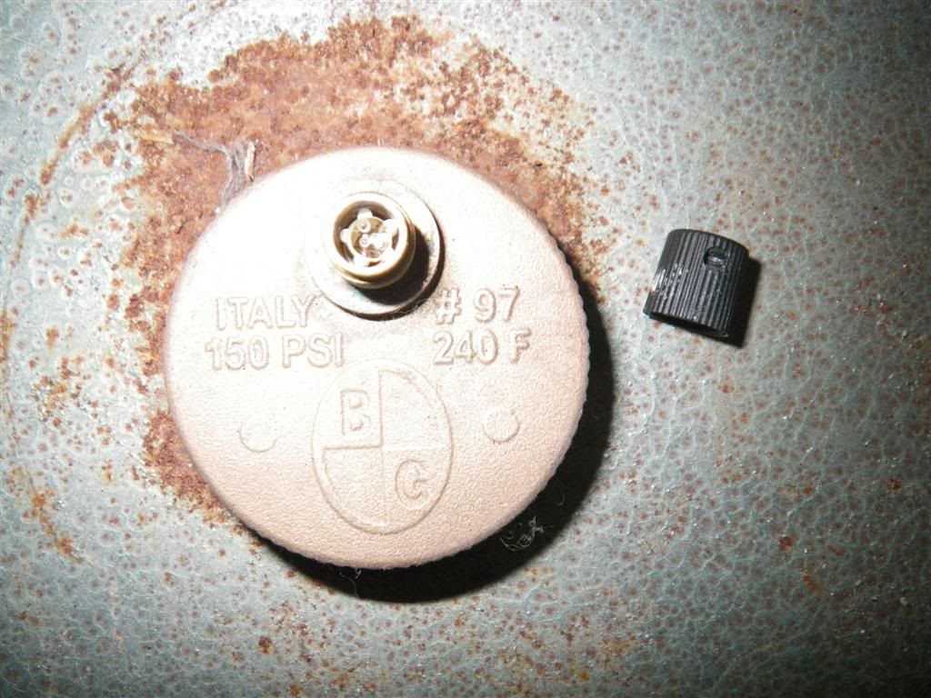

Probably not the same brand, but even if not, it's the same thing, float type automatic air vent.
If that's a 'factory' installation point, then apparently the Repco has an 'air scoop' of sorts built into the boiler. Is the black cap loose to allow air to escape?

the black cap is screwed on to the bronze part. it has a tiny opening on the side. underneath it there is something that looks like a tiny valve. the bronze part says 240F, 150 psi. is this some kind of pressure relieve valve? there is a more standard looking one on the side of the boiler though ...

Usually that has a 1/2 " tapping. I wonder how they screwed it down in there.
I believe its a tapping for a built in air seperator. The weil mclains have them, as does my old Hydrotherm.

After further review it looks like where the original pressure/temp gauge was. Makes sense that the only think that would fit the tapping is a airvent.

here are couple of close up shots of that thing:
No... it's a 'float type automatic air vent' ... told ya that already!
http://completewatersystems.com/wp-c.../02/A-3101.pdf
The ratings are simply the maximums that the device is designed to operate at.

NJTrooper, since the top wasn't floating as you though first, I thought maybe it was something else

The float is inside... if you've ever fooled with a carburetor, or a terlet bowl, it's very much like that. When it fills with air, the float drops, the valve opens, lets the air out, water comes in, float goes back up, valve closes. That's why the black cap should be left loose so air can escape.

the black cap has a hole in it, so it's actually screwed tight. i get the carburetor thing - makes perfect sense

I've never used the B&G vents, but the ones that I've used also had a hole in the cap, and screwing them down tight closes the hole... you might wanna have a closer look at that. You need some way to 'shut off' the device in case it leaks or something... and that would be by screwing the cap tight.
