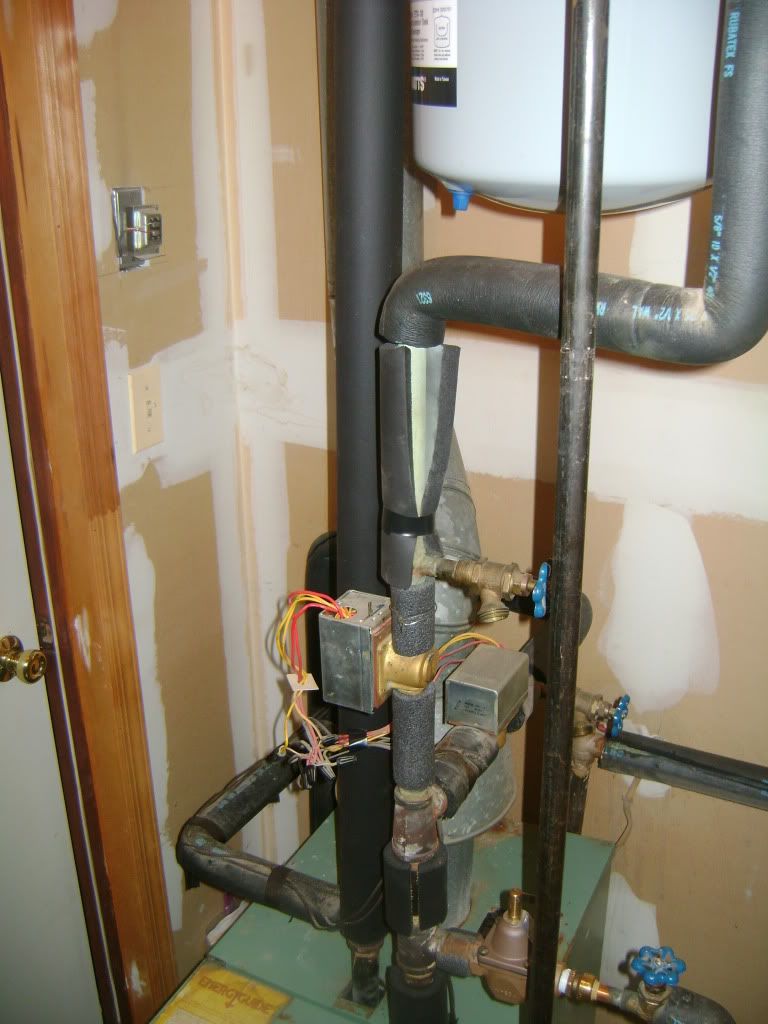

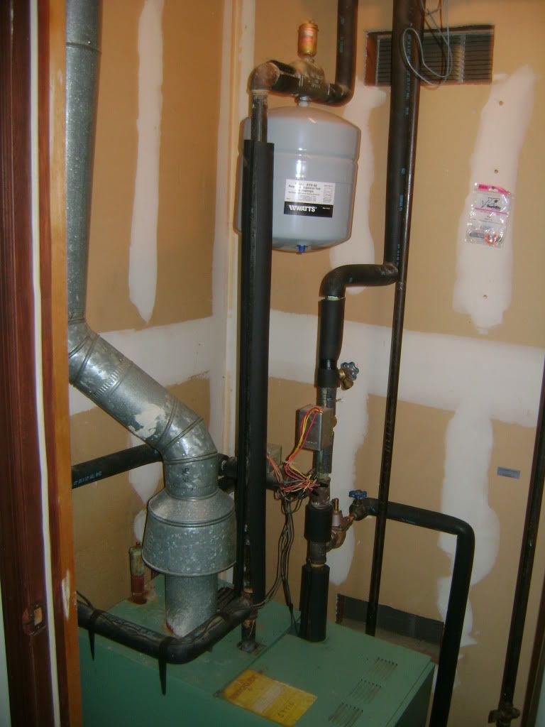

So take the pics and we'll tell ya what to do next. Stand back with the camera a bit so we can see the whole thing.

J3ffrey,
The Honeywell switches (with the wires coming out of them) are the zone valves. One thermostat is connected to one Honeywell switch. They have a little motor in them that control water flow. Your heating system probably has another way of controlling the flow of water to each zone.
#29
#30
Vinny, the way your system is set up, you need to leave the zone valves CLOSED in order to purge the zones of air... IF that's even the problem with the banging.

Join Date: Dec 2007
Posts: 49
Received 0 Upvotes
The circulator was installed backwards
I think I may have the issue. I was reading this post: http://www.doityourself.com/forum/bo...er-system.html and it said that the problem was fixed when the the pump was installed in reverse.
I think I did the same thing. When I installed it, I put the pump in by the way the electrical connector was oriented not the direction of flow. I guess I'll be taking apart this system as soon as it gets warmer this weekend!
#33
Yeah, that will do it... and I should have learned my lesson too... that should be one of the first questions that gets asked after a pump is replaced.
But this time, when you have the pressure down, check the air charge in the tank and pump it up if it is below 15 PSI! Believe me when I say that those tanks NEVER get the service they REQUIRE!
Even if you don't intend to do it, at least lie to us and tell us that you've replaced those UNSAFE WIRES.
One last thing, you can rotate the motor assembly to put the electrical box where you need it to go...

Join Date: Dec 2007
Posts: 49
Received 0 Upvotes
Circulator is reinstalled
Hi,
I was able to reinstall the pump in the right direction and also I was able to put the circulator electrical box on the opposite side. I checked the expansion tank pressure and it was 15 psi. I also was able to bleed the system of air but I guess I wasn't watching the system pressure and now it is at 25 psi. I'll take care that the SJ cable is replaced with FMC metal conduit soon. What should I do to lower the excess system pressure? By the way, the banging noise (water hammer) is gone.
#35
If you have pressure on the water side of the tank, you will NOT get an accurate read of the pressure on the air side.
If after doing this you find that the pressure is creeping back up, you've still got some problems... let us know.
