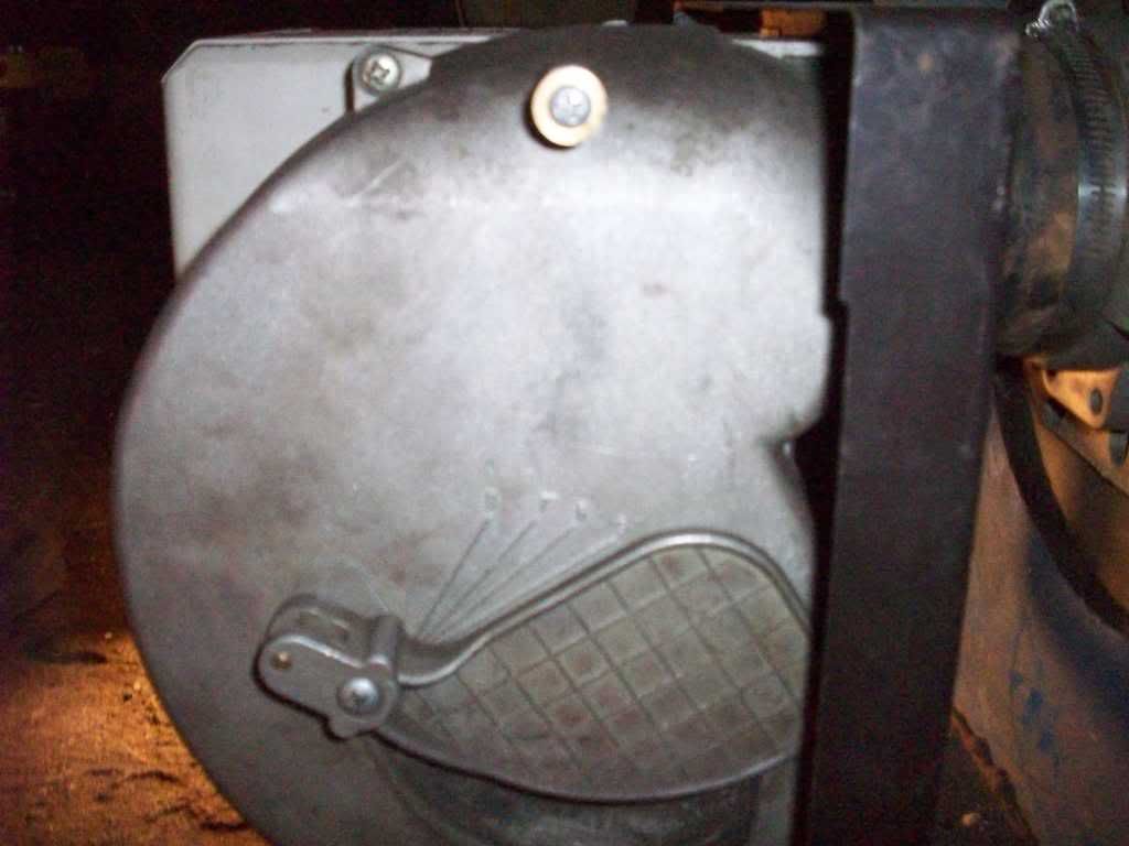

Here is a short video of the flame in my boiler. Can you tell me if it looks normal.
Is the flame supposed to be licking the bottom of the boiler water jacket, I presume the flame should not contact the boiler surfaces. It seems to be leaving deposits. It is hard to see through the inspection port so I can't tell what it is.
Boiler is a NTI NY-151 with a system bypass set wide open to ensure the boiler return temp is as high as possible.
Burner is a Riello Mectron 5M downfired to a 0.85 80B nozzle from 1.00 80B. Turbulator is set to 2 per set up doc for the Mectron. NTI doc calls fo an 80 degree nozzle while the Riello doc calls for a 60 degree.
Draft is at -0.04 at the breech and overfire, measured through the inspection port, is -0.02.
I haven't come across a smoke spot tester yet but I set the air for 12% CO2 with my meter. Temp at breech is around 380 degrees F.
Outdoor reset is installed and thermostat is set to a cycle rate of 3. Temp in the house is an almost rock solid 68 degrees F with outdoor temp in low to mid 20's.
I'm concerned the deposits will harm the boiler, any way I can prevent the deposits? Such as a different size nozzle or spray pattern?

Hello Bill,
Looks like a lot of fire.
Looks pretty good otherwise, but what do i know.
What is the boiler rated for?
Did you ever find out the oil pressure?
I know saves had you make the venturi, but we did the, by the book, neutral pressure point adjuster and it is woking too good, meaning we are a triffle positive on the draft. In a few weeks we will reduce it a bit. But my boiler sure is happy.
If you can, go for 0 draft over fire and -.01 up top.
12% might be a bit much until you get the smoke test.

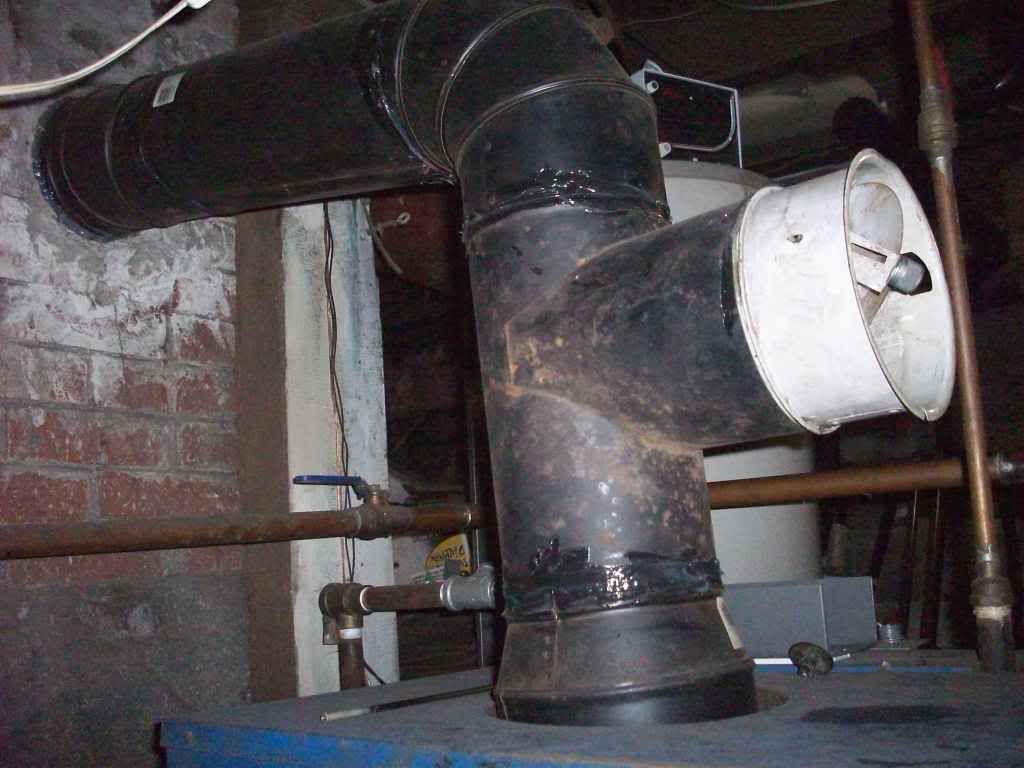

Looks like a little dark soot in the vent picture.
I can't really see the deposits.
I'm using low sulpher diesel and things seem pretty clean.
380 might be a bit high, but i don't kow the room temp where the boiler is?
Or what the claimed efficiency is.
Right now i'm running about 330, air temp about 65+/-.
How many minutes a hour is it firing to maintain 68 inside with mid 20's out?
How cold does it normally get where you are?

Flame should never touch anything. When you have impingement you will have carbon build-up which will cause the flame to deteriorate.
You need to follow the spec's for the boiler not the Riello manual.
Burner manuals are for retrofit burners and packaged units follow the boiler/furnace spec's which are supplied by the burner manufacturer's.
If the boiler is not to run with positive draft it is not a good idea to run positive as you are spilling products of combustion into your home.
What the heck is that thing that loos like it is made out of copper in the picture? It looks like it is in the combustion area.

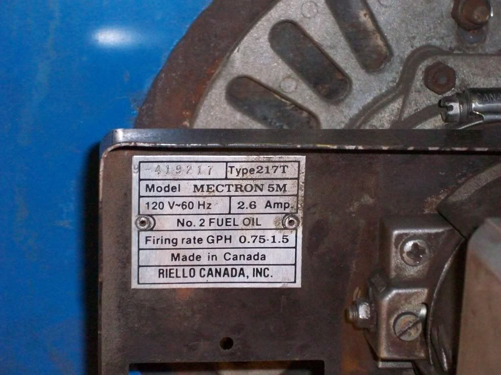

The boiler manual lists burner settings for a Riello F5, My burner is a Mectron 5M and Riello lists different turbulator settings for the 5M, which setting should I go by? Turbulator for F5=3.0 5M=2.0 I believe my boiler came with the Mectron 5M but I can't be sure, boiler was here when I bought the house.

I was able to find out that the original burner was a Riello F5 with an input of 1.35gpm, nozzle was 1.1gpm 80B. So the Mectron 5M is a replacement burner. It has .85 80B nozzle so should be firing at 1.0gpm.
What is the difference between the F5 and 5M burners.

The Riello is a burner that likes low to positive draft. Follow the boiler manufacturer's spec's which are set by the burner manufacturer.
That is not a good place for the venturi. It is acting as a scoop and could give odors as it pushes air toward the draft regulator. The plate should be about 12" above the boiler and the draft regulator a minimum or 18" above the boiler. The further from the boiler the better.
When the plate is installed properly you will close the draft regulator almost all the way and get a -0.02 draft by sliding the plate in. Then cut it off and screw it down.

I see another issue. First the manufacturer of draft regulators state they have to be 18" from the appliance. Second the pipe size cannot be reduced until you get to the chimney base. The draft regulator looks like it would be OK in the horizontal. I would not put it in the chimney.
Get it close to the chimney base.

The Mectron & 40 series use different air tubes & turbulators. Are you sure you have a Mectron? If you are going by the burner cover, the two are interchangable, I think.
If yours has a hydraulic jack to open the air shutter, I could tell for sure with a picture. The size & shape of the air shutter is also different.

It's a Mectron according to the label: .85 80B nozzle in it now.
Air shutter, hydraulic jack is removed due to repeated seal failures.

Good eye, the hose clamp is to ensure the blast tube is reinserted to the correct depth when I remove the burner for cleaning. I don't remove the flange, I loosen the clamp on the flange and slide the blast tube out.
Does the air shutter setting look reasonable for a .85 nozzle?

I kind of suspected that was the purpose of the clamp. It's hard to read the markings on the air shutter housing but my book calls for 3.7 & a turbulator setting of about 1.25 for a .85 nozzle at 145 psig pump pressure. I, like RBeck, am concerned about the amount of reduction in the firing rate for your boiler.

The current air shutter setting is about 4.2-4.3, I guess the smoke test will get it where it really needs to be.
