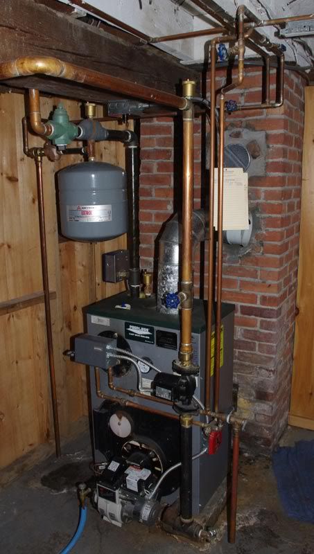

Here is an image of the entire setup if that helps:

Your water feed is the pipe that enters just above the expansion tank. There should be a valve somewhere on that line. Cant see in the pic, but see the fill valve and backflow preventer.
Probably if you can get them to come out and just charge for parts and no labor, then that would be a good option IMO.

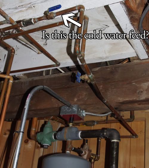

Just got off the phone with the furnace guy, he seems to think my system does have an auto-water feed valve (but why was the feed closed?)
Going by lawrosa saying that the feed would be on the line somewhere above the expansion tank, can you help me identify these things?
Is this the auto-feed valve?
Is this the street water feed main on / off valve?
Thanks again!

The bell shaped valve in your picture is you "Pressure Reducing Valve" aka 'automatic fill valve' aka 'pressure regulator', etc... that is the valve that is supposed to maintain a minimum of 12 PSI in your system. It's a Watts 1156 model. There is a lever on the top which is called a 'fast fill' lever. It's purpose is to bypass the regulation of the valve. It allows service people to fill the system faster after servicing, and for various other functions.
The device to the left, the Watts 9D, is a 'backflow preventer', and it keeps boiler water out of your domestic water supply.
Old 01-08-12, 10:20 AM
NJT's Avatar
NJT
NJT is offline
Join Date: Oct 2006
Posts: 23,538
Likes: 0
Received 8 Likes on 6 Posts
I don't think that 1/4 turn valve pointed to in your picture is the shutoff valve for the boiler feed.
It looks from what I can see in the pic that the boiler shut off is the round blue handle valve on the pipe below that, which leads directly to the boiler.
It's hard to see in the pics, but that 1/4 turn valve MAY be the shutoff for the supply to the hot water coil in the boiler. I would need to see clearer pics to determine what that pipe is feeding. That valve may in fact shut off BOTH the feed to the boiler, AND the supply to your hot water coil.
If you can get a little better lighting, and different angles, showing the pipes that lead to and from the round plate behind the gray Honeywell box on the front of the boiler we can better advise.
Probably because the previous owner knew that the Pressure Reducing Valve was leaking through... and that they had an LWCO installed...
Here's what I would do... if I were you...
Follow the instructions to check and charge the expansion tank.
In step 8, where it says to re-pressurize the boiler, open that round blue handle valve until your gauge reads 12 PSI, and CLOSE THE VALVE again.
Monitor the pressure over the course of the next couple weeks and ADD A LITTLE MORE WATER by opening that valve if the pressure drops below 12 PSI.
I'm editing my steps above because I see that it says to pressurize the tank to 15 ... set the tank to 12...

Thanks Trooper,
So I've shut off the water at the round blue valve handle, got my nice tire guage and checked the tank while the furnace is at 0PSI and cold.
The expansion tank has no pressure, however, no water came out either.
When I open the blue round handled valve, it fills with water again and the furnace sits at exactly 15 PSI.
Now I'm off to buy a bicycle pump.

OK, good... that tank pressure should be checked annually.
That's fine... 12-15 is good for the cold pressure.
It doesn't mean that it's not slowly leaking through though...
But your relief valve spewing is MOSTLY related to the fact that there is no air charge in the tank. You MAY find that after you charge the tank that it doesn't hold air... and you would need to replace it... just because there is no water out of the air valve is not 100% conclusive that the tank is NOT bad.
If you do ultimately have to replace the tank, adding a few simple valves at that time will make annual service of the tank a piece of cake... and that maintenance will allow the tank to last for a LONG TIME.
This graphic shows the water feed coming in below the added valves, but you can add those new valves BELOW the water feed... not a problem... the point is to be able to shut off the tank from the system and the ability to drain the pressure from the tank without having to mess with the boiler drains.
Parts you would need:
2 1/2" steel pipe nipples
1 1/2" steel tee fitting
1 1/2" threaded ball valve
1 1/2" boiler drain
Rector seal #5 pipe dope
maybe some teflon tape... DON'T USE TOO MUCH! Two wraps is sufficient. Don't put any dope or tape on the first two threads, leave them naked.

ok I got a foot pump, hooked it up to the expansion tank, and try as i might, I cannot pump any air into it, at all. I'm 99% sure I've got it well connected to the air valve on the bottom of the tank.
Is this indicative of anything?
Old 01-08-12, 12:59 PM
NJT's Avatar
NJT
NJT is offline
Join Date: Oct 2006
Posts: 23,538
Likes: 0
Weird... I suppose that the bladder could possibly be completely collapsed and blocking the valve.
What happens if you push the little pin on the valve in... like letting the air out of a tire?
Are you unable to even push the foot pump down?
Or, pump and pump as you may, no pressure builds in the tank?
Do you hear air gurrrrrgling and bubbbbbling up into the tank?

I get nothing, I hold the pump so it's needle is at 40 PSI and no air moves in (that's as hard as I can hold the pump arm), no gurgling or bubbling (even with my ear against the tank).
I take a pen and press the needle on the valve and I get nothing
Edit: And if I should need a new expansion tank, what would you estimate the cost to be? Or is it as easy as screwing a new one on (with your additional posted bits).

The local home store has them. Yes its as easy as screwing it on. I believe thats a ET 30 that you have. make sure its this one and not a tank for potable water.
These are pre charged to 12 psi but I would check it anyway.
Series ET Water Expansion Tank-ET-30 at The Home Depot
Use teflon tape and tape the threads 3-4 times around clockwise. Grab the tank and twist on hand tight should be good. SNUG!!!
Of course change the tank with a cool boiler and no pressure. Boiler water off. Keep a rag or towel handy.

While your at the store get two new air vents. I see one at the top of the boiler and one on top of the air seperator.
Looks like they may be leaking or bad, or at least the one ontop of the air seperator.
These purge the air out as the boiler runs. The caps on the top should be loose. If yours are tightened down that may mean they were leaking and faulty and someone tightened down the caps. Then they cant do thier job.
Same thing alittle teflon tape . Unscrew the old and screw on the new.
Auto Air Vent-T400-3 1/8 at The Home Depot

My expansion tank has been glued or cemented or something into place. I cannot get it off
What can I do now?

That's pipe dope but the type they should not have used. It will come off you need two wrenches. Or big channel locks.
You need to use one wrench to hold back on the tee and one wrench to pull on the tank nut.
It may take some force with a steady pull and push of the wrenhes. Once you get the first turn it should spin right off.
Make sure you make noises when doing this...Grrrruummmpppp!!!!!

Well there are 2 shut off valves further down stream from the tank so not too too much water will come back in from everywhere else, and I'm attempting to take it off over a bucket, but good call of the plastic sheeting.

Did you already get the replacement tank?
I do see a valve on the return side, above the pump... close that one also.
You saying that there is another one on the other side of the tank that can't be seen in the pics? That would be great if you could prevent having to drain the whole system...

Got the new expansion tank installed, everything is working great! Thanks guys!
