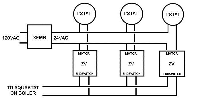

I have a 3 Floors with separate heat. Top, Main, Basement. I bought the house with only (1) 1/2" zone valve for the top floor. I would like to remove that zone valve and install it with a 3/4" Zone Valve, (as I have all 3/4" copper pipe) as well adding 2 addition 3/4" Zone Valves for the Main floor and Basement.
But the other problem is connecting them all to one Control Center. As of now I have 2 thermostats installed, 1 zone valve, and all connected to the control center.
When heat is called for the top floor, the zone valve opens and heat goes through all 3 levels.
When heat is called for the main floor, the top floor zone valve is closed and gets no heat. But the main floor and basement gets heat.
The basement has a thermostat, but it is not wired up, so it can not call for heat. Only getting it when either the top floor or main floor calls for it.
So this is why I want to install 3 new 3/4" zone valves. One for each level. Than have them all connected to their own thermostat and all connected into the Control Center. I was just quoted for $1000 to do this. I thought that this was high and I could try and do this myself.

You really don't need anything but the three zone valves and a 24v transformer. A thermostat to each zone valve and daisy chain the end switches back to the thermostat connection on the boiler.

I use this drawing a lot... explains how to hook up basic system. If you need more valves, just add them to the right side. A standard 40VA transformer will easily run three valves.
(rbecks drawing is good too! and all the other types of valves are on there as well.)
This is for the Honeywell style valves with isolated end switch, 4 wires.
Hooking up the 3 wire variety like the Taco, is just as easy.

Ok, so here's my new diagram.
Now how do I label the colours? Out of my Honeywell zone valves are 4 wires, 2 red and 2 yellow. I was trying to colour it to my diagram, but cant figure it out. Does it work just as simple with positive + and negative - ?
