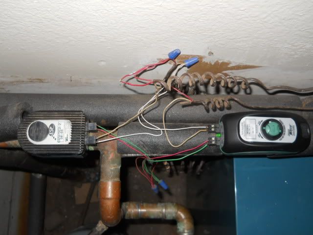

Boiler shuts OFF when thermostat tells it to turn ON
It's been a few weeks but I now have a new Taco operator on the upstairs zone valve. But, things are still not correct. This is what's happening with that upstairs zone:
When I turn the upstairs thermostat to a temperature lower than the room temperature, the green light on the zone valve operator turns OFF and the boiler turns ON. To turn the boiler off, I have to set the thermostat to a temperature higher than the room temperature (which makes the green light on the zone valve turn on). It's just the reverse of what should happen.
The downstairs zone works fine - a thermostat call for heat turns the zone valve light ON and the boiler fires ON.
When installing this new Taco operator on the upstairs valve, I had to flip the wire connectors upside-down in order to push into the slots on the operator. So, I thought that might be causing this so I took the wires out and reversed them so they were just like the old downstairs operator. But, that didn't change anything.
Any ideas on what's going on?

Here is a photo of the two zone valves and their operators. You can see the green light on for the new operator on the right (the upstairs zone). So, that means the boiler is OFF when I took the photo.
The thermostat is a Hunter 44110----same one I have on the downstairs zone.
The new Taco zone valve operator ("Actuator Head" is what Taco calls it) is model ZA024Q4A1. Taco told me that was the replacement for the original one (ESP075C2-2)----this is also the model number for the downstairs zone actuator head that I did not replace (the one on the left in the photo below).
I'll double-check my wiring at the thermostat when I'm there tomorrow.
This is weird... looking at all the documentation I can find at the Taco site, it is apparent that there are 'normally closed' and 'normally open' versions of this valve actuator, but I don't think it should reverse the action of the end switch... just the valve opening and closing.
How can this be?
Is it possible that the relative positions of the two plugs on the heads are 'swapped' ? and that the plugs are reversed? (one would think that they would make it impossible to do this, but who knows?) I just looked at the sheets again, and it appears that they are the same... in your photo, the motor connections are the yellow and white on the top, and the red/green is the end switch to the boiler.
Try this... to get the thermostat out of the picture, disconnect it. Make and break the connection by touching and un-touching the wires. This will tell you if the problem is the thermostat or the valve head (or wiring).

Just got back from the rental house and did the test as you suggested Trooper.
Before doing this test, I made sure the downstairs thermostat was set to lower than the room temperature. The downstairs works fine so wanted to remove it from the equation.
I then removed the upstairs thermostat. I then turned on the circuit breaker to the boiler and the boiler immediately fired on. I then touched the thermostat wires together. The Taco valve's green light turned on and the boiler shut off. If I keep the wires separated from each other, the valve's green light stays off but the boiler runs constantly and only shuts off when the aquastat tells it to. This explains why the upstairs was staying in the 80's all the time a few weeks ago when I first discovered this problem.
So, the upstairs thermostat seems to be fine and the valve itself is doing what it's supposed to---it lights up when the thermostat wires are connected but the boiler itself is doing just the opposite of what it should do---its turning off when there is a call for heat and turning on when there is not a call for heat.
The downstairs thermostat and zone valve work fine so I think that means its unlikely to be anything wrong with the boiler.
I'm puzzled.
I'm puzzled.

I've searched and read just about everything I could find on these valves... other than a malfunctioning actuator, I can't find a single reason that makes any sense at all why it would be acting this way.
One other remote possibility... that actuator is actually a 'normally open' part, and is mislabeled.
Are the part numbers you gave the FULL numbers?
Somehow, some way, the endswitch has gotten out of synch with the controller in the head. Thing is, even if it get outta whack, the valve is supposed to automatically 're-index' itself upon power up.
I suggest that you contact Taco directly.

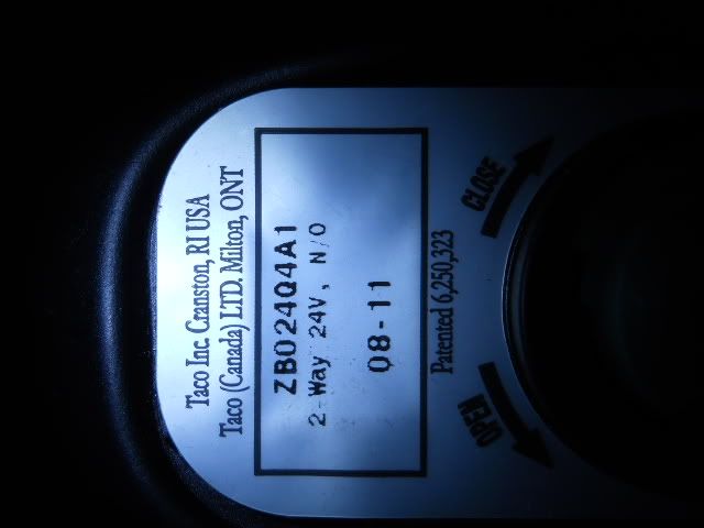

OK, I'm just back from the rental house for the first time in a week. I did the test you suggested Trooper. I unplugged both the 24v and endswitch plugs from the downstairs valve (the older one that works ok).
The upstairs thermostat showed the room at 41 degrees and I picked a setpoint of 50 degrees. I flipped the circuit breaker on, the upstairs zone valve started flashing green, the vent started to open, the boiler started to fire and then immediately stopped as the zone valve turned clockwise 90 degrees. The vent then closed. I turned the circuit breaker off and the zone valve turned 90 degrees counter-clockwise.
Here is my bigger finding----the valve that I ordered from PexSupply and the label on the box is for model ZA024Q4A1. That is what Taco told me was the replacement for the older model I had. But, look at the photo below and you will see your assumption was correct Trooper. The valve inside the box had that other model number: ZB024Q4A1.
Do you think this incorrect valve is causing the problems I'm seeing? I think I needed a "normally closed" valve and I assume this ZB model is "normally open" though I'm not sure what those terms mean exactly.

Yes Sir, that is exactly the problem. They stuck the wrong valve in the box.
Normally CLOSED means that when the thermostat is NOT calling, the valve is CLOSED and the endswitch is OPEN (not calling).
Normally OPEN means that when the thermostat is NOT calling, the valve is OPEN and the endswitch is CLOSED (calling.)
Where would one intentionally use a normally OPEN zone valve? hmmmm... possible a heat dump circuit for a wood stove ? If there were a power failure, the valve would OPEN and allow gravity flow to the dump zone... in which case, the endswitch would probably not be wired to anything anyway, so is irrelevant. Or, perhaps the endswitch might be wired to a battery backed up alarm system to alert the condition... I'm sure there are other examples...
I guarantee if you put the correct head on there it will work properly. Hopefully PS will correct the mistake...

I installed the correct valve yesterday and everything now works as it should. Amazing what using the right part does!
Thanks Trooper for figuring this out for me. I would never have known to look closely at the label on the valve without your assistance. I ordered the correct part and the box it came it had the correct number. Somewhere along the line though, someone slipped the wrong valve into that box. They both look identical so without your help, I would never have solved this puzzle. Even Taco customer service didn't think to ask me to look at what model number I had installed----they said I had a "wiring problem" that I'd need to figure out.
