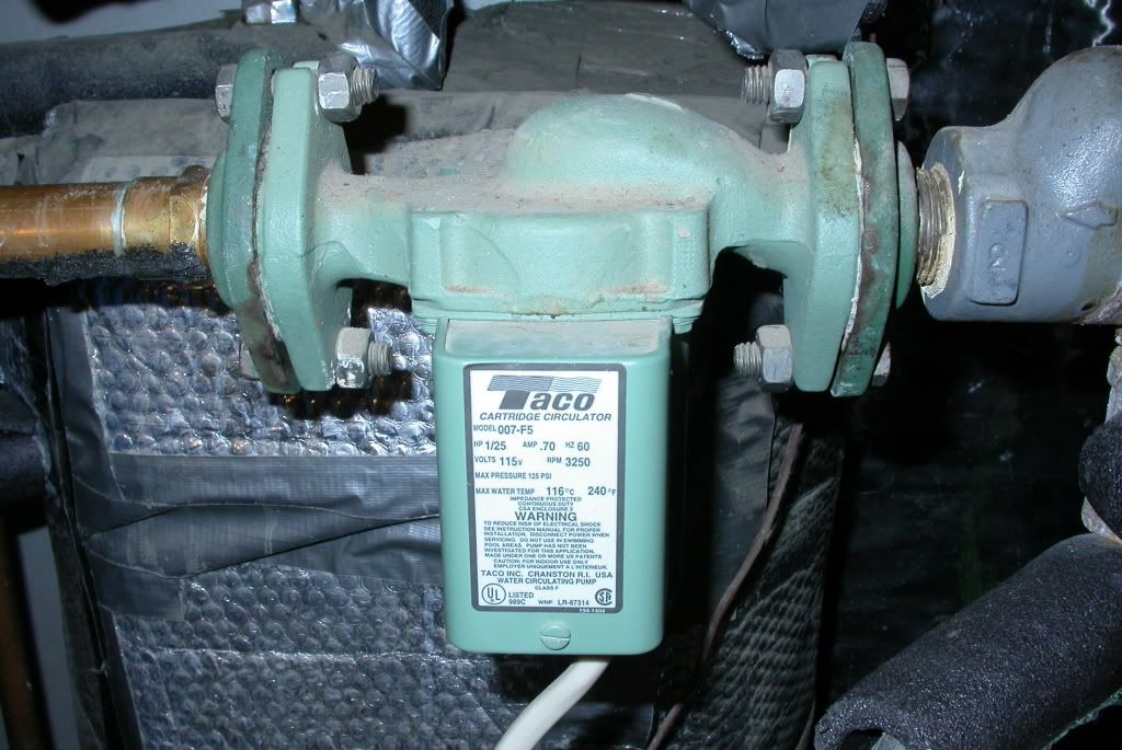

My boiler system was installed 15 years ago. I am about to replace the Taco 007-F5 circulation pump for the first time. The pump has begun making noise when more than one zone is open, so I figured I'd replace it before it fails. In an earlier thread I was advised to change the orientation of the pump. It hangs down vertically, rather than being mounted horizontally. You folks told me this and now I see it in the install directions from Taco. I assume all I have to do is rotate the flanges 90 degrees. They are threaded so I assume I just use a couple of pipe wrenches and rotate them. Is it that simple, being careful, etc. or what do I do? Thanks

Not sure I understand why the pump is making noise when more than one zone is open... that's kinda weird. But maybe has something to do with improper mounting.
You must have posted pics earlier if we commented on them... can you drop a link to the pics again?
Never mind... found it:
No, you don't want to rotate those flanges. You will cause problems. There may be another solution.
You can purchase a pump with rotated flanges... like this:
stand by and I'll get ya some info.

Hmmm... this PDF shows that the 007-F5-5 is the model with the rotated flanges, but it also shows that the flange to flange distance is 6" versus 6-3/8" on the standard pump.
http://www.taco-hvac.com/uploads/Fil...ry/101-029.pdf
I can't see the piping to the left of the pump to tell if you will be able to pull in the piping to make up that 3/8" or not...
Take another pic?

I'm gonna suggest a different pump:
Grundfos 15-58FC
Follow the directions to remove the 'internal flow check' before installing. (easy)
This is a 3 speed, run it on high (medium might be OK too).
This one is 6-1/2" flange to flange and should bolt right in. The flanges are oriented for your application
Patriot Supply - 59896341

I might be tempted to turn it so the motor is UP though, as that orientation is 'OK' with Taco as long as the pressure stays high enough. In any case, it would have to be better than the completely disallowed alternative, right?
Backing up a bit... if you did want to turn the flanges, I would take it apart... remove the flanges from the nipples, and maybe remove and replace the nipples themselves, start with some fresh pipe dope and reassemble. Your chance of having no leaks would be diminished I think.

You would probably not have too much trouble with the right side flange, being that it's all steel there... but that one on the left, you would have to be VERY careful that you didn't put any torque on the copper pipe... I think you would be better off to cut the pipe back and install an isolation flange instead.
There's many variations of these, this one has a 'swivel' flange for simple alignment:

I've puzzled from time to time over the reasons that Taco has their 'rules' for mounting the pump.
Most likely reason not to 'hang' the motor is undue stress and wear on a thrust bearing/washer.
The only reason that I can come up with for the 20 PSI 'rule' is that when mounted motor up that there is more susceptibility to pump cavitation... why else might they spec a minimum pressure? Maybe I'll "Ask Taco" !

When I asked that question eons ago, I was told that the 20# would ensure the motor cartidge is sealed against the gasket. Personally, I don't think it takes that much pressure but that's just my opinion. If I see one in the field mounted motor up, I advise the customer of Taco's official line. Most of the time I'm ignored but I've covered my tail. Please sign here.
In Jewler's case, my crystal ball shows a torch or two hammers & a new flange. That cast will crack pretty easily.

OK, here are my theories about the mounting positions:
With the motor housing pointed upward, the rotor internals will be a dead-ended space for air to become trapped - this could cause noise or possible overheating (since the rotor internals and bearings need to be fully immersed in the fluid for cooling and lubrication). Jacking up the system pressure will reduce the trapped air volume and probably increase the opportunity for the air to be absorbed in the fluid and ultimately ejected from the system.
With the motor housing pointed downward, any sediment will tend to collect on top of the rotor cartridge, and foul the bearings that are exposed to the water - leading to noise and bearing failure.
That leaves pointing the motor housing horizontally, which is the preferred arrangement.

I got an answer from the fine folks at Taco, and it seems we were all at least partially correct:
In terms of not having the motor hanging down, your guess is absolutely correct. With the motor hanging down, the bearings will be working extra hard to thrust the impeller up, and this can significantly reduce the life expectancy of the pump. Also, with the motor in the down position, the bearings may make noise, as they were not designed to function in that orientation. Many noisy pump calls are explained by a downward hanging motor.
When it comes to having the motor pointing up towards the ceiling, there is a little more leeway. Because our 00 series circulators are wet rotor pumps, they rely on system water constantly circulating through the cartridge to both lubricate the bearings and keep them quiet. What this means, ultimately, is that we need to make sure system fluid can not only enter the cartridge, but also fill it up all the way. When the motor is horizontal, this is not a worry, as water can enter and fill the cartridge easily. When the motor is in the vertical up position in systems with less than 20 psi, the cartridge might not fill all the way, leading to a situation where the life of the cartridge may be shortened and the pump may be noisy. When there is over 20 psi in the system, we are confident that the cartridge will fill all the way, eliminating the chance of a problem.
Mystery solved! Thanks Taco!
