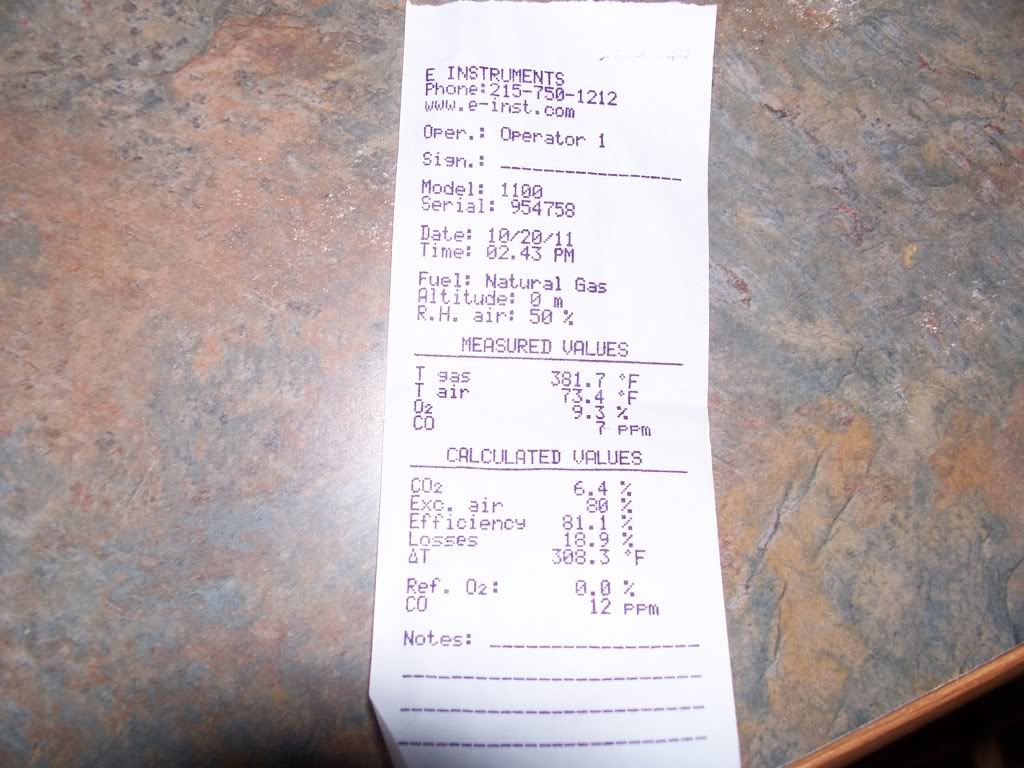

Water heater should be 4" flue. Then the Connection where it connects in the main flue should be, looks like to be a 6x5x4 Y.
Here is what a combustion analyser will read.
I had a 280 co reading on my old hydrotherm. They cleaned it and got it down the above. I did not believe them and had a independent person come out to check. Needs to read under 100 ppm. I am at 7 ppm. ( Although I still dont believe it...LOL)
My 1984 Hydrotherm with powerpile.
Mike NJ

he said we didn't need one
1. He doesn't know how to do one.
2. He doesn't have the equipment to do one.
3. He doesn't want to do one.
4. He is ignorant.
Here's the thing... you've detected CO levels that are way too high in your living space, that's a given.
That CO is coming from somewhere, and leaking into your home, another given.
The SOURCE of the CO needs to be found and corrected, FIRST. If your boiler or water heater is producing thousands of part per million of CO, it's nearly inevitable that some of that will leak into the home and give elevated levels.
If your appliances are only PRODUCING much smaller levels of CO, then it stands to reason that even if there were a leakage path, the levels in the home would be much lower.
After the SOURCE of the CO is found and corrected, then any leaks in the flue system would need correction. It's a two step process.
How about an analogy?
I had a dead mouse in the garage. Stunk to high Heaven. I sprayed three cans of Fabreze around. It still stunk. I found the dead mouse and disposed of it. It didn't stink anymore.
