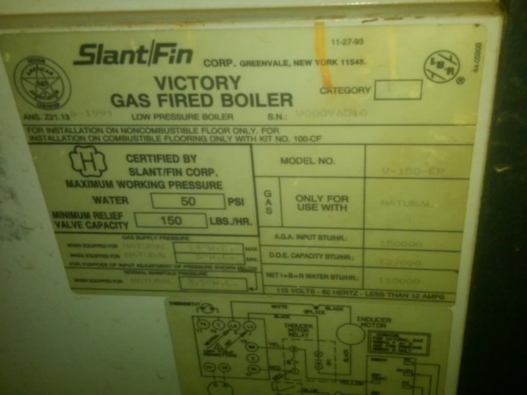

I have an older Slant Fin V150 Boiler - Natural gas Unit. It was leaking through the relief valve. I changed the valve, and it is still losing water. I checked for leaks, but could not find any. After inspecting the new relief valve, it looks like it pops speratically until the boiler pressure eventually goes to 0. This process takes anywhere from 6 hours to 3 days. When its colder out it loses pressure faster, and needs to be refilled.

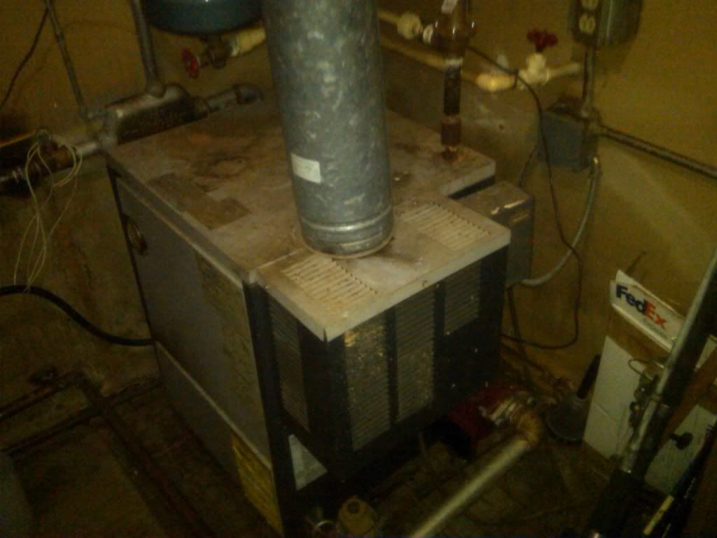

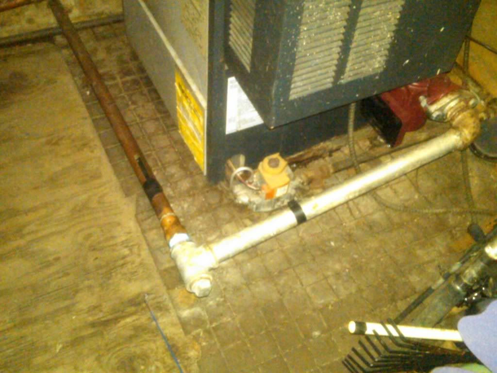

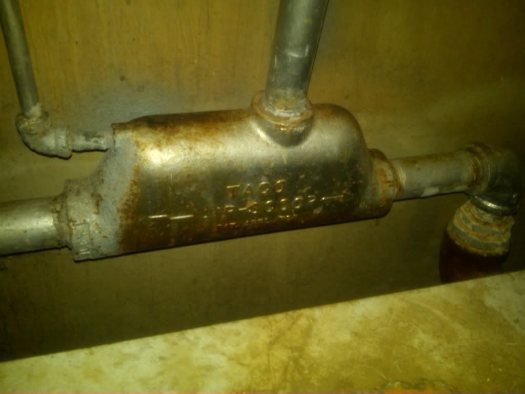

here's some pics i took with my phone

That system used to have one of the large steel tanks in the joists above the boiler, that's why the tapping on the top of that air scoop is as large as it is. Someone changed over to this system at a later date.
