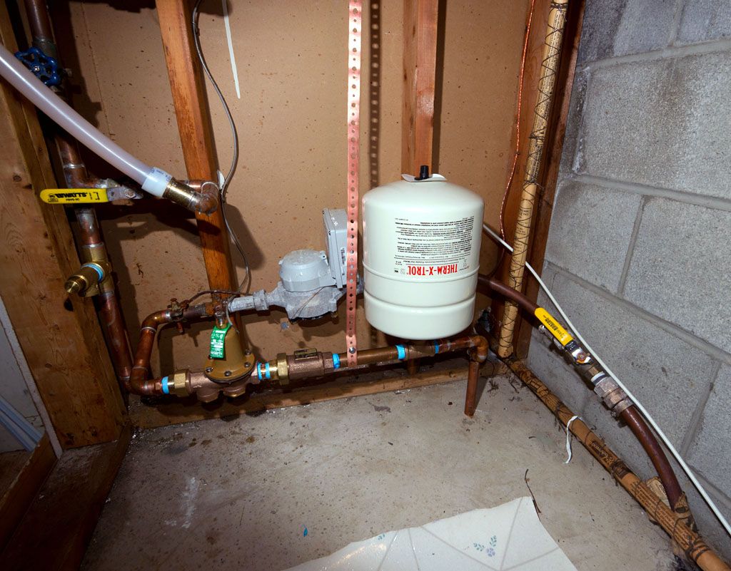

This is the expansion tank installed:

I can't see all the piping in this picture:
I take it the yellow handle valve at the rear is on the pipe coming from the street?
Then that pipe goes directly to the gray water meter?
The bottom of the pic cuts off the piping... does the other side of the water meter go directly to the bell shaped pressure regulator?
And then to the expansion tank?
And then to the rest of the house supply?

Apologies, NJ Trooper, I didn't see you last responses -- I appreciate them a lot.
Yes, the yellow valve at the rear is coming from the street. I'll try to take pictures at different angles tonight.
Our water at under 50psi does feel a bit low. It's OK, though, especially now that I remember in the past I didn't want to touch our under-the-kitchen sink valve, under the toilet tank valves, etc., because whenever I did, they leaked for a couple of days. I now suspect it was because of the too high water pressure. So our plumbing may be being strained in the past.
On our two toilet tanks I increased the water pressure (by turning the valves under the toilet tank) and no leak.
If you could walk me through increasing the PSI to 60 I'd appreciate that a lot.

Looks like a standard watts with a 50 psi preset.
Here are the instructions for reference.
http://media2.wattswater.com/1910200.pdf
IMO 60 psi would be the max I would set it. Possibly 65 psi if running an irrigation system.
I see there is a 100 psi relief valve. Thats there because you have plastic water piping. You should pipe it within 6" of the floor. Although it will not hurt you if it trips, its still code I as far as I know.
The installer should have done this. Permits should have been taken out also.

Thank you, NJ Trooper. Below is hopefully a better picture that would show most of the plumbing.
Model # on the green metal tag is scratched off.
Other info on the green tag:
Size 1/4
Set 50 PSI
Range 25-75 PSI
Max 300PSI / 160 deg F ("deg" expressed in superscript-o)
WATTS
Size 1/4
Set 50 PSI
Range 25-75 PSI
WATTS

Thank you, Mike.
Yes when we asked them to come back to check the water pressure was at ~50 psi (when we hadn't yet replaced the shower head) and to increase it some I was told by the plumber that the PSI was set at the factory. The plumber said some models can be adjusted. He did not make any adjustment. This gave me the impression that ours is fixed and cannot be adjusted.
However from the PDF you sent it looks simple enough -- loosen the locking nut and turn the adjusting bolt. I'm assuming the "adjusting bolt" is the same as the "adjusting screw" in the diagram.
