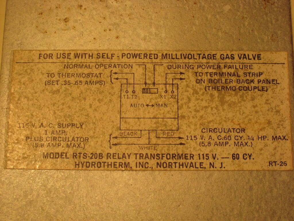

Hello,
Here are the pictures of the Gas Valve, Aquastat, Relay, and circulator pump. Pleas let me know if you need more pictures, of pictures are unclear.
the circulator pump was very very noisy when i turn on the heat. Its almost like the motor running with, tick tick tick tick tick.... with a bunch of humming noise.
I educated myself with a generate heating system component last night and today. I dont believe the circulator was serviced or lube at all for past whatever number of years.
What would be some of the things i can do to get rid of the noise?
Thanks.

I would say you need to check the voltage from the transformer in your last pic in post #1. 24volts.
But then again if the circ is running it would seem the end switch in the zone valve is operating. The end switch would go the the control on the side by the boiler with the toilet paper roll.
Both zone valves do not open?????

Not sure about the power pile staying on without enough power to open the gas valve.. I would say change that first, but they are pricey.
I am inclined to say the gas valve itself may be the issue. ( But more $$$)
But please wait for other input. I see trooper is on and he knows controls better then I.

OK you need a meter and do these tests. See what the mv is from the powerpile.
Then test the Ohms of the gas valve
http://www.keatingofchicago.com/media/svcinst/TroubleMillvoltGasV.pdf
Here is a pic for reference.
T1/T2 should come from the end switch from the zone valves.
X1/X2 go to that strip. Putting it in manual though should not of opened the zone valves though.
These were not the original zone valves. When you put it on manual all it does is fire the gas valve. The zone valves would need to be opened manually. This is used during power failure. The circ would not run either and the home would heat from convection.
[IMG]

Before you do anything else disconnect X1 and X2 from the relay and clean these wires thoroughly. Then touch the two wire together and see if the burner lights. If it does then the problem is at the relay and I will advise you more.
#33
Join Date: Nov 2007
Location: Usa
Posts: 157
Received 0 Upvotes
I did exactly that - and the burner fired up. I am letting it touch together for now, and then make sure the baseboard cast iron has heat coming out. I think it should be out in 10 minutes or so.
So, is it the relay?
#34

I was able to get the burner started using Furd's method, by touching X1 and X2 together. Would this still be the isue with the gas valve if the burner is firing?
thanks,
#36
Good!!!
Just a note: Leaving those wires together I believe will cause the boiler to work off the aquastat only. Meaning it will constanly kick on and off from high limit and differential.
As far as the issue with the relay IDK. You will need to wait Joel to answer that.
Note: Also I bilieve those controls were an issue. Mine was changed in 1984 to a regular unit without the manual/auto switch. I would say the switch is bad but not sure.
I do know the contacts fail and the reason I stated to slide it back and forth a few times.
Again wait for Joel.

So i returned to boiler room - shut off the switch, and the circulator stopped, but the burner is still firing.
So i took the 2 wires apart and the fire stopped. A few minutes later, i was planning ot take the pictures of the flame, so i put the wires together again. This time, it did not fire up anymore. I looked at the temp gauge, and it is at 200 degrees. The Aquastat also has it set to 200. Is this the reason why it did not fire up? I didnt try again, and screw the 2 wires back in.
Is the X1 on the side of the boiler suppose to go to X2 on the relay switch? I noticed that thats how it is wired. X2 on relay goes to x1 on burner. X1 on relay goes to X2 on burner.
Thanks.
