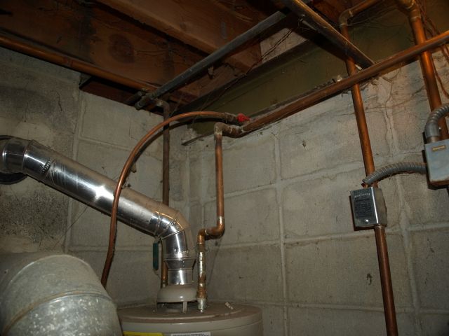

I do NOT like that gas line, not one little bit! IMHO that is just WRONG! That might be the first thing I would have fixed.
Elbow straight down the wall to a 'drip tee' in black piping, and then into the water heater gas supply. It would be OK to use a flex line from the pipe into the water heater as long as it's a code accepted one. [ usually YELLOW plastic coating on them ]
Like this:
image courtesy nachi.org
Me personally probably wouldn't mess with the gas myself. I don't trust gas and don't recommend that homeowners mess with it.
Why? May be an LP system. Its quite common....As long as proper flare connections. Even if NG whats the issue?
If that is repaired, I would advise that an 'isolation flange be used:
Dont like them...Just my opinion....

In this pic, and Furd mentioned the 'zone valves' earlier, and the one with the cable popping out of it, it makes me wonder if you might have 120VAC zone valves. It would not be 'normal' to use that metal sheathed cable for low voltage wiring... nothing wrong with doing so, but it just isn't seen. Usually if you see that type of cable you should assume that it is 120 VAC. BE CAREFUL! 120VAC can KILL YOU! but see if you can SAFELY get make/model information off those valves.
[ How odd that your block foundation walls are 'straight stacked' ! ]

whats the issue?
Prone to damage, accident waiting to happen. Way it's installed too easy to bump and cause leak, all that torque on the pipe... un-workmanlike installation.
Can't see the gas valve end, but I just BET there's no drip leg there, and with the age of those pipes how long do ya think before those rust flakes clog up that brand new gas valve?
T'chix, can ya take a pic of where the copper connects to the gas valve on the WH?
Not so much the fact that it's copper which some ppl take exception to, just the way it's installed. Just my NSHO!
Why? what's the issue?
