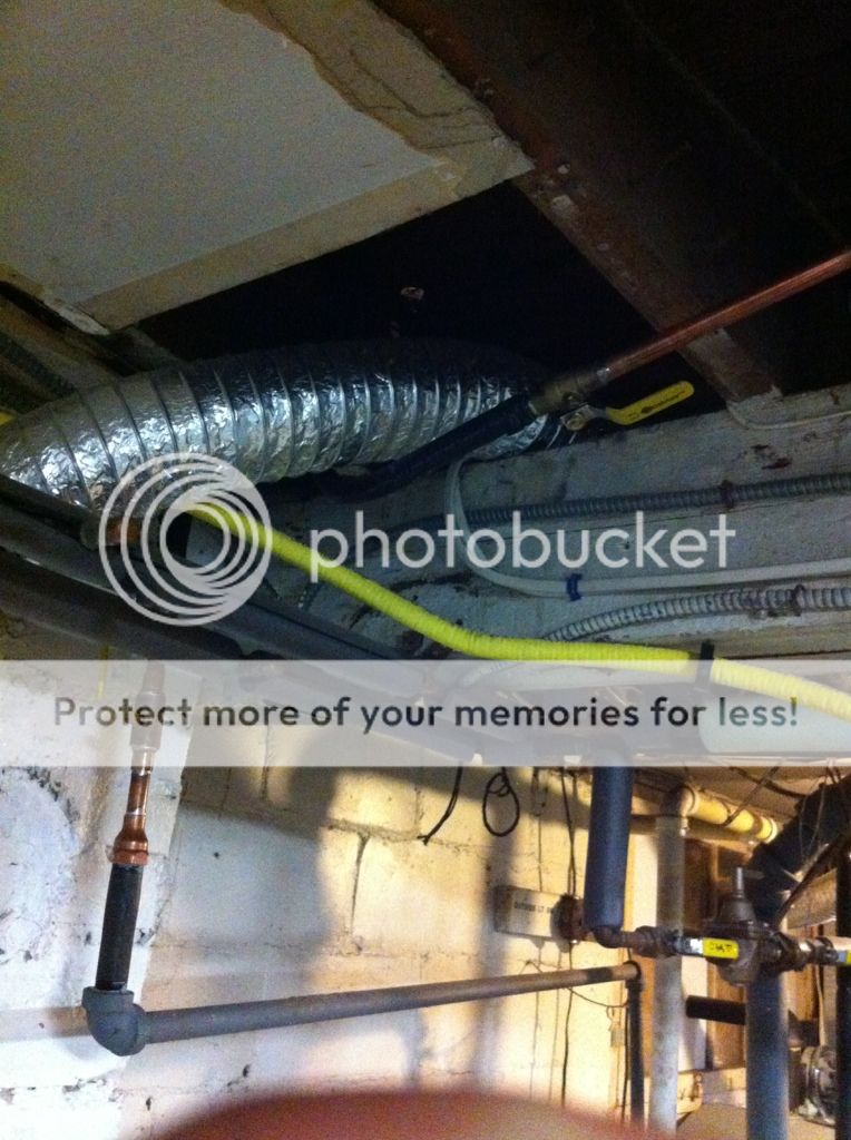

Here is a picture of the toekick unit right now. Excuse the mess Im doing a kitchen remodel as i mentioned. The bleeder is on the return side.

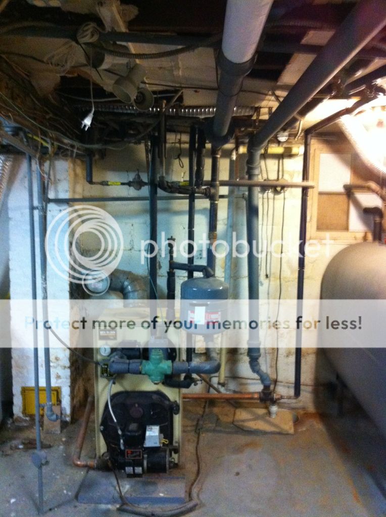

This is looking at the boiler. The pipe coming outof the front left as your facing the boiler and then going through the green flow check valve is the supply side. The Taco circ pump is right off the boiler and then into the piping. It makes a bend towards the back of the boiler and then goes straight up into some black piping where the first couple of tees interrupt the flow. It then heads to the ceiling into the 3" pipe. See the next picture.

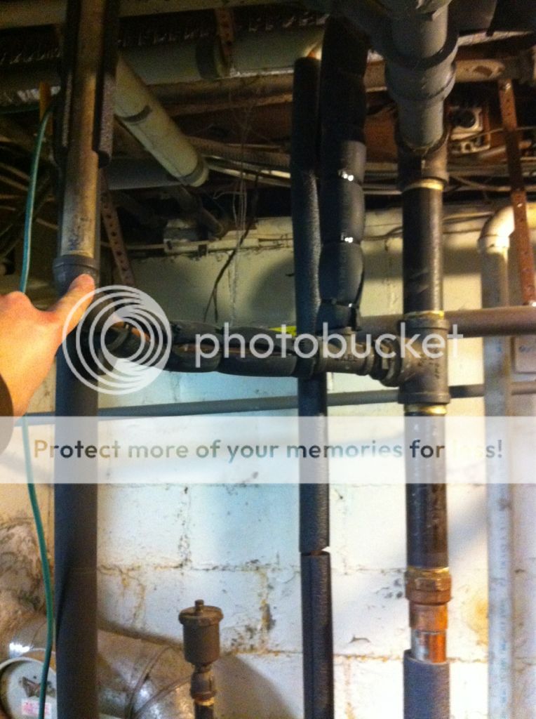

Here is the view with my back to the boiler. The supply piping is on the right side of the picture and you can see a little white fiberglass pipe insulation I added to it. The return is on the other side parallel to it.
Here you can see the copper piping at the lower left of the picture this is the supply coming from the boiler and then goes into the black piping and some tees. The pipe that my finger is touching is the supply that goes to the toe kick. It is very close to the beginning of the run to the boiler.

Lets take another look at this picture.
Notice the large grey piping coming down on the lower left. See the next picture for a close up.
Above is the return to the boiler. The smaller grey piping in the back is the return from the toe kick. It basically has its own return.... The large grey pipe connects to the mains running the length of the basement and the copper on the right is a direct run to the upstairs bathroom which was redone in copper during a remodel i imagine.

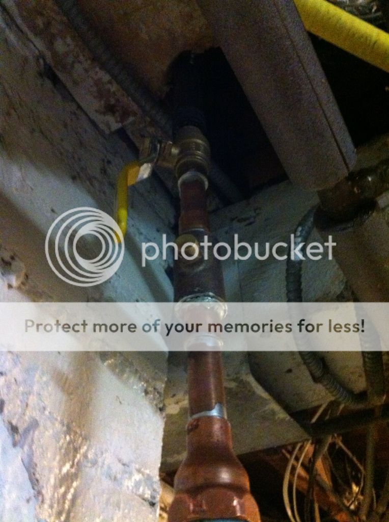

Above is a picture of how I have the soft lines tied in. See the ball valve in the upper middle? Thats the supply. The left hand side that goes down to the boiler is the return.

OK... you've still got an air blockage, of that I'm certain.
You are basically piped with home runs back to the boiler, so pressure drop is not the problem.
Did you use FULL PORT ball valves? they don't appear to be but this time of night I can't see...
The way you have the bleeder set up, you will only be bleeding up the supply as far as the toe kick. You weren't bleeding the return from the toe kick back to the tie in near the boiler.
Since you have the valves installed, you can do this easily though.
CLOSE THE SUPPLY SIDE BALL VALVE.
Jack the pressure in the boiler a little bit (pump NOT running) and open the bleeder at the toe kick.
This will force water AND air up the return pipe and out the bleeder.
Guarantee that will work...

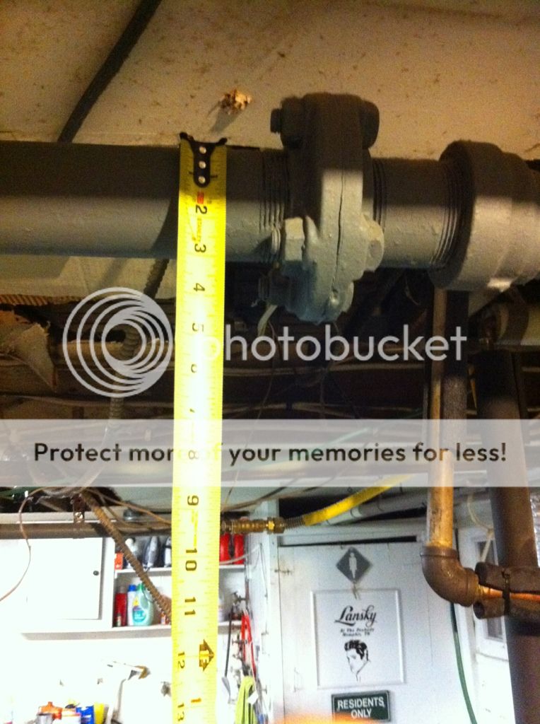

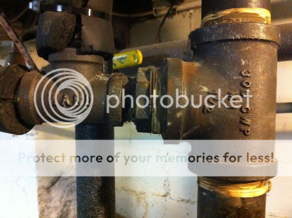

iwarosa, See the pic below for an infocus closeup.
Trooper. Im not convinced yet.. See the picture below for another look at the return piping. I have that drain port inline with it. It is before the ball valve. I think they are full port but im not 100% how would I tell? Anyway the regulator with makeup water is piped into the return so when I open up any of the bleeders and the ball valve to the return is open the pressure from that and the water in the rest of the system comes back up through there. Ive bled both way with one valve open and the other closed. Then switched.

Iwarosa, That picture is of the "stack" that is going down to the boiler. This is the supply side. The copper pipe on the bottom right makes its way to the circ pump and then into the boiler supply port. what you see there is the first couple of tees before it makes its way to the parallel runs that are the 3" iron piping running the length of the house. One of those first tees actually the left exit port of the horizontal tee is the feed for the toe kick heater which also has its own essentially home run back to the boiler on the return side.
