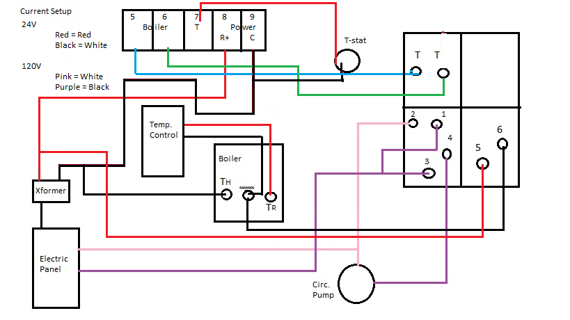

Before I touched anything, I made a diagram of how everything is set up now:

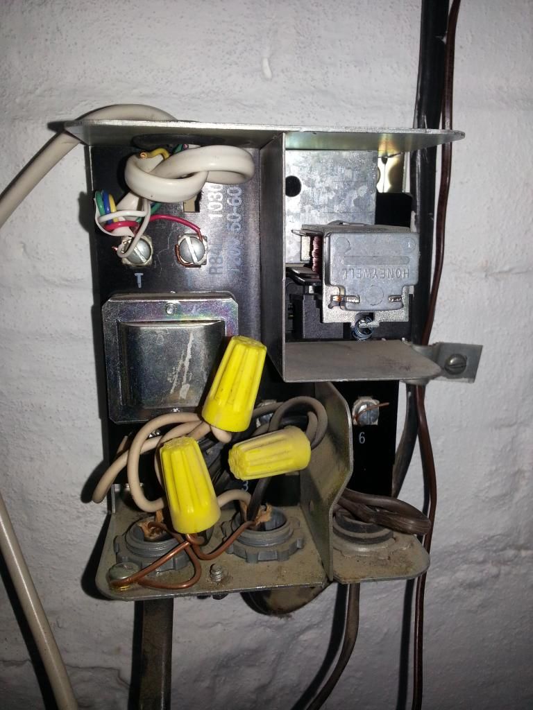

Here are pictures of the components/connections:
Temp controller (set at 180*):
Boiler:
Gas Valve Connections:
Relay Box Controller Thingy (& Inside Cover):
Connections on Tekmar Controller:
From reading the Tekmar's manual, it seems like terminals 5 and 6 got to the TT terminals on the relay box, 7 and 9 got to my thermostat, and 8/9 go to the transformer.
Like this:
Assuming that's correct (and I don't pretend that it is), how does the boiler get connected? Also, what, if anything, gets connected to 5/6 on the relay box? Finally, does the temp sensor get eliminated by the Tekmar? I would think so, but just want to confirm.
You said this and then asked how the boiler gets connected ?
You answered your own question.
The input sensor gets mounted to the copper supply line pipe. Next to existing temp sensor.
In the Tekmar product description I see the following:
Microprocessor control. This is not a safety (limit) control
I think I would leave that temp sensor just where it is as a safety shutdown.

T T stands for "Thermostat" connections, but your old berler won't have them called exactly that.
Just looked again, you aren't gonna let me get outta here that easy, are you?
The T T connections are on the 845 Honeywell relay box, that's where the Tekmar wires will go.
You are going to leave the temp control (your HIGH LIMIT) control (the PENN box) connected... along with the wires to 5 and 6 in the 845... and the wires on the gas valve obviously need to stay.

actually, on second look, you've got the wiring of the 256 correct,
but you need to leave all that other wiring the way it is...
we'll talk more about the settings and stuff tomorrow...
this time I'm really leaving!

OK, I looked again at the diagram, before and after, and yes, the Tekmar wiring is in fact correct, and yes, you leave the wiring on 5 & 6 , and to the gas valve, and to the PENN (high limit) control, and to the transformer.
So basically what you are going to do as per your drawing is
ADD connections to the existing connections on the transformer to power the 256 (24VAC)
MOVE the thermostat from the 845 to the 256
ADD connections from the 256 to the T T on the 845

Ok, thanks again for all of the suggestions. I made up a new diagram.
Assuming this is correct, then I have a few more questions:
1) Do I need the Penn temp sensor? I'm leaning towards eliminating it if possible for 2 reasons - 1 general decluttering and 2, I don't want any conflicting signals between it and the Tekmar.
2) Can anyone describe the "thought" process of my boiler with this hookup? For example, ​my understanding​ is thatunder the old system, the thermostat called for heat, the relay turned on the circulator pump and gave the boiler permission to fire. If the temp sensor read under 180*, it closed the circuit allowing the boiler to fire.
Having an explanation like this helps me visualize what's going on. What I'm specifically concerned with is if the thermostat calls for heat, the Tekmar decides that the water temp is already warm enough so it doesn't fire the boiler. Will the pump still circulate until the thermostat is satisfied?
3) Sounds silly, but is there a reason why all of these connections use wire nuts? My DC experience is to use solderless or solder connections with heat shrink wrap. Any reason I can't use that for all of these splices?
YES! you ABSOLUTELY DO NEED IT! It is a primary SAFETY CONTROL! Without that control in place the boiler could heat up to whatever temp it wanted to. The Tekmar is NOT a primary safety control. You MUST leave the Penn control in place!
Oh crap... you're correct! I forgot all about the circ won't run! Time for plan B.

should I leave the temp setting at 180*, or can I lower to something else?
Yes. Leave it at 180. The ODR will control the temperature, but it may need to fire to 180 in the coldest of winter and if you turn the PENN down, it won't be able to.
Here's how you need to wire it up:
Thermostat calls for heat, activates 845 relay.
845 relay turns on circ pump, AND CLOSES CONTACT AT 5 & 6.
5 & 6 then in turn send demand to 256.
256 powers gas valve through high limit switch.

Patrick, I put a revision up just now that will make it easier to wire with 2 wire thermostat wire all around.
2 wires from transformer to 256, 2 wires from 256 to gas valve, 2 wires from 256 to 845, 2 wires from gas valve to high limit control.
Happy New Year!

Just a bit of an update:
I've got everything wired up the way Troop has it diagramed in Post#23 and everything seems to be working as designed. When there's a call for heat, the circulator pump turns on, and if necesssary the boiler fires a short time later. The Tekmar went through a quick setup; I started out with the values that were already programmed in there. I think it set the boiler design at 160* and the Boiler Min at 140*. I set the outdoor design with the factory setting of 10*. I left the Penn box at 180*, but based on the Tekmar's settings, it should never get there.
It's too early to tell if everything's exactly the way it should be, but no problems so far. We keep the heat around 66* and we've been comfortable in the house. I haven't been running down to the basement however to see what temp the Tekmar has the boiler at, and it'll take at least a month or so to know if there's been any impact on my gas bill. The outside temps have been in the high 30s/low 40s. I also took the opportunity to remove some of that ancient wiring that was hooked up to the boiler (some had cloth insulation) and re-wrire everything with new wire. (I wondered why the last person used so much electrical tape instead of wire ties, then I realized that plastic wire ties might not have been available the last time this thing was rewired!)
As for the temperature sensor, I placed it as close to the boiler's output as I practically could. Immediately out of the boiler is a large (maybe 2 1/2") cast iron pipe, which transitions into smaller copper to go to the expansion tank. I put the sensor on the copper thinking that the copper would give a better and more responsive heat transfer, and it would be easier to get insulation around the smaller pipe than the giant cast iron one. I can post up pics when I get home, but in my boiler pic above, you can just make out a piece of the cast iron sticking out from behind the boiler. The sensor is mounted just to the right of the expansion tank. I didn't have a 12" section to insulate (it was about 6"), but it's the whole pipe segment between the cast iron and the expansion tank.

Hey there Trooper, I was just looking at your diagram, pretty neat. Isn't terminal 7 supposed to be common.
Nut
  #35
Old 01-13-13, 04:05 PM
NJT's Avatar
NJT
NJT is offline
Join Date: Oct 2006
Posts: 23,539
Received 2 Votes on 2 Posts
Hi Nut, thanks...
Term 7 is one side of the relay in the Tek...
it is being switched to common when term 5 & 6 on the 845 relay box 'make' during a heat call.
