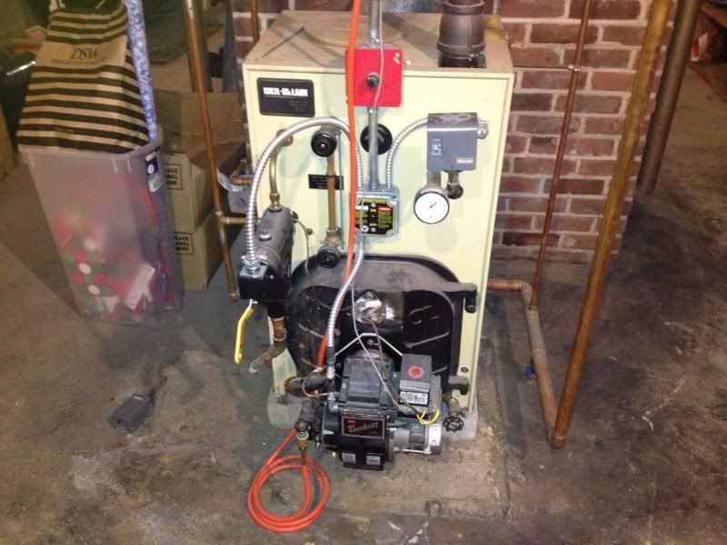

Question Tankless Water Heater -- Shower begins hot but becomes cold quickly
Hello everyone, I found this site after scouring the internet for a week looking up info. This site is by far the best I've seen so I decided to join. I have read many posts here but I have a couple of questions that I haven't found the answer to.
So here's the problem. We recently moved in to a home that has a Wells McClain boiler, we have steam radiators for heat and what I think is a tankless water heater because we don't have a tank. We use oil for fuel. The main problem is with showers not staying hot long enough. We turn the shower on and the water is hot for a minute before cooling off, so we turn up the hot water a little and it gets hot again for about 30 seconds to a minute before turning cold again. This process is repeated 3 or 4 times until we can't turn the handle any further and all we have left is cold water. The shower has a single handle faucet(I've heard this causes problems with tankless heaters). SO far what I've done is turn up the little temp dial on the side of the boiler. There is a little gray box on the left side of the boiler with one screw holding the cover on. I took that off and noticed a dial with temps on it. I assumed it was the water temp and turned it up. While this did help the water temp at first the radiators started getting really hot and heating the house up higher than our thermostat was set. It was at this point that I realized that I must have chenged the wrong setting and put it back. Next, I tinkered with my shower handle so I could turn it more to the hot setting, that didn't help either. THen I checked the shower head for a flow restrictor and didn't see one but ran the water without the shower head on to test the water temp. Still cold.

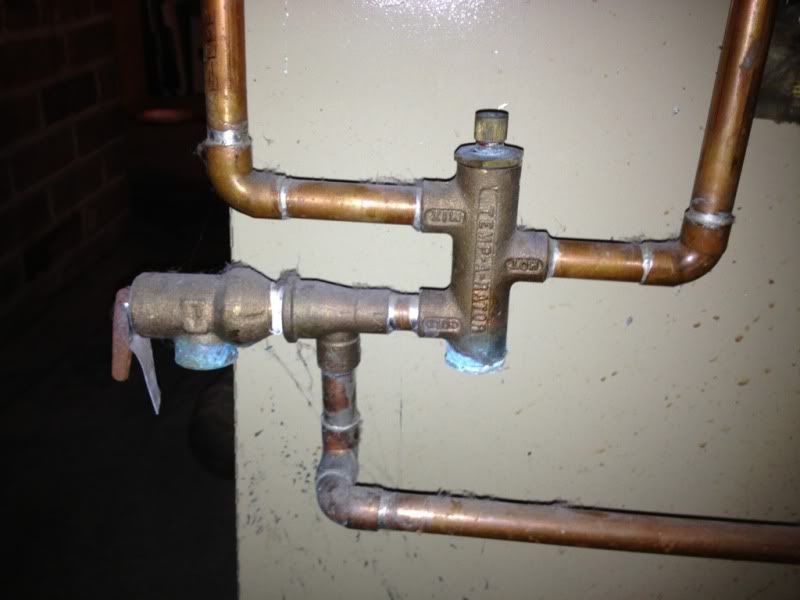

Last night I went down in the basement and I found the mixing valve which is set on 180. It's only a little brass knob and it only turns a quarter of an inch so I did not move that. Then I noticed that the pressure guage on the front of the boiler reads zero. That probably shouldn't be zero, right? One last thing I noticed. When we moved in they told us to drain the rusty water and refill the tank every week. We were told to use the little glass vial on the front to see the water level. The problem is the vial is so rusty I can't even tell what level the water is and/or whether or not it is full or empty. The last time I drained the water and re-filled it was around the time the hot water problem became worse. Could our lines have too much or too little water? Sorry for all the info, I just wanted to give as much as I could. I will try to take pics tomorrow night to post.

We need a model number off the boiler and maybe a bunch of pictures.
There could be a bad aquastat on the boiler.

Can you take a picture of it? Typically these mixing valves are set to 120.
180 is EXTREMELY HOT for domestic hot water, you can win a trip to the emergency room pretty easily. Young and tender skin, and elderly slow to react are most vulnerable, but ANYONE is in danger of SCALDING injuries!
Don't turn it until you get a pic and we confirm that it is what you think it is.

While you are down there taking the pics, take a look at your PRESSURTROL and tell us the settings on it.

Here is the link to the photobucket album. mdr411's Library | Photobucket

Mixing valve showing some leakage/weeping ... the green 'crud' gives it away. I'm not familiar with that brand... wonder if it is thermostatic or simply a fixed mixer?
You say that this is set to 180? (in your previous post) ... I don't see any temp markings...
Truthfully, I would probably plan on replacing it.

Well, I don't see any 'major' problems in the pics.
You will want to take apart and clean this gauge glass so you can see the water level:
Replacing the mixing valve might help the hot water situation, but after seeing the pics I don't have much more to add to my previous reply...

Oh and NJTrooper...about the mixing valve. See that little knob on the top? That has two little dots on one edge of the top that I assume is an indicator telling what it's set at. Around the base of the know are temps like 120 140 160 and 180. The two little dots are next to the 180 so I assume that's what it's set on.

I think the pics showed that this is an SGO model? Do you have the manuals? If not, go here, click the DOWNLOADS tabs and grab the manuals for the boiler.
SGO Oil Boiler | Weil-McLain | Product Detail

I can see in your photos that the pressurtrol is set on 0.5 CUT IN, and that's a good sign. Slide the cover off and tell us what the other setting inside the box is set to. Should be no more than TWO.

...about the mixing valve. .... The two little dots are next to the 180 so I assume that's what it's set on.
I think that mixing valve might be one of the first things... after reading the book of course! and cleaning up the gauge glass.
It doesn't sound like it's working properly.
5122-C1 - Taco 5122-C1 - 1/2" Series 5122 Low Lead Mixing Valve
AM100C-US-1 - Honeywell-Sparco AM100C-US-1 - 1/2" Sweat Union Mixing Valve

Upon further inspection of the mixing valve, I noticed that it does turn. At first it seemed stuck and I was hesitant to turn it, but with a little bit of pressure it turned. In an earlier post I said that it looked like the valve was set to 180...but the 120 and 180 mark are next to each other since the numbers are arranged in a circle. It goes 120, 140, 160, 180. I turned clockwise until the little dots lined up with the 140. It did make the water hotter when the shower is first started and it seems to last a little bit longer now. How high can I turn that knob? Should I still replace it?
Another thing that I did -- we have a Symmons Temptrol shower faucet so I was able to turn the water pressure down in the shower head with the lever. So now with the water pressure turned down and the mixing valve turned up it is more bearable to take a shower. Still not ideal though and we still have to continuously turn the knob to keep the water hot/warm.
Turning the mixing valve up is again, counter-productive. This means MORE FLOW through the coil, LESS CONTACT TIME in the coil.
The idea is to restrict the flow (within limits of course, there IS a 'tipping point' of diminishing returns) to allow the water through the coil to slow down with more time to get hot.

OK so I figured out the problem...low water level. Today when I came home from work the house was freezing and the boiler had shut down.
Due to the gauge glass being so dirty I could not see the level of the water. I had a feeling it had to do with water level since I've been worrying about that since we moved in, since I can't see the water level. So last night I said screw it I'm going to add lots of water to see if that helps. So I added more and more water until the boiler started up again. I held a flashlight to the gauge glass and after a while I could barely see the level rising through the rusty glass. It must have been really low because I think it shut down because of the float in that drain mechanism on the side of the boiler. It's like a safety right?
I think what was happening was that the water level was lowered to the point where the water wasn't coming in contact with the coil and that caused our cold showers. The poor heating situation in the home was because there was not enough water to make steam. Now we have the thermostat set at 55 and the house is warm because the radiators are working again. The people who lived here before us lost the home due to foreclosure so who knows when the last time the boiler was serviced and/or paid attention to. I have checked all of the pipes and don't see any leaks. I think this was a slow process and the only reason I noticed was due to the colder weather and cold showers.
I also looked at the pressurtol thing and it wasn't even attached to the screw! I think I fixed it by re-inserting the screw and adjusting it. I have no idea why it wasn't attached...so it should be on 0.5?

Any owner of a steam system MUST know how to run the machine and what routine mainenance needs done on periodic basis. You are lucky that the LWCO worked and eventually DID shut the boiler down on low water... BIG trouble you would have had if it had not worked properly. It's VERY important for you and your family's safety that these routine maintenance activities are understood and performed. A steam system is NOT a 'set it and forget it' heating system! You MUST know what needs to be done, and WHEN, and DO IT!
Not like a safety... IS a safety.

what looks like abestos insulation
If it is in fact the "A" word, and in good shape, it might be wise to consider 'encapsulation', or at worst removal and replacement with non-C..... material.
"Should be" is too subjective.
99.9% of residential steam heating can be achieved with 2 PSI or less.
I still want to know the setting of the dial INSIDE the PT... or did you already mention that?
0.5 PSI is the "Cut-in" pressure which means that during a heat call when the pressure drops in the boiler to a half PSI the burners will turn on.
The dial inside will determine the high end, or the 'cut-out' of the burners.
This should be around 1.5 - 2.0 PSI for the vast majority of installations.
If you can't heat your home with this amount of steam, there is something else wrong... usually a steam vent issue, sometimes a design problem.
The less steam pressure you run, the less fuel you burn. The difference is exponential as you increase pressure... not a linear relationship... so understand the controls and save fuel!
This is all covered in great detail in 'the book'.

The dial on the inside is set on 2 and the front of the pressurtol is set on 0.5. I have ordered the book and I'm looking forward to its arrival!

Excellent! It means that whoever had worked on this system in the past wasn't a 'knucklehead' and turned the pressure way up...

I believe I would start with double checking the settings on the control on the front of the boiler... have you told us what model that is? label on the inside of the cover?
Next, I would suspect that mixing valve...
Last would be acid boiling the innards of the coil.
