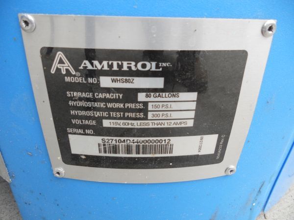

According to face place of Amtrol it seems OK, but i dont have the pictures of other side of the zone valve where the full model name is written and i am at work
I will check at lunch time and post here.

V8043F 1051 24V 50/60CY 32AMP

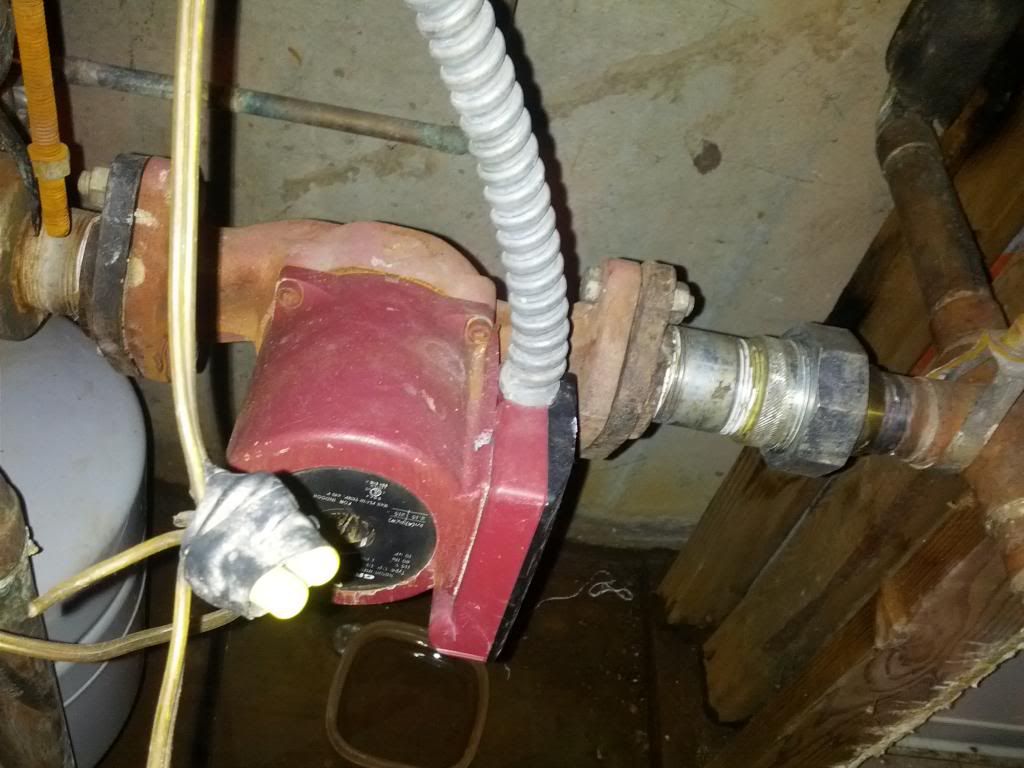

And if you put 120VAC on that valve, it would/should have let the smoke out of it... and possibly tripped a breaker...
Where exactly were you measuring 120VAC ... FROM / TO ?
From what I've seen, electricity is one of your possible 'nightmares'... for example:
One could easily swap a hot and neutral here... and this could lead to stray 120VAC HOT being applied to various parts of the system.

the 2 cables that goes to Amtrol controller. I will measure and take some pictures tonight again. But Amtrol itself says 115V and those are the only 2 cables that goes to Amtrol so i thought it was OK
I couldnt find the picture but there is a place where 10 end switch cables are come together and I know my system sucks at the moment That is why i want to do the entire plumbing in boiler room from scratch. This time i want to use some zone controllers for a cleaner setup.
As i said, it is 40sqft and i can barely walk in, and on the picture you posted, that dielectric union is the one that i replaced, where i needed to cut the wall to reach it. On Bottom right it is noticable.

Ohhh... those wires with the wire nutz and duct tape are not 120VAC?
It looked to me as if someone had used 'zip cord' or 'lamp cord' to wire up something...
OK, so if those are low voltage, it's not as bad as I thought. As long as there are no 120VAC connections that are done like that!
