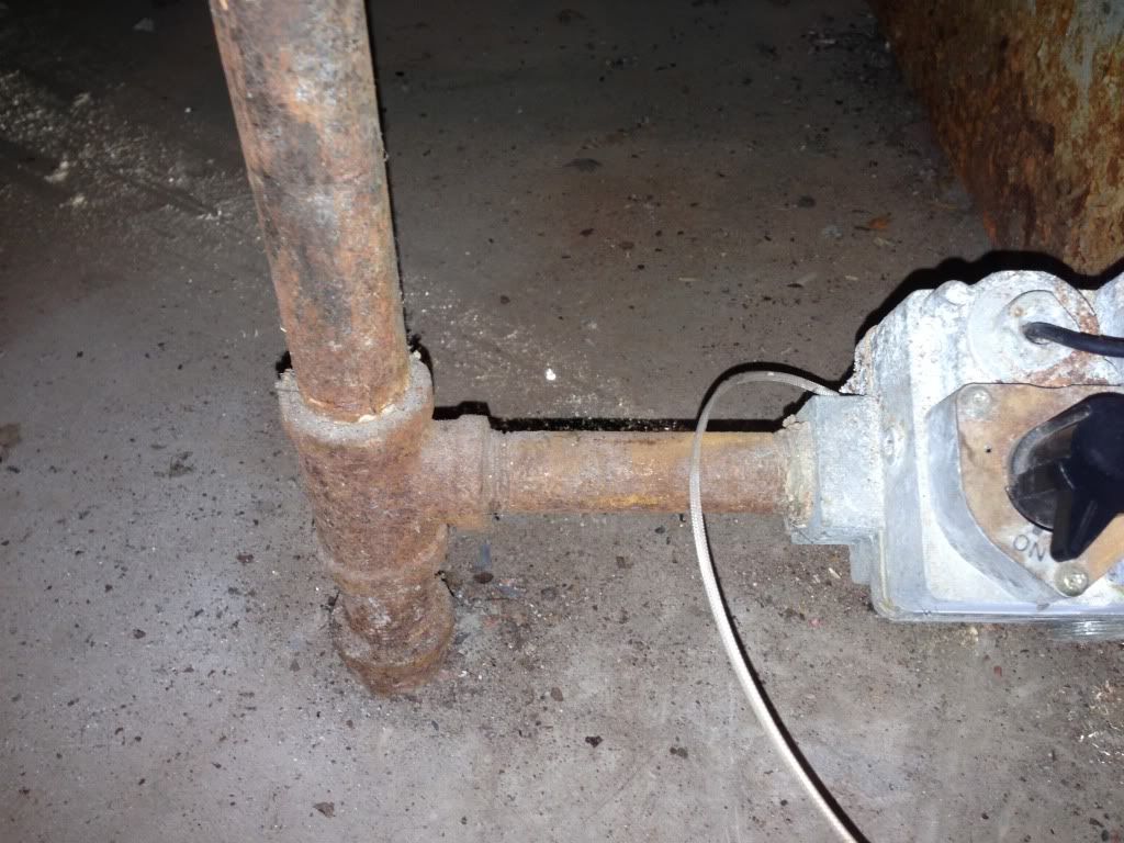

I have a very old (30+ years) Utica gas boiler (model PGB200). The other day the pilot went out and would not stay lit. We replaced the pilot assembly and it was working fine. Last night the pilot went out again, I relit it and the burners fired up and all was well. It went out again tonight, I relit it and it's working again.
I'm pretty sure the gas valve is going bad. I plan on replacing the boiler this spring/summer, but I would like to be able to limp along for the last month or two of this Massachusetts winter.
I know Utica does not make any parts for this model any more, but is there any way to get a replacement gas valve for this unit? I tried to get the model name and # off the assembly, but it was almost all worn off. The only thing I could get off of it was "Type 433". Here is a pic:
http://i1235.photobucket.com/albums/...t/BB574F40.jpg
Any ideas on where to get a replacement part?

30 years is not normally considered "very old" for a boiler. But, looking at the photo, has yours been flooded in the past?
The markings you found on the valve are generic. There is no reason to search for the same model. Just replace it with a gas valve that has the same dimensions.

Yes, the thermopile was replaced. The model of the existing valve is the 433 which is 3/4 by 3/4, but the the existing inlet is definitely 1/2 and the outlet is 3/4. I agree about the water damage. We haven't had any water n the basement since we have lived here (7 years), but there is a ton of corrosion on the boiler so there must have been some water damage at some point.
Here are some more pics.
D87071B9.jpg Photo by markmin1 | Photobucket
Inlet 1/2 Photo by markmin1 | Photobucket
Outlet 3/4 Photo by markmin1 | Photobucket
032AFFCC.jpg Photo by markmin1 | Photobucket

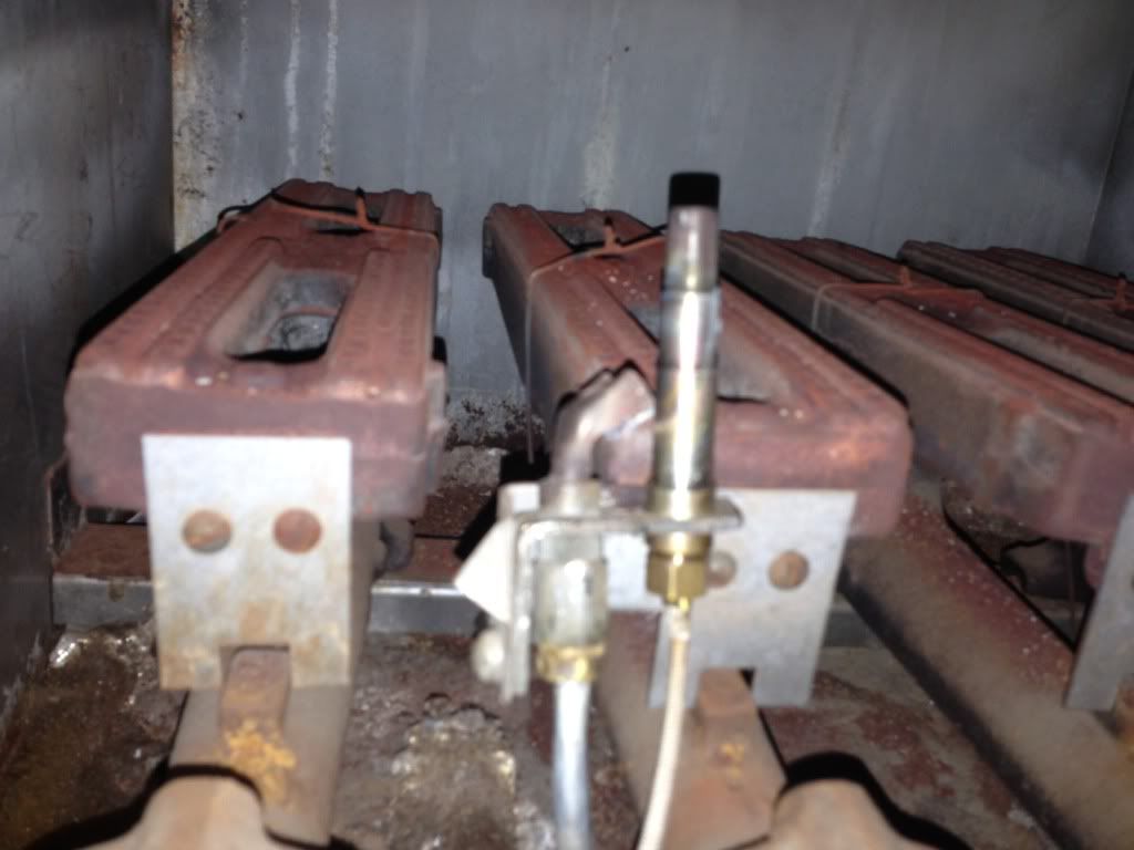

Mark, what are those wires wrapped around the burners for?
The condition of that gas pipe feeding the valve is a bit concering:
I think once one starts 'wrestling' with the pipe, the chance for gas leakage is pretty good.

Trooper I think those wires are the original shipping straps to hold the cast iron burners on.
Those burners just sit on top the arm I remember right. Mine are cast but a little different and part of the arm.
I guess that means that the burners haven't been cleaned in 30 years!

"I guess that means that the burners haven't been cleaned in 30 years!"How often do gas fired burners really need to be cleaned? I give mine a lick and a promise every couple of years or so, but not sure it's all that necessary.
Old 02-28-13, 07:17 PM
NJT's Avatar
NJT
NJT is offline
Join Date: Oct 2006
Posts: 23,539
Received 3 Votes on 2 Posts
Cast iron burners in that damp environment? Pretty often I would think, along with a brush down of the flue passages. It wouldn't surprise me to find that heat exchanger half plugged with rust flakes.
