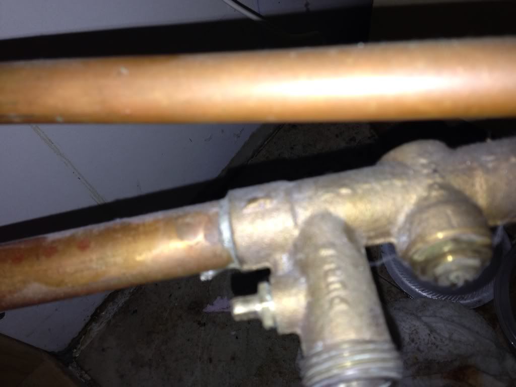

Can I ask a question? Did you do this? Reason I ask? I want to be careful I don't insult you.
Are you using these to purge the system with?
That pic is what Mike is referring to as a 'bleed station', I call them 'purge stations'.
Obviously the hose thread is where a hose goes and the valve to open and close the drain. But, the OTHER valve, to the right in the picture, is the one that Mike is referring to as the 'stop' [valve].
You probably need to CLOSE that stop valve in order to force the water to go through the zone rather than take the path of least resistance.
With your bleed station you are closing the stop right?

NJ Trooper, to answer your question (and lawrosa's) I am using the pictured valve to purge the system. However, I did not close the valve prior to doing so. I will try that and see if it works. If this doesn't work, I will try it using the circulators during the purging as lawrosa suggested. I will update you guys and let you know how it works out.
