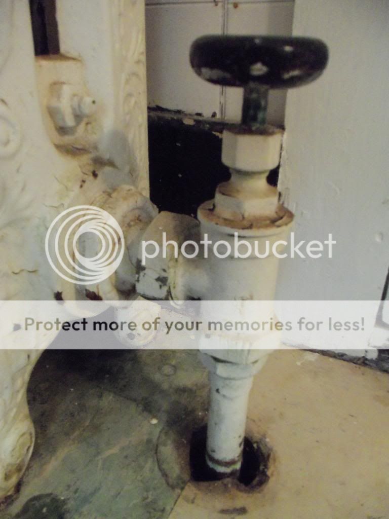

This is the stop and waste valve that I was going to close to isolate the radiator from the heating system:
I was then going to drain the radiator through the drain port on the stop and waste valve. I posted the picture in my previous post as a reference to my question: should I disconnect the radiator (after isolating it and draining it) before or after the old valve?

should I loosen the nut between the valve and the radiator or the nut between the supply riser and the valve?
Eventually, when we have more info as requested by lawrosa, to remove the rad you will loosen the nut between the valve and the rad, which is a union. But we need to see the add'l photos.
I agree with lawrosa, the chances of that old valve holding are slim. My guess is you are going to ultimately have to take the boiler out of service and drain to a level below the rad.
That valve looks new enough to hold - but there is another line somewhere leading to the rad. Slow down, and take about a dozen photos as suggested by lawrosa.

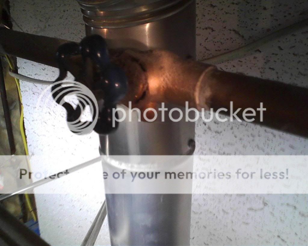

Here are a series of pictures of the line from the boiler to the stop and waste valve in the previous post. They are in series from the boiler to the run leading to the valve.

I did close the stop and waste valve pictured in a prior post and turned on the heat. Radiators got hot...except for the radiator in the bathroom. So, I have validated that this valve is indeed on the supply line to the radiator I need to remove.

Oh, I forgot to mention that, for what it's worth, the radiator I need to remove in on the second floor. So, no direct access to it from the basement. However, is seems apparent for tracing the piping that there is a separate feed to every radiator, first or second floor, from the piping in the basement.

Yes, that is true. So, I need to open that valve and shut what I believe is the valve on the return, then turn the heat back on, to determine if I have actually found how to isolate the radiator.

I opened the valve that I had closed in the previous test, then closed the valve I thought was on the return from the radiator. Turned the heat back on (which is a difficult thing to withstand in June). All the radiators got hot, except for the radiator in the bathroom. So, looks like I have isolated the valves on the supply and return of the radiator.
The valves I closed only isolate the one radiator. As I said, each radiator has it's own "circuit." (The pipes to each of the other upstairs radiators are visible as they run outside the walls on the first floor...it is a very old house....the original central heat was added years after the house was built).
So, if I close these two valves, drain the radiator through the drain port on the stop and waste valve, does anyone see a problem with removing the radiator while the rest of the system remains live?

Your pics are pretty crummy IMO and cant tell much...

Yes, the pics were crummy. My basement is very cramped and there are a ton of pipes (and wires). There was no way to get better pics.
My radiator removal was a success. Closed the two valves in the basement to isolate the radiator, then drained the radiator through the drain port on one of the valves (both stop and waste valves). With two borrowed pipe wrenches, the nuts on either side of the radiator came loose very easily. Piece of cake.
