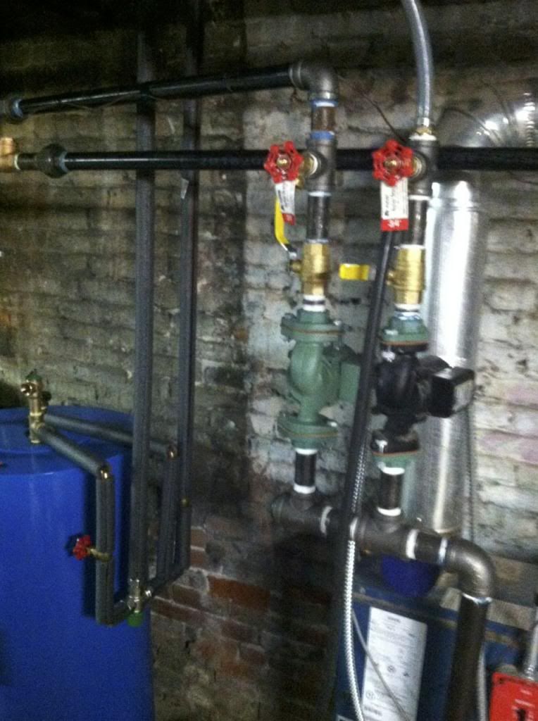

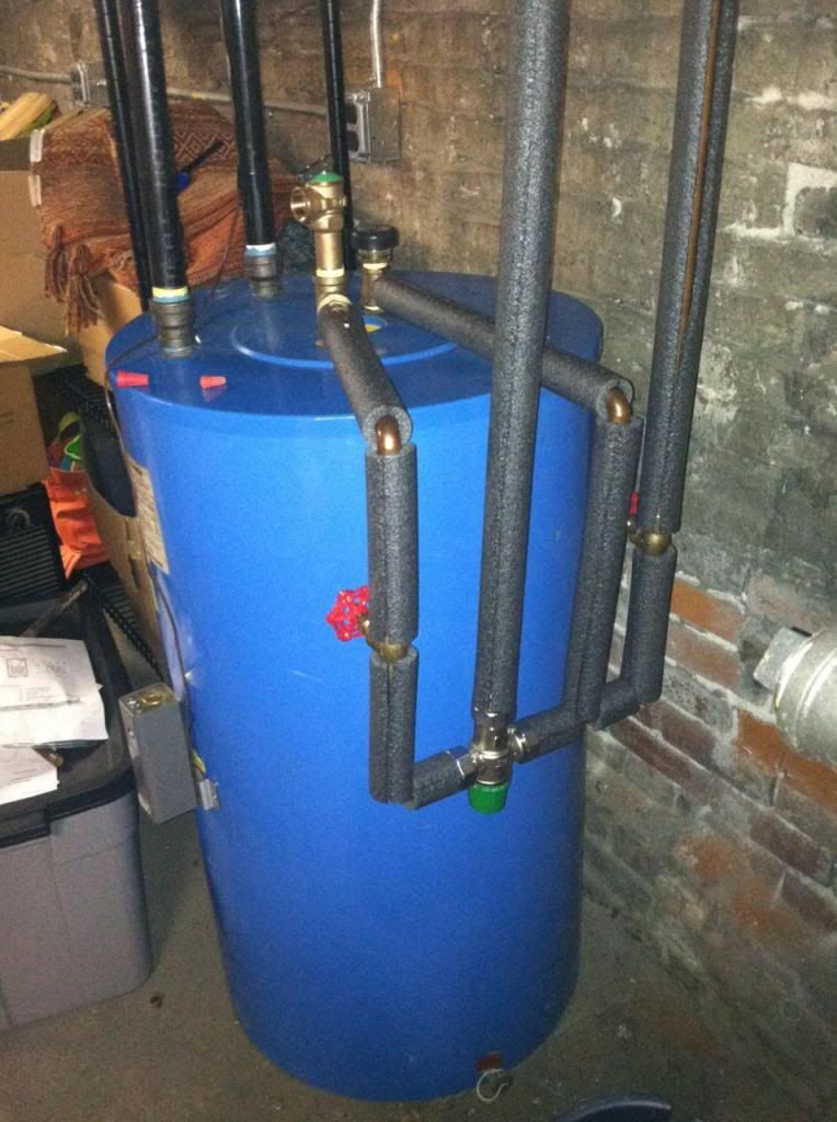

I figured I would post some pictures from the install, since someone might find it useful. Few notes: * T&P pipe wasn't complete at the picture time, but has been added since.
* I reused the boiler circulator but I didn't realize that it didn't have IFC built in, so there's some flow from the indirect to the heat zone(which actually kind of works out well as the bathroom is the first room there and it needs more heat)
* There's more heat migration from the indirect then I'd like it to be(even though there's heat trap piping) I suspect it's more due to expansion.
You may be right about the expansion. The heat trapping on my heater is much longer than yours, essentially going all the way to the bottom of the tank before turning and going into the crawlspace to the fixtures. I feel warm pipes on BOTH sides... the hot side is warm almost to the point where it turns horizontal, and the cold side is warm about 1/4 of the way down (of course only after it's sat with no cold entering the tank)
BUT, I doubt you are getting anywhere NEAR the kind of migration you would if the pipes were going straight up!

More appropriate way is to install a circulator with IFC. I have also heard that all taco 007 circulators allow adding IFC inside, but I do not know if that applies to black(boiler manufacturer supplied) pumps.
Is it even possible to purchase a replacement FC valve for the 007 ? I've never looked, or tried.

Taco 006-047RP IFC Replacement Kit for Taco 003-009 00R Circulator Pumps
All my new 007-IFC's are installed. I'll check papers later but iirc they discussed just popping out the IFC if needed. I don't know if my old 007's had what must be a groove for the O-ring to sit/snap in.
Speaking of expansion- I don't see in the pics a potable water expansion tank on the cold water side feeding your indirect. If you don't have it, you want to get it!
If there is no check valve the pressure from the tank heating will be absorbed by the city supply.
MOST of the newer water meters DO have built-in check valves.
If on a private well, in general, the well system's pressure tank has the capacity to absorb the pressure from the water heater.
It's never a bad idea to know what the domestic system's pressure range is... could check it, just to be sure, with one of those screw on the hose bib gauges with a 'lazy hand' that will record the highest pressure it sees over a period of time.
