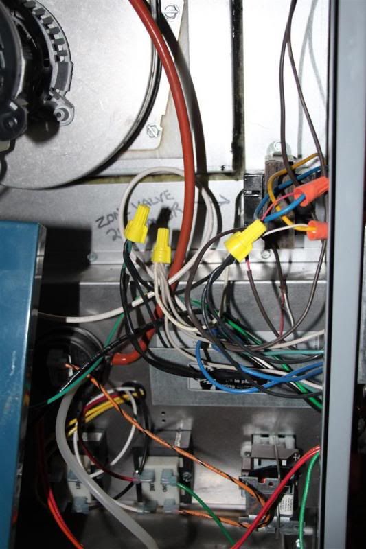

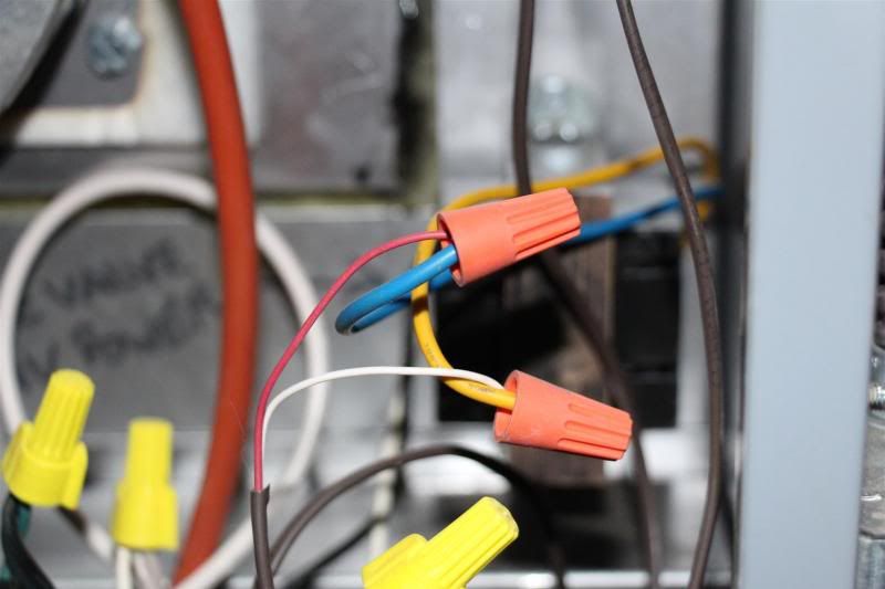

Ok, here are some crappy pictures. It was really hard to get them because of the way it is situated. I will try my best to explain:
This first picture shows the transformer (in the background) and the blue and yellow wires attached to the thermostat wire)
Here is a picture of the zone valve wiring (I couldn't figure out the make because of the way they are mounted):
So in the zone valve wiring I think the transformer goes to the lower left and lower right lugs (which were labeled TH/TR and then TR). Then those were jumped to the two other zones.
The wiring from the terminal block on the boiler went to the top two lugs labeled END SWITCH and were jumped to the other two zones were jumped from there.
The thermostats were wired to the two bottom left lugs (TH/TR and TH).
If it IS one of those two transformers, why is it not connected to the boiler terminal strip as shown in the wiring diagram?
When you say "...attached to the thermostat wire..." does that wire actually go to a thermostat?
The zone valve wiring appears to be correct, the only thing I'm still not clear on is where the transformer that powers the zone valves is located.
I need to be clear on this because it has everything to do with where your " C " wire is going to connect to the new thermostat.

That transformer pictured in the background also has a black and white white going to L1 and L2 at the boiler terminal block. And no, that thermostat wire doesn't go to the thermostats, I just called it that because it looks like it is just thermostat wire.

OK, but I'm still not clear... not a definite answer.
Understood that the primary of that transformer comes from the L1 and L2 120VAC supply.
But, is is one of the two transformers shown in the boiler wiring diagram?
Or is it a THIRD transformer that was added to power ONLY the zone valves?
The blue and yellow wires come directly out of that transformer, stopping NOWHERE ELSE, are connected to that red and white 'thermostat wire', then go the TH/TR and TR terminals of one of the zone valves...

Yes, correct, those blue and yellow wires go nowhere else. They added that third transformer specifically for the zone valves apparently. Here is a picture where you can see that they wrote in permanent marker and it says "Zone Valve 24V Power" with an arrow pointing to it (you can also see the other two transformers).
OK, that's the answer I was looking for!
Now that's out of the way, the actual answer is easy.
The " C " wire for your thermostat will connect to the " TR " terminal of your zone valves.
