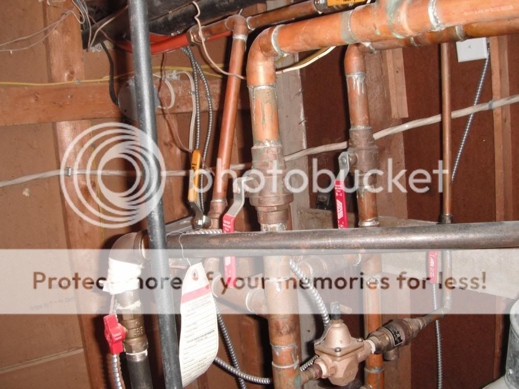

Before you proceed with this process, shut off the boiler and allow to cool to 100F or less.
In this pic:
You see that ball valve to the left of the drain that you have the hose on?
When you were bleeding / purging those radiators, did you CLOSE THAT BALL VALVE?
If not, do it again with the ball valve closed. If you don't close that ball valve, the water will never be persuaded to travel through the zone. It will take the shortcut through the boiler and right out the drain.
With that ball valve CLOSED, and the drain OPEN, LIFT THE LEVER on the pressure reducing valve in this picture:
It's the bell shaped valve at the lower right center. When you lift that lever water will travel FASTER and push the air out ahead.

Just to make certain though, is the ball valve you are reffering to the one that is on the same pipe as the drain? Or are you referring to the red valve which is up higher?
Also, what is the best way to bleed/purge the rads?
After closing the valve and getting more water in from the pressure reducing valve, should I then go to the radiators and bleed them through the bleeder valves that are on them? Or is there another way that might make more sense?
Thanks for all your time on this.
Eric
Old 12-03-13, 01:02 PM
NJT's Avatar
NJT
NJT is offline
Join Date: Oct 2006
Posts: 23,539
Received 4 Votes on 3 Posts
Yes, the one on the return pipe just to the left of the drain, yellowy-orange handle, not the red one.
After this, you may not have to bleed them. Should work 'out of the box'.
I might not have explained myself well enough...
When you close that yellow handle ball valve, and open the drain with the hose on it, and lift the fast fill lever on the pressure reducing valve, you will be forcing water through that zone and any air in the zone should be pushed out ahead of the water.
This is a PURGE, rather than a BLEED, there's a fine semantic difference.
PURGE is BLOWING OUT THE ZONE with fresh water, BLEED is a little piddle out of air bleed valves.
After you PURGE the system and it heats up HOT again, you may get some air out of the bleeders since heating the fresh water in the system will force the dissolved air out, so for a day/week/month after doing this you may want to vent the bleeders a few times. This should restore heat to the non-heating rads though.
This won't help the other non-heating rad, but should take care of the two at the rear of the house.

Ok I've got it now purge from the drain on the return pipe .

Hi, so purging worked!
I purged for about 20 minutes and now the 2 radiators toward the back of the house are kicking out heat. Thank you!!
Unfortunately though it's about a 1/3 the heat the other radiators are putting out.
I think that might be because the other rads are supplied by 3/4" copper or even bigger threaded steel, and because those radiators are further away. Does that make sense?
For the other radiator there is no other purge station. The only other one is at the supply for 2 rads at the back of the house.
Let me know if you come up with anymore ideas!

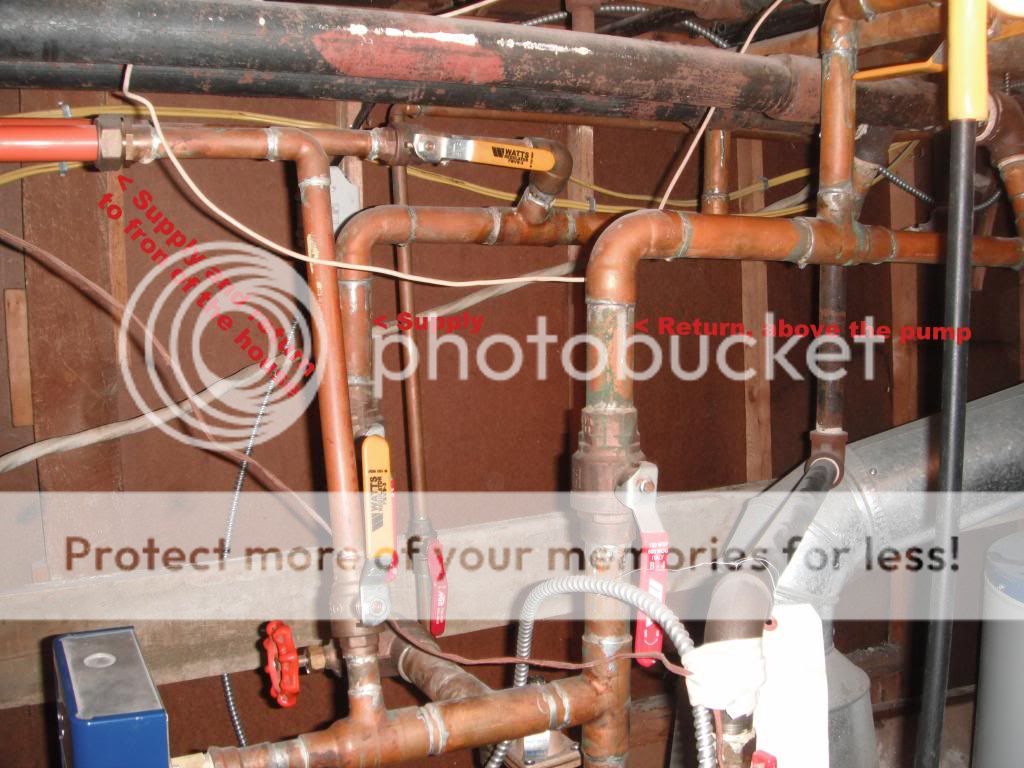

Further to what I suggested about closing off the other rads so full flow can go to the one rad...
In this picture...
It appears that you can close that RED HANDLE BALL VALVE on the RETURN line and that this will give everything the pump has to that front radiator loop.
Run the system, get it hot, and while the pump is running, quickly open and close the yellow return valve from the front rad. This might cause the pressure surge when you open it to break the bubble loose... sorta like rocking a car stuck in the snow...
But something else I noticed... say you DO break that air loose... and it comes back to the boiler... what happens to it then?
I just looked at all the pictures again, and I saw no sign of ANY kind of an AIR SCOOP, or AUTOMATIC AIR VENT anywhere... is there any such thing on your system?
If not, then even if you bust that air loose in the front radiator, it will travel around the system and get stuck somewhere else.

One more question about the previous pic.
See that round red handle valve? What position is that valve in? Open? Closed? Part way between?
That's a 'system bypass' valve and if it's open, while you are trying to get flow in that rad, close it, but count the number of turns it's open and return it to that when you are done.
I'll explain that valve's purpose at another time.

Hi again,
Sorry I didn't get back in here yesterday, I had kind of a crazy day at work.
So the radiators at the back of the house I thought were working, turns out they aren't anymore.
Regarding the bypass valve, it is all the way open.
In response to your question about the air vent I am not 100% sure what I am looking for. Would that look like an automatic bleeder valve?
Like one of these guys?
Caleffi - Catalogue - the widest range
Where should that go on the system?
Going forward I think I am going to try a stronger pump.
And maybe put in an air vent...
Eric
For the time being, close it. See if you start to get heat in the cool rads.
Did you try the tricks with the front radiator yet?
This is a 'SpiroVent' brand combined air scoop and eliminator.
VJR100 - Spirotherm VJR100 - 1" Spirovent Jr. Air Eliminator (Threaded)
A cheaper alternative is this:
431-6 - Taco 431-6 - 1" Air Scoop
On top you would mount one of these:
MO67 - Jacobus - Maid O Mist MO67 - #67, 1/8" Auto-Vent
There is simply too much info to explain I think
Yes... it's a lot. What really needs to happen down there is to let someone loose with a Sawzall, cut out that jungle of piping, and repipe it all in a sensible manner that works. It's just way too 'organic', like someone threw some pipe and tubing seeds down there and they sprouted and grew every which way...
I was hoping that it would at least WORK after it was purged... maybe not perfect, but at least work... but I'm losing hope.
