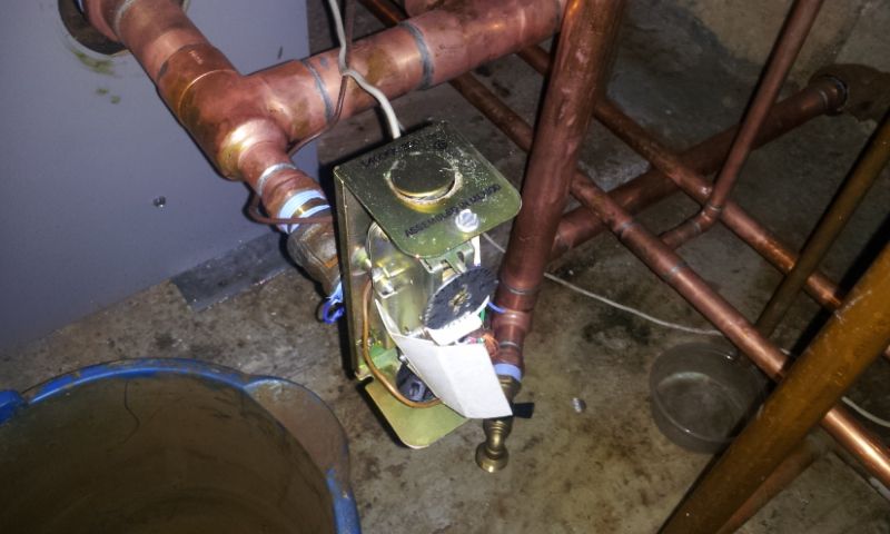

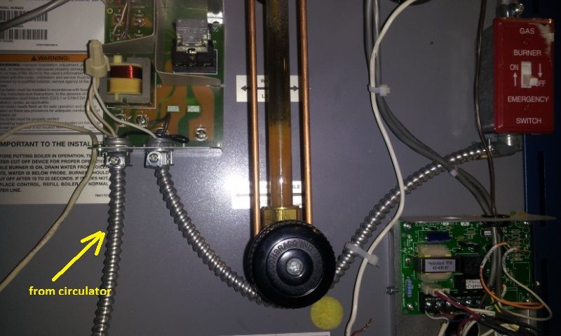

Hello and good afternoon. Forgive me if this post is in the wrong place, as my question is electrical but relates specifically to the wiring of a stem heat/hot water system. I posted on here a while back about an issue with my boiler short-cycling when there was a call for hot water. Well, the boiler ended up cracking and I just had a new one installed and wired to an Amtrol Boilermate for our domestic hot water. Here is my best shot at a diagram of the wiring:
The issue I'm having is that when there is a call for hot water, the aquastat does not turn off the burners once the temperature setting is exceeded. The boiler runs until the setting on the Amtrol is satisfied, even if that means steaming up the radiators. Not a major issue this time of year in NJ, but in the summer it will be. Based on how it's wired, I think the only thing the auqustat is doing is keeping the boiler in a certain temp range when there is no call for heat or hot water - Pointless really, as we never have an issue with hot water coming up quickly enough. So, my question is, how should this be wired such that the aquastat kills the burners (but not necessarily the circulator) once it senses a temperature that exceeds the setting. I'm thinking that the answer should be pretty simple, but I want to check with you all before I start messing with things. I am also not quite sure how the circulator is wired into the relay (hence the question marks in my diagram) but I can look more closely if that is relevant/necessary info.
Here are some additional pictures of the setup:
Notes: I have temporarily disconnected the aquastat's connection to the thermostat wires so the boiler does not fire when there's no call for heat or HW. However, now when there is a call for hot water the circulator runs, but not the boiler. Also the aquastat is Honeywell SKU #L4006A2007. Relay is a Honeywell #RA832A.

Can you describe the wiring at the aquastat? and tell us the temperature setting?
In other words, the two wires that are coming from X X in the relay, what are they actually connected to at the aquastat?
Then you say there are two wires leaving the aquastat and going to the 'thermostat'... what control are you referring to as the 'thermostat'?
What terminals in the aquastat are those wires to the 'thermostat' coming from, and what terminals in the 'thermostat' are they landing on?

I hired someone to install it. No way I'd attempt that myself. I do not know why the water in the glass is so dirty, and was wondering that myself. The contractor said they did everything they needed to, so I would hope they skimmed the boiler. The pressuretrol is Honeywell model # PA404A1074
Here is a bigger picture:
Boiler is Utica PEG150IDE. The temperature setting on the aquastat has been all over the place as I'm playing with it trying to figure this out, but basically with the heat shut down at the main upstairs digital thermostat and with the Boilermate turned all the way down, the boiler will fire up and shut down just by turning the knob on the aquastat. The two wires from the XX in the relay are going to the two terminals in the aquastat. There are only two terminals in the aquastat.
Each terminal of the aquastat has two wires connected to it. As you mentioned, the XX wires from the relay, and then one more separate wire from each terminal which is connected to what I referred to as the "thermostat". I meant the thermostat wires that my main house thermostat is connected to which tell the boiler to fire if you touch them. It looks like they are housed in the LWCO:
In other words, each of those blue wire nuts has three wires in them (I decided to reconnect the aquastat and crank the setting all the way down). The wire connected to my upstairs digital thermostat, the set of wires coming from the aquastat, and the two wires that you connect the thermostat to if you install a boiler or a new thermostat.

The solution to your constant firing issue is quite simple really. Your installers F'd up.
You should NOT have 2 wires on each aquastat terminal.
That aquastat needs to be in SERIES with the signal from the X X terminals on the relay, NOT in PARALLEL with it.
Find a small wire nut.
ONE of the X X wires goes to ONE of the aquastat terminals.
ONE of the 'thermostat' wires goes to the OTHER aquastat terminal.
The OTHER X X wire is connected to the OTHER thermostat wire with the wire nut and tucked inside the control box.
Going by color codes on your drawing, one each of the RED on each aquastat terminal, the two WHITE connected together with wire nut.
Set the aquastat to 180F with say 20° of DIFFerential.

Ok, I can't help myself from fussing with it. I re-wired the aquastat as described, and it works exactly as I'd hoped (THANKS!).

#21
You can use your aquastat to run the boiler instead of the t-stat.
Putting a jumper across the X X terminals in the relay would result in the boiler being held at the temperature of the aquastat while skimming! Perfect!
I wonder though, without circulation, if the boiler would REALLY be at 180 because of the location of the aquastat, or maybe it would be higher and start to steam... so if that happens, just turn down the aquastat a bit I guess...

Ok, that makes sense. I want to do something, because the water seems pretty oily:
Actually DID clean the gauge glass just about two day ago, and installation was only on Tuesday.
It looks also like the valve is in fact a 3/4:
Maybe I just need to try again and/or for a longer time. Otherwise, is it as simple as twisting off that 3/4 valve with a pipe wrench, skimming, and then wrapping it in thread tape and sticking it back on? I do not have any experience with pipework...
When it comes to draining from the bottom, it looks like there are four options, and I'm wondering which would be best best to use:
#24
I don't like that fitting for skimming (the way it 'funnels' down) but you don't have much choice, do you?
You don't need more than 2 wraps of tape, more is NOT better. But chances of a leak there are pretty remote, water doesn't get that high normally, and steam pressure is only like 2 PSI.
Two looks like more of a drain for the 'wet return' than a blow down.
One already has a hose on it? Where does that go?
I guess either 1 or 4...
What does Spott think?

Unfortunately it looks like he never skimmed it. Your gauge glass is horrible. That is oil from when they made the castings. All that oil hampers the steam from getting out of the boiler to the rads.
There's no real reason to take the spigot off, it's the same size as the part it's screwed into.
Lastly, you don't want to drain from the bottom until this is taken care of.
What happens when you drain from the bottom is as the water drains down the oil in the water just sticks to the walls again, and then when you refill it's lifted off again. It's counter productive.
That's why you must skim from the top. With the small opening it will take longer but be patient and it will happen.
You don't have to do it all at once.
Remember "slow and steady wins the race". That's what's nice about doing it yourself.

Awesome. Thanks guys. I'll try skimming it later this evening or after work tomorrow. If I'm hearing you correctly, there's no real benefit to twisting off that valve - Just open it up and be patient.
The valve in the back labeled #1 has a hose on it because I was going to try draining from there, but decided to check here first. You might not be able to tell from the picture, but #4 is actually much lower to the ground. Was just concerned that with it's proximity to the circulator, I might not get a good flow.
I will worry about skimming (and insulating) first and then draining. I just cleaned the glass again and it's supposed to get down to 18 degrees here tonight, so if I don't get to it until tomorrow it will be interesting to see how bad the glass gets. Will try to remember to snap another pic.
Thanks again. Can't tell you how much I appreciate the help.
Chris
Chris
