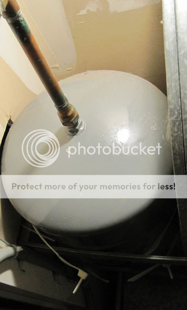

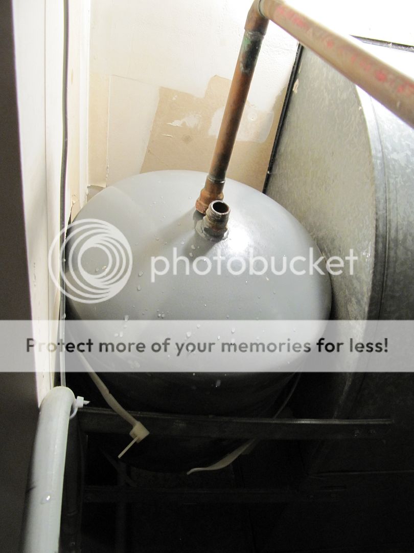

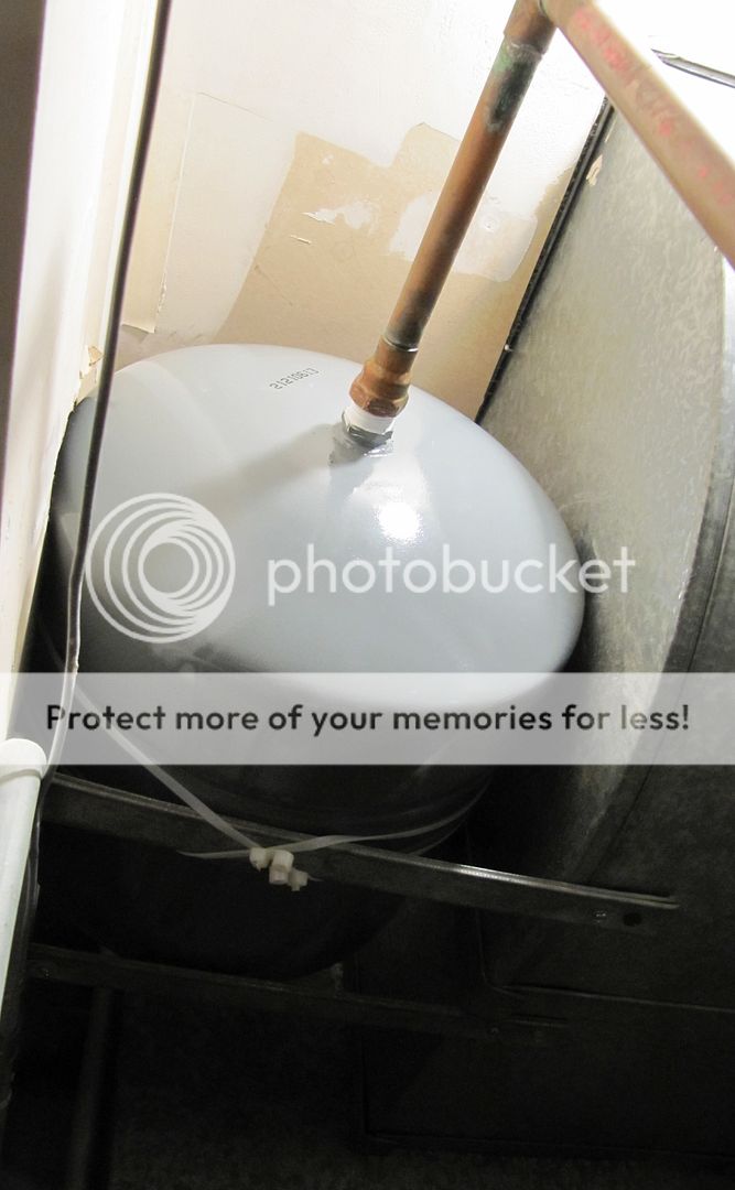

Score!!
The local plumbing supply store had the #30 Extrol tank in stock.
Time to jettison the old tank.
I shut the main water feed to the system off and drained enough water to get a ZERO pressure reading. I also closed the return valve (I think) - not sure if that was needed, but I wanted to cut off any gravitational water feed as well.
Removing the old tank wasn't much fun. I knew loosening a 20-yr old fitting wasn't going to be easy, so overnight I wrapped the joint with a vinegar-soaked paper towel. Used two wrenches as advised - one to hold the copper pipe fitting still and one to spin the old tank off.
As NJ Trooper advised it could be very heavy and that it was. I figure there was three gallons of water in it. As soon as I pulled the copper pipe off, water started to pour out fast. I filled a small bucket numerous times before enough water was purged. This really helped to lighten the load though. Then I had to wrestle the damned thing out of that fricken cubby hole. Ugh.
http://www.youtube.com/watch?v=7yLlOcLxJyw
New tank installed. As advised, only wrapped Teflon tape over 3/4 of the threads (leaving the first couple threads bare) and only wrapped the pipe with two turns of tape.
The tank was preset to what I believe is 15lbs of pressure. Measured this with my bike pump. I'll remeasure with my tire gauge later. Anyway, I repressurized the system and fired it up.

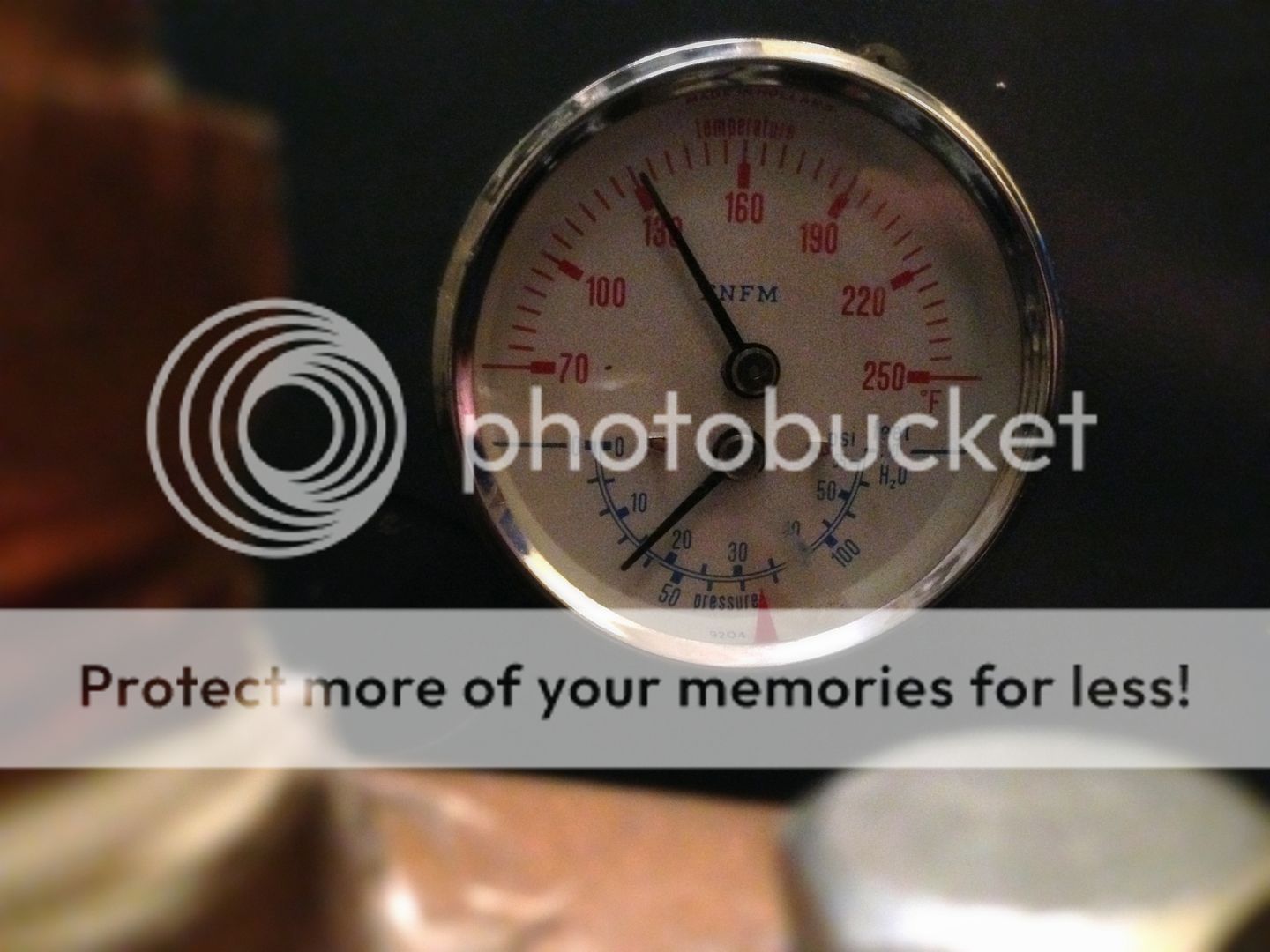

Cold reading:
Hot reading (the aquastat is set at 170):
No leaks at the tank union so far. I still have knocking noises in the pipes, but my old expansion tank was definitely dead. I do not have any water dripping from the PRV now and the hot system pressure seems to be running comfortably around 21-23lbs.
Look good?

Look good?
Sure does! See that, and you almost threw in the towel! I knew you could do it!
Pressure is a TAD, a WEE TAD, higher than I might have expected, but I suppose you may have a bit more water in the system than some.
OR, that gauge could be slightly suspect.
Now, what are we going to do about the noises?

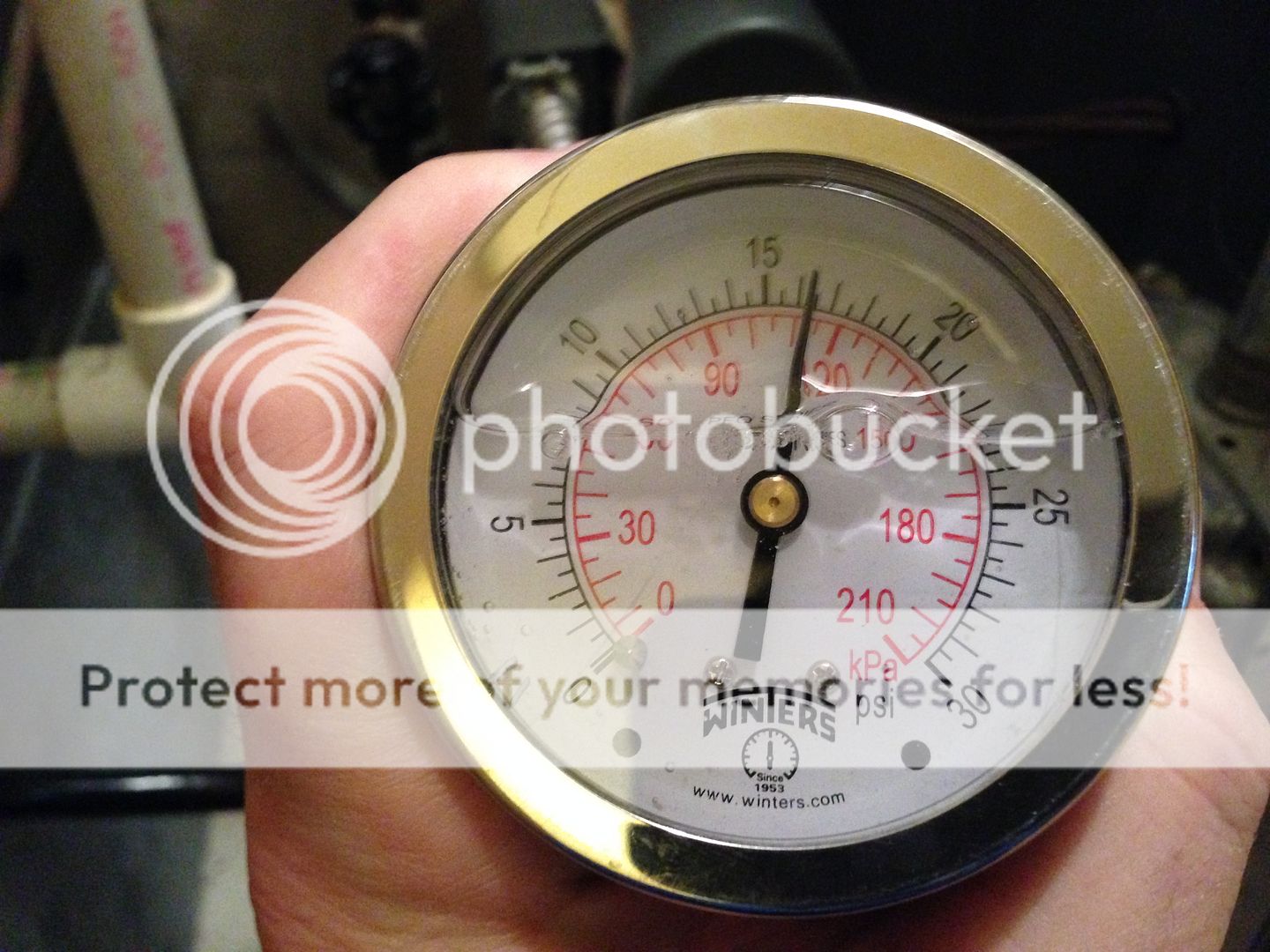

Got my Winters pressure gauge. It's solid....and yes, the 1/4" connector is on the back.

Just got confirmation that my Spirovent is at least 15yrs old. Debbie @ Spirotherm was very helpful. I can replace the head with part number PJR000HA.
Now while I was taking pressure readings on the expansion tank and while I was hooking up my pressure testing jig to verify the installed temp/pressure gauge, the Spirovent sneezed!! So maybe it's not as bad as I thought. I'll give it a week or so and see what happens.
Using a tire gauge to measure the expansion tank gave me a more accurate reading. I measured 13psi following the instructions in the sticky.
My installed pressure gauge appears to be fine as it matches off very closely to my pressure test jig.
Here's what makes up my pressure testing jig:
1) Winters PFQ Series 0-30 psi Liquid Filled Pressure Gauge
2) Anderson Metals Brass Garden Hose Fitting, Connector, 3/4" Male Hose ID x 1/4" Female Pipe
3) Six foot washing machine hose similar to this one (I got mine on ebay for $8 and free shipping)
  #54

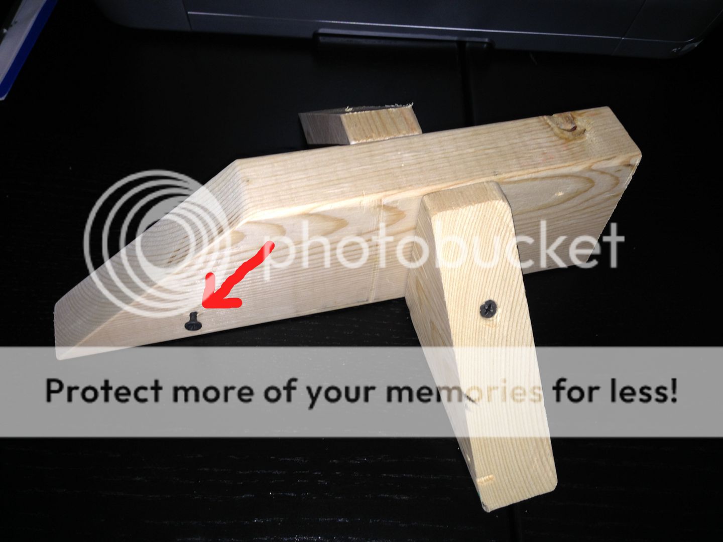

I've been thinking about what tool I would use if I wanted to open those holes up... the least dangerous to the pipe... and I decided that one of those 'oscillating' saws might be the best bet. Very easy to control. Use a 'plunge blade', a narrow one, and carefully cut away the restrictions.
Oscillating Multifunction Power Tool
  #55
Old 12-06-13, 05:48 PM
Join Date: Nov 2013
Posts: 66
I have one of those oscillating multi-tools and they aren't as stable as they appear. It's not a bad idea though. Thanks.

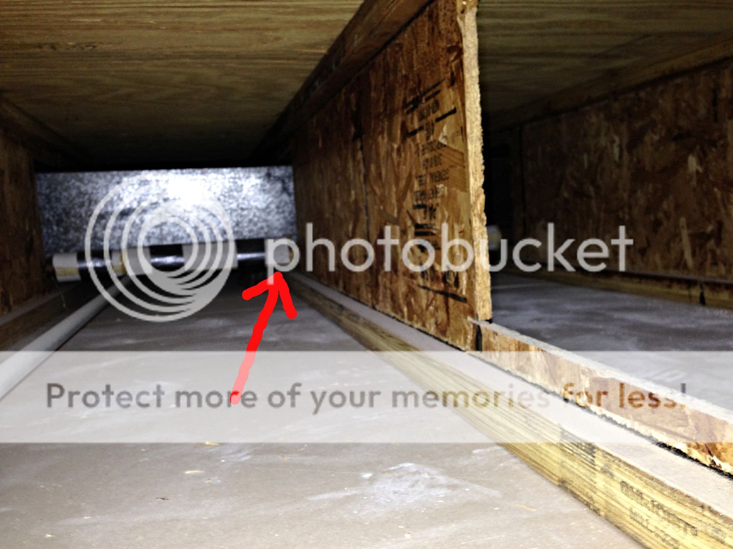

We're in a real deep freeze in Chicago right now, so the heat is working a lot and it's pretty damned noisy. The pipe tapping happens every time the boiler kicks on and it happens in BOTH zones. It seems like after the boiler has been on for like 10 minutes or so, the noise stops for the most part, with only an infrequent knock here and there. Then when the boiler is off and the pipes are cooling, there is some more noise but not as bad as when the boiler initializes. Does that make sense?
I do not get a lot of noise from the pipes under the baseboard covers. In fact, they are pretty quiet...very quiet actually. The noise is definitely originating within our walls and floor/ceiling. This i'm positive of.

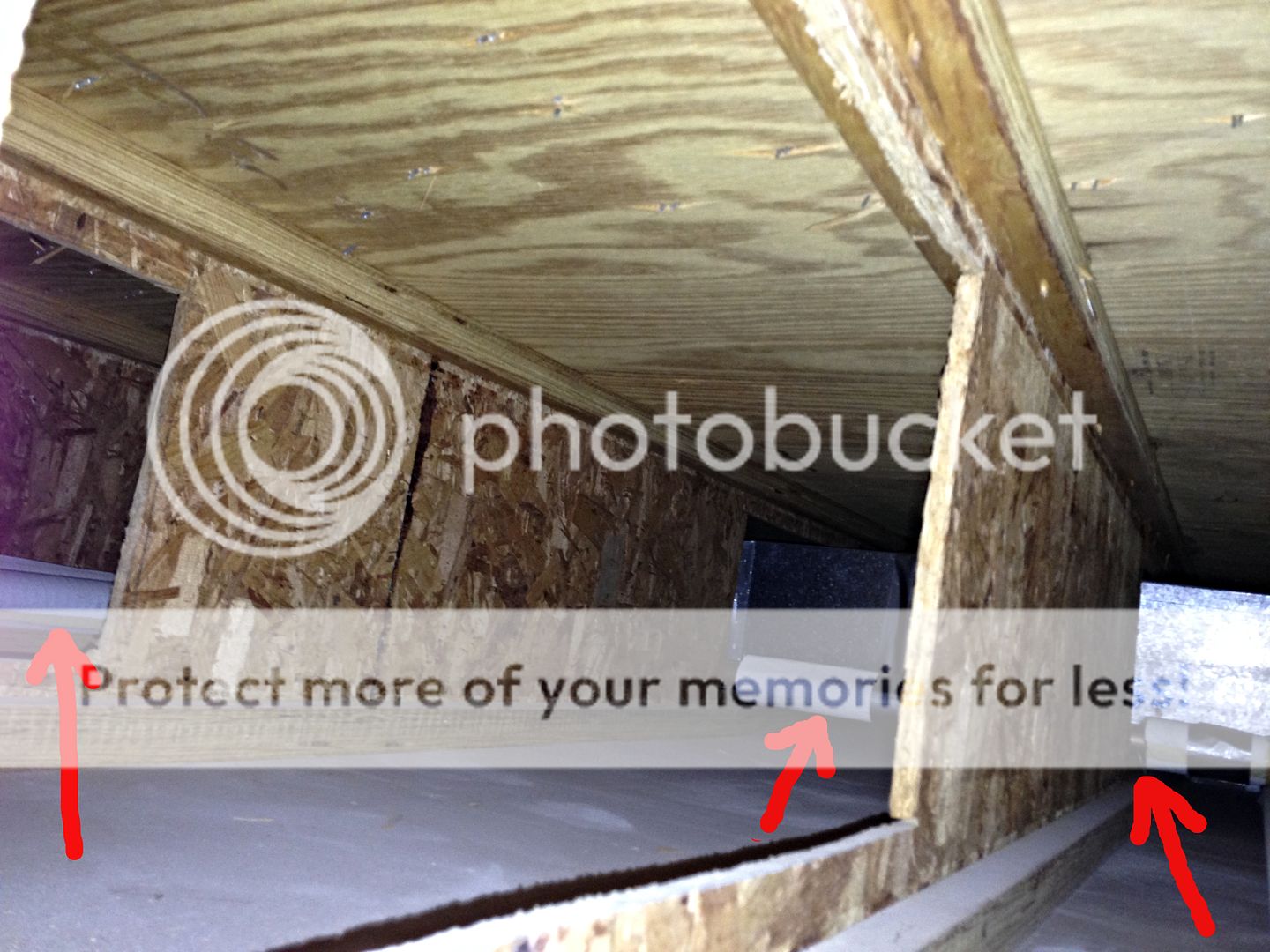

I have no clue where the embedded pipes run. I can only guess from their entry points into the walls/floors. The noises are concentrated on both ends of the house with not much noise in between. The boiler is located almost in the center of the house in the basement.
Does any of that information help? I'd really like to narrow down exactly what the friggen problem is because there's no way i will go the whole winter season with this noise. It's 18 degrees F right now. It will get colder and I can only imagine how effin noisy it will get. It's like a drumline inside our walls/floors/ceiling when the boiler kicks in. Arrrrrrrggggggg.
There's no way the heating system was like this the whole time. Nobody could live with this noise season after season and the prior owners lived here for 17 years!! Before them, the actual builder of the house lived here for the first 3-4 years.
Any thoughts on this? What typically would be done to isolate the problem? Will I have to cut into the basement ceiling to view the actual pipes?
Sure it does. Exactly what I would expect from expansion noises.
Know anybody with a 'snake camera' ? A small exploratory hole is easier to patch than a big head sized one.
Unfortunately, it would seem that at least some exploratory surgery might be required.

Exactly. And the boiler has been working properly -- firing up to 170 on the temp gauge.
One thing I noticed that I don't understand is sometimes the zone valves close before the boiler even hits 170. I don't know if my thermostats are working properly or what (they also are 20 years old). Seems to me that the zone valves should stay open a little longer and circulate the hot water even after the boiler cycles off?? It doesn't seem to be running efficiently to me, but what do i know?
Anyway, yes, the auqastat is set to 170 and I have been monitoring the "hot" reading on the temp gauge and it lines up well.

So before I start cutting into my ceiling, I removed two recessed light fixtures and stuck my camera up in between the ceiling drywall and the underside of the main floor to see what's going on up there. This particular area is the where the expansion noise is really bad.
It appears pretty evident what's happening. I can't see any hangers for these pipes. The pipes are wrapped with fiberglass insulation, but at the point where the pipes pass thru the braces there is contact on the actual pipe. It may be hard to see in these pics but I plan to take more in the next few days while I drum up some sort of plan.
I'm open to suggestions. I was thinking of wedging in small lengths of 2x4s under the pipes (where they are wrapped with insulation) to lift them up just a tad so there's no contact with the joists/supports. I don't know how I will reach the spans of pipes without cutting new holes. From this first vantage point, I'm not close enough to stick my arm in the hole and touch the pipes.
I also thought about blowing insulation up in there, but something tells me that's not a smart idea in case I need to access this space in the future.
Help......!!

I think I'm about 100% down with your diagnosis! I can absolutely see how those pipes could be acting like big bass fiddle bow and 'playing' those joists.
How to fix it though... hmmmm... have to get creative here I think!
I am a bit concerned about those HUGE cutouts in the joist webs though. Why on earth would they do that? They've probably weakened those joists to about 10% of their original strength. How much 'spring' is in the floor above?

Thanks for the affirmation.
I will be taking the other recessed light cans out to have a peek-a-boo in the other two-thirds of the room over the next few days.
If you look towards the "back" of the pictures, you'll see some duct work passing thru similarly sized cutouts. To me it looks like they made a few too many duct cutouts. Further down in the room (out of sight in these particular pics) there is much more duct work, which if extended, would actually pass thru the holes you see in the above pics. But yeah, you’re right – that’s a needless waste. The floors above this rec room are solid though. No complaints there. I suppose it could be worse. At least they “windowed” the cutouts. If they were completely cut thru, it would probably be a code violation or something.
I’m curious myself to see the construction further down. I will share pics when I take them.
I really need a light bulb moment here. For now all I can think of is to use short lengths of 2x4s under the pipes in between the joists….just to prop them up like a half inch or so. I will need to figure out how to maneuver the 2x4s under the pipes from these recessed light holes though. I really don’t want to cut new holes in the ceiling since patching that stuff up is a major PITA.

The other thing that is mind boggling is how in the world could people have lived here for 17 years and put up with this noise every winter!?!?
These SlantFin systems are supposed to be silent when they are properly set up and maintained. I love the type of heat they throw out -- definitely better than GFA, but the noise....THE NOISE!!!!
I'm actually kinda surprised they passed as is! I think there's some kind of 'percentage' rule as to how much of the vertical web they can cut out on those.
I saw the other ductwork and figured they were cut because of a "duhhhhhh, ooops! moment" by the HVAC guys.
Hard to judge how far you need to go... but of course you can't get a long length of 2x4 in there so you'll have to use short pieces. You might be able to get a much longer 'push stick' in there though and maneuver the 2x4 in place and push under.
I don't blame you for not wanting to cut access holes. Drywall is one of my least favorite jobs... and drywall on the ceiling is major pain!

So I had a brain storm last night. My wife would say brain fart but whatever.
Make a wedge out of piece of 2x4 (like the shape of a door stopper). Use a fish line to pull the wedge under the pipe to lift it up slightly so it doesn't run against the joist openings. Will it work??
Here's my first prototype. It's a minor FAIL because it doesn't fit up in thru the recessed light hole. LOL. I had to pull one of the support feet off. The screw is to attach the fish line.
So I fed the fish line in from one side of the room and my son received the line at the other side and hooked it to the pipe-propper-upper thinggy and I pulled it up to and under the pipe and gave it a good tug to jam it in there. It doesn't look like it from this angle, but it's actually under the pipe!! It's not secured, however - just sitting there for now while I see if it makes any difference.
After I fired up the boiler and pushed up the t-stats so both zones would engage, I noticed LESS noise initially. Then I had to leave for work, so over the next few days we'll see what happens.
I suspect that if this works, I can go down the line to the other recessed light cans and install similar pipe supports and hopefully the noise will completely go away. As far as securing the support jig, I can locate it with a stud finder and hit it with a couple drywall screws.
Keeping the fingers crossed.

Ya know, I had a brain fart last night myself... guess what? it was very similar to yours! I was envisioning a wedge shaped thingy like that. My design had less 'pitch' to the wedge though.
Of course, I also had an R/C robot in the mental design stages to maneuver it into place, complete with a construction adhesive gun in it's holster to glue it down.
Yeah I made a similar (robot) joke to my 19yr old son who helped me earlier today. He said we must be able to come up with some way of gluing the shim in place since we were so successful in getting it to the pipe in the first place. I can’t think of anything to get it glued in place but I’m ok with a couple drywall screws. Tiny spackle patches over the screws is 100x better than replacing and patching a big drywall cutout.
Unfortunately my wife has already informed me that most of the pipe noise is still there – in her opinion. I’m still going to stick with this “shim” idea but I will cut new ones with a more gradual slope like you mentioned. I will get that pipe lifted and quiet. This is a quest now….no longer a simple DIY boiler project.
Got to love technology btw. We used a GoPro and the GoPro iphone app as our “eyes” for this. Tomorrow I will actually record some of the footage.
