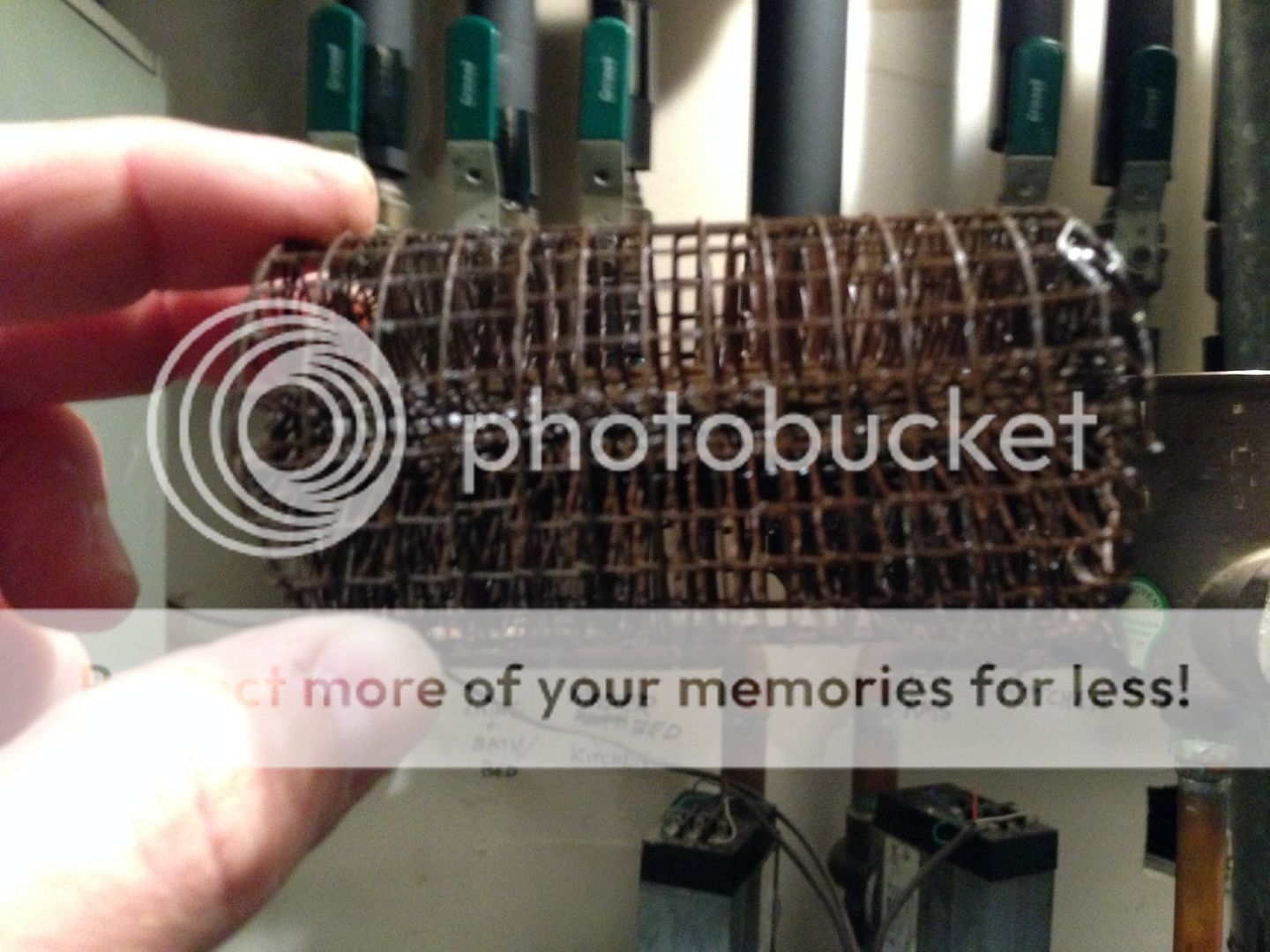

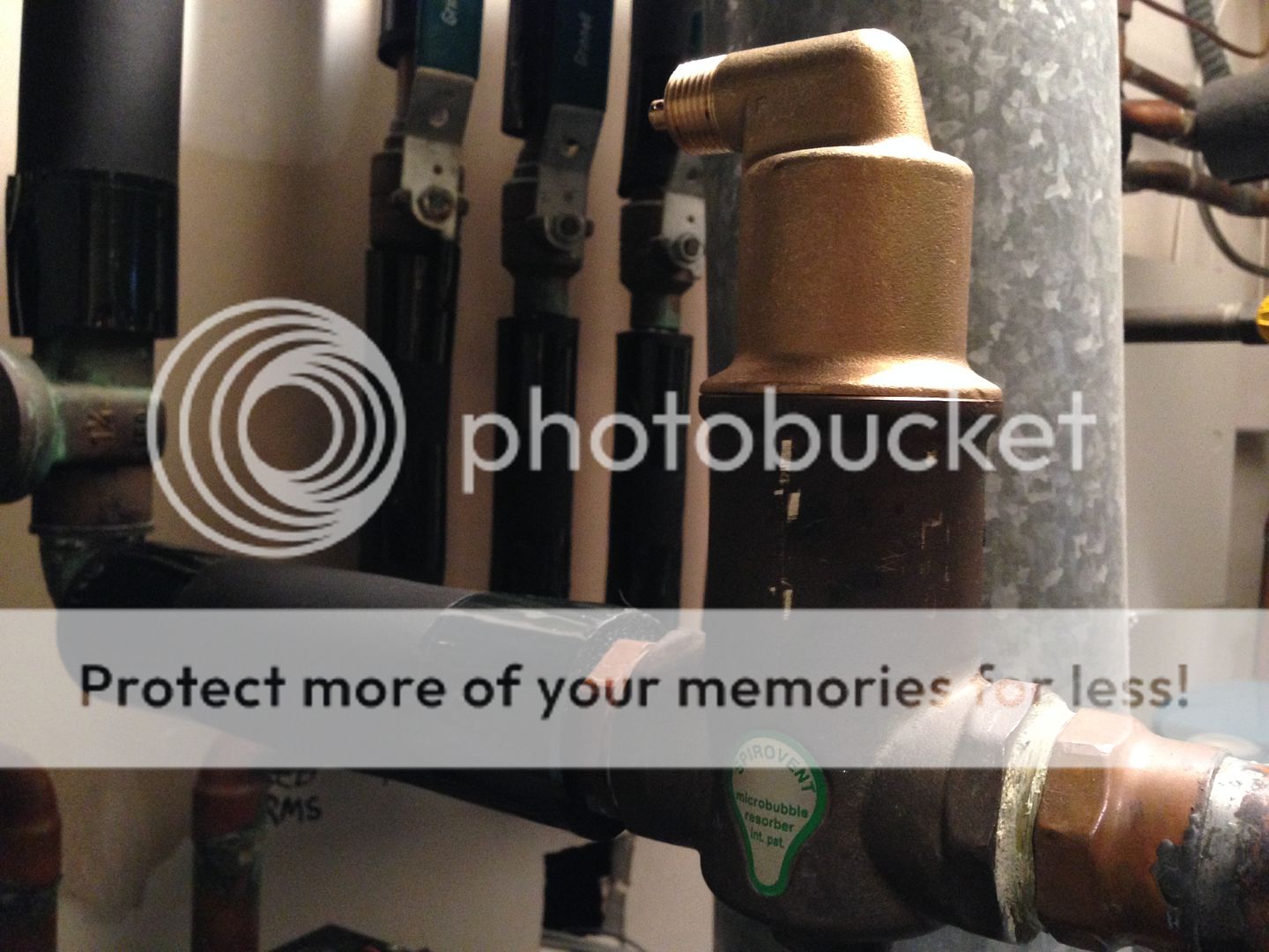

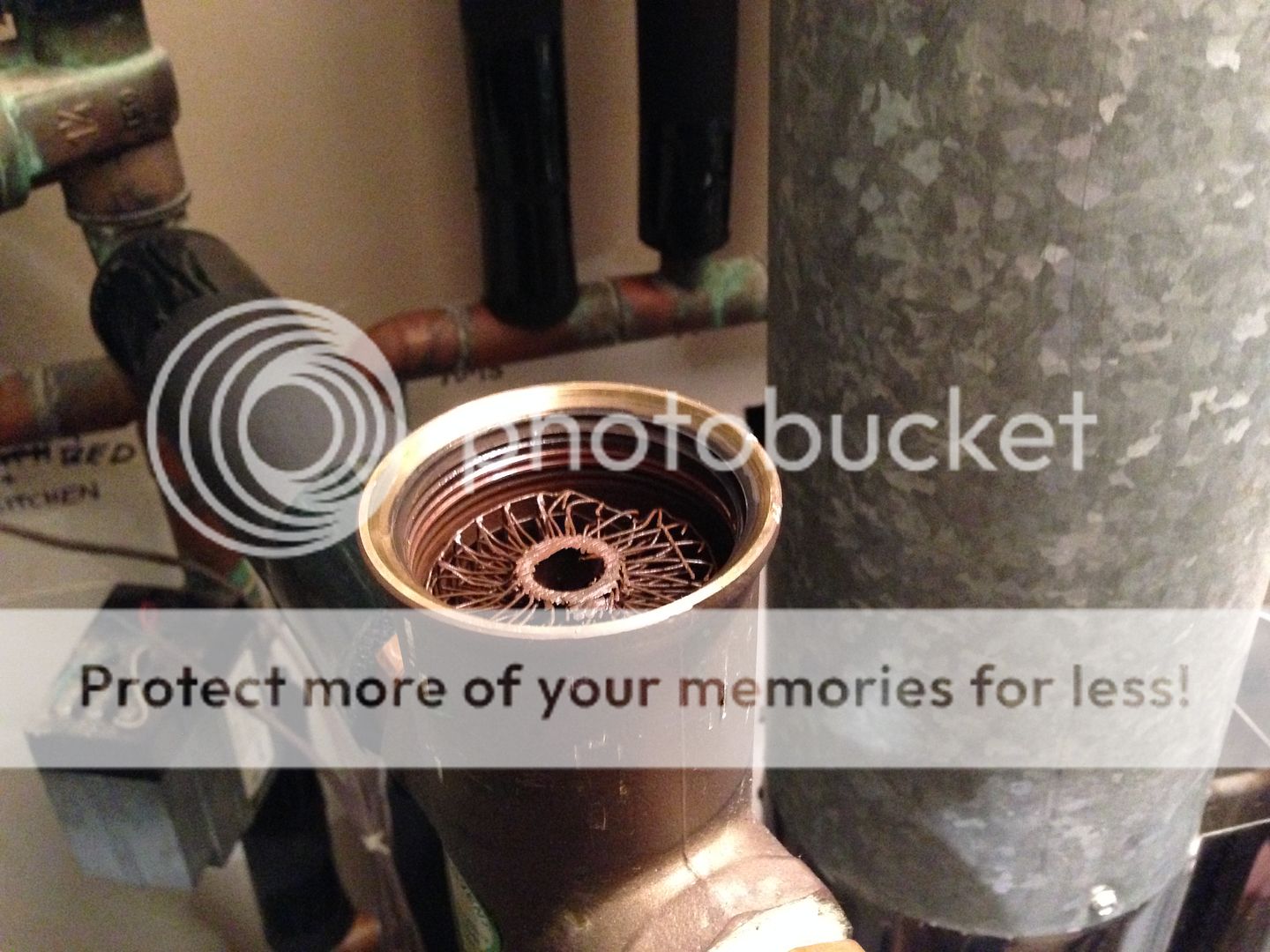

I purchased a $17.50 mega pipe wrench at Home Depot today and it actually worked!! With the help of one of my sons we were able to detach the 20yr old Spirovent head. Forget strap wrenches if you have to unscrew something old and fused on like this. Brute force is what it takes apparently. But anywho........the new vent head is installed and it started working from the get go as soon as I repressurized the system a long blast of air was released. Nice. My other one was jacked. It may have worked after a good cleaning but I figured since it's so old, just replace it.
A few pics:
We replaced that inner core as well. The old one was quite rusty. Not sure how much that affects the air-trapping performance.....
Now I have a two-tone Spirovent.

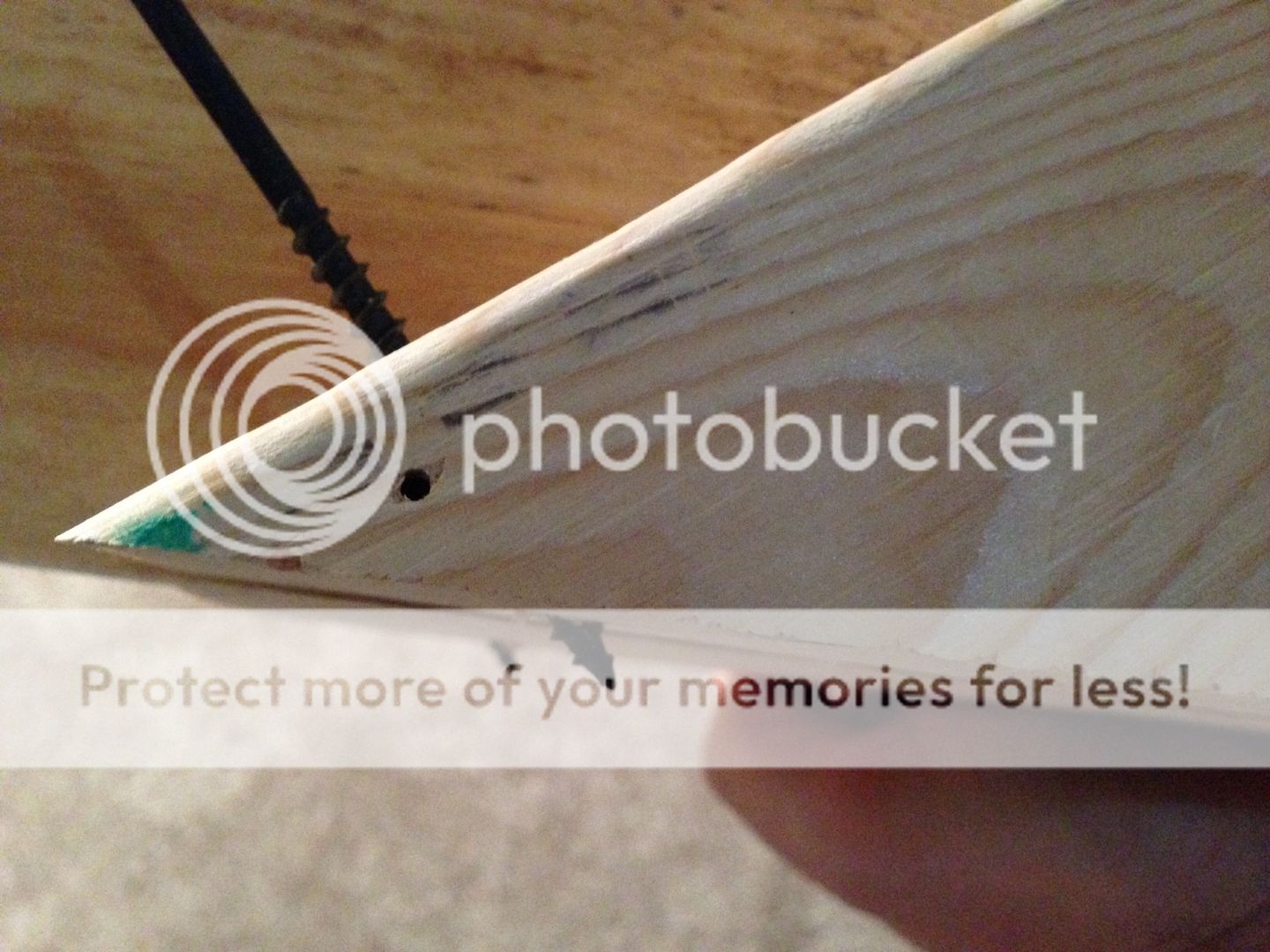

Worked on a new shim for boosting the height of the in-ceiling pips. Here's a profile shot of the shim. I went with some 3/4" plywood instead of a bulky 2x4.
I'll be installing this sometime tomorrow.

There probably won't be enough 'down force' of the wedge against the drywall to cause a problem, but I could envision a 'bulge' forming over time under the wedges.
I might suggest moving them closer to the I-beams... even right up against... one in each bay.
Maybe use two pull strings, one in each direction, so if you need to readjust after they are ALL in place, you can.
Gentler slope on the wedge and you might find that you won't need to fasten them...
OR... how about this idea?
Partially drive a couple screws through the 'sled' so they are sticking out slightly and at a reverse angle to the wedge. Slide that puppy under there, screws sticking out about 1/8" on the bottom will grab the sheetrock... no patching required... sled won't move.

Wow...great suggestions!!
Love the idea of "cleats" in the shim....brilliant!! And moving them closer to the joists is definitely spot on. I was actually wondering about the weight of the pipe and the possibility that the drywall screws would produce "cratering" if I create too much down force. But you raise a proper point about where the shim should be located (NOT in the middle of the drywall span).

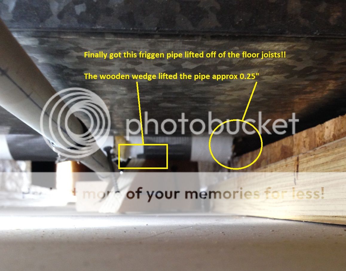

It's gonna be a quieter 2014 at my house!!!! The wooden wedge worked!! I'm fricken stoked but still keeping my fingers crossed. I just got this done a couple hours ago and so far the majority of noise is GONE! Unbelievable just how much noise an expanding/contracting pipe can make when it's rubbing against part of your house structure. Just unreal.
I installed a couple screws to act as cleats......perfect solution!!
It ain't pretty but then again it is all buried in the ceiling.
A couple videos, compliments of GoPro. The GoPro camera and GoPro App were our eyes for this job. We really felt like surgeons and it was kind of fun actually. LOL.
My son's view from the "feed side" of the room. I was on the other end pulling the wedge towards me and the pipe.
https://www.youtube.com/watch?v=OW0w20lwMqk The second video follows in the next post.

From my vantage point. I carefully tugged the fish line and sure enough that bugger pipe lifted off of the joist openings in two places that I could see. For now it appears that the pipe is not rubbing at all anywhere near this area. It's 100% silent here.
https://www.youtube.com/watch?v=WQx6NkrsQYo So there's still some tapping noise at the other end of the house where I suspect it will be a similar problem/solution. THAT noise was never ridiculous like the noise we just fixed. However, now that I have a solution that actually works, I'm eager to try it in another location. Luckily we have recessed lighting all over the lower level, so I will do some inspection work over the next few weeks. For now I am 100% overjoyed to have fixed this crap!! Thanks again for the tips and the help. Everyone have a great New Year!! See y'all next year!!
