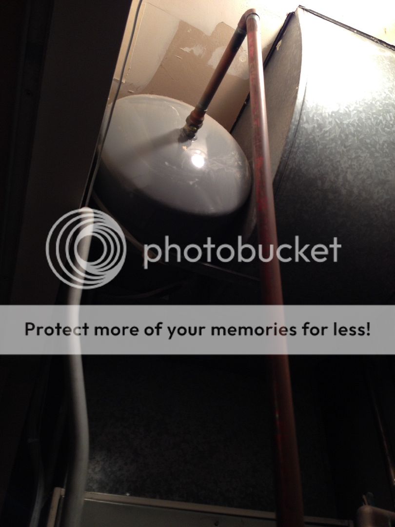

I suspect that my expansion tank may not be working correctly as it sounds like a dull “thud” when I tap on it everywhere….suggesting that it is full of water?? It’s also mounted horizontally. Is this correct?
I don't put much stock in the 'tap test'.
Here's the 'sticky' I mentioned:
http://www.doityourself.com/forum/bo...sion-tank.html
We have around 12PSI when cold and around 20PSI when hot.
This suggests that you still have SOME capacity in the expansion tank. If it was completely waterlogged you would have pressure relief spewing.
But yeah, check it... and charge it...
Horizontal is not really correct, but it will still work that way... tank might not last as long though.

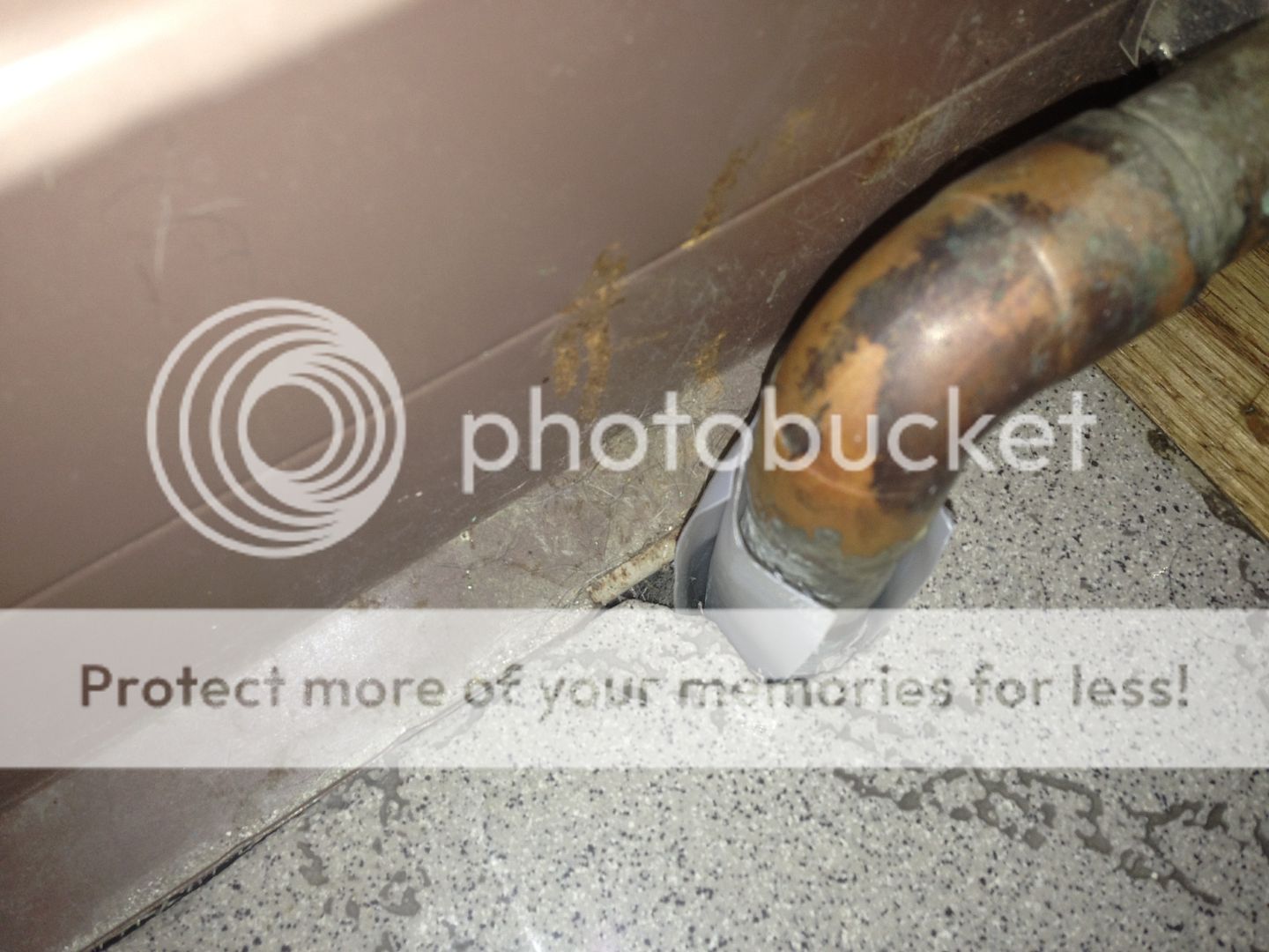

On the main level I have dismantled all the baseboards and cleaned and straightened all the bent fins and made sure that the plastic retaining clips were properly placed over the metal brackets -- most were not in the proper positions. The prior occupants were dog owners and I'm pretty sure I vacuumed a couple dogs worth of hair out of the fins not to mention coins, pencils, crayons, dog food, etc., from underneath. The pinging sound has gone away after that fun little exercise. My allergies kicked into high gear earlier this week though.
Anyway, I did notice that in a couple spots where the pipe disappears into the floor, there was not the required spacing so that the pipe moves freely for expansion. So you're saying THIS is what I'm hearing. Great.
Does the pipe expand lengthwise or outwards? What sort of play should I be looking for in these holes in the floors? In our hallway, the pipe moves very freely up and down and back and forth to some extent. In the living room (noisy room) there is one spot where the pipe will not move at all.
Lengthwise, axial. SOME radial, but not enough to cause the problem you are having.
Say at least 1/4" all around the pipe... so what's that, 1-1/4" hole for a 3/4" pipe?
Wherever you can, cut strips of plastic milk bottle and slide into tight spots.

if the pipe is snug in the hole, I should jam some plastic milk bottle shims around the pipe?
It would of course be better if you could find a way to open the hole... danger of puncturing the pipe with this approach is of course very real.
If the hole is that tight, the plastic shims might do more harm than good...

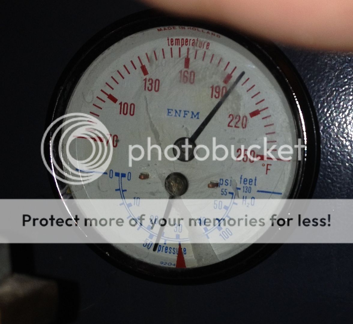

Got home and did a couple experiments.

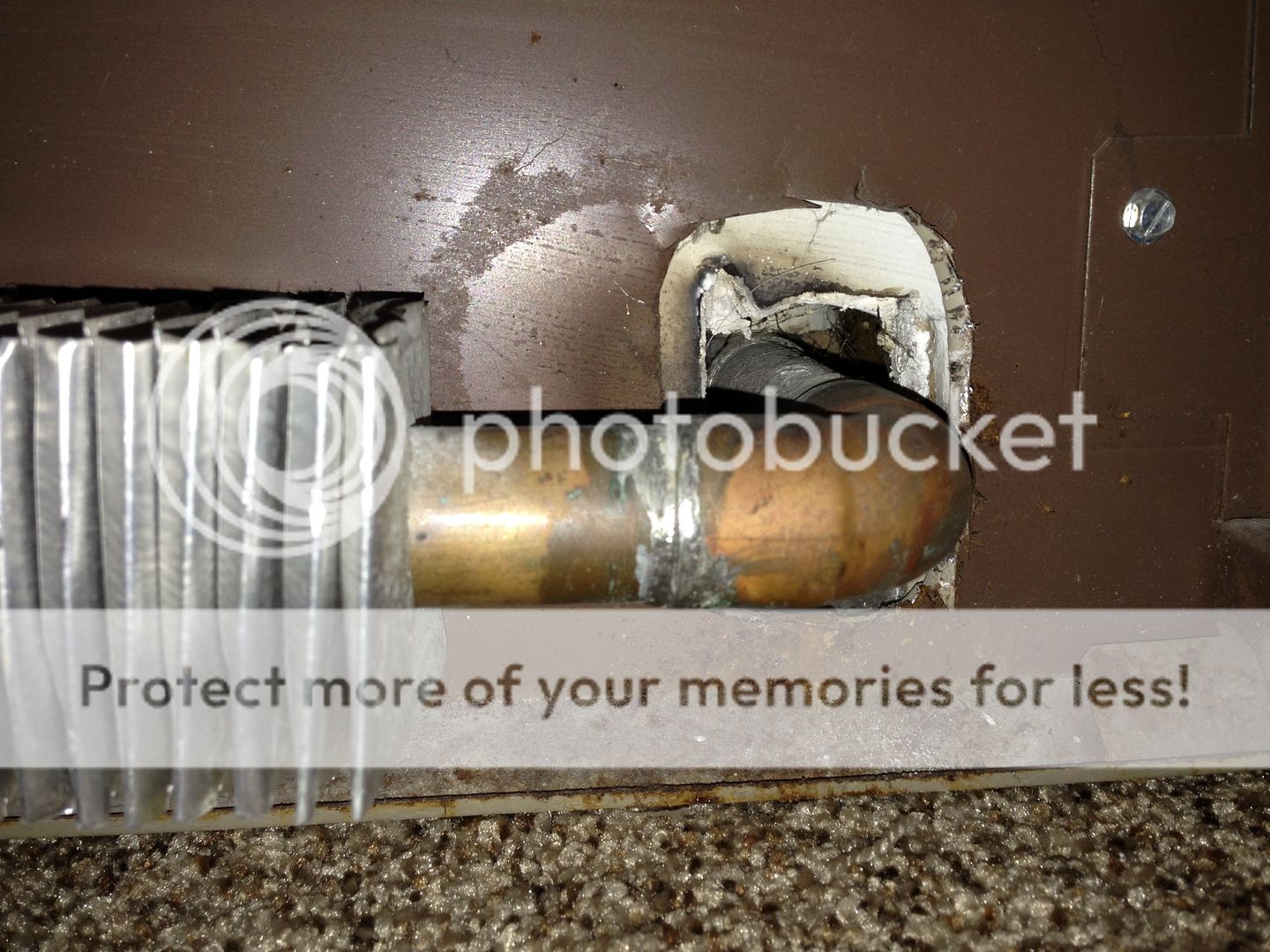

1) Plastic milk container shims around a snug pipe. Did I do it right? This particular pipe moves up and down but it doesn't have much play, side to side. I stuck a few shims around. Just to be clear, I don't hear noise right at this point, but there is noise in that room and it feels like it's in the floor.
For comparison, here's an element in the hallway that does seem to have the proper cutout. I do not notice any noise in the hallway.
2) I pumped up the thermostat to 73 degrees and monitored the pressure and the temperature. Guess what? Eventually the temp went all the way up to 220F and the boiler shut off at that point. The air temperature at the thermostat was still around 71, so I assume the boiler shutting down at 220 is a safety measure, correct? We don't want boiling water in the pipes. THIS must be a real problem. Would this be related to a faulty aquastat?
The temperature BEFORE I toggled the thermostat up was around 110.
Old 11-27-13, 12:20 AM
Join Date: Nov 2013
Posts: 66
I don't know if this will help, but here's a low quality phone video of the boiler. Notice the water leakage from the pressure release valve pipe. I noticed this happening the last couple weeks -- just a small area under the pipe is wet like a slow leak.
http://www.youtube.com/watch?v=WASOHiPjpXI Also here's a closeup pic of the pressure valve pipe and the leakage:
Here's the photobucket album with all my pictures thus far.
Boiler Photos by bkeane1259 | Photobucket
Please let me know how to proceed. Many thanks!!

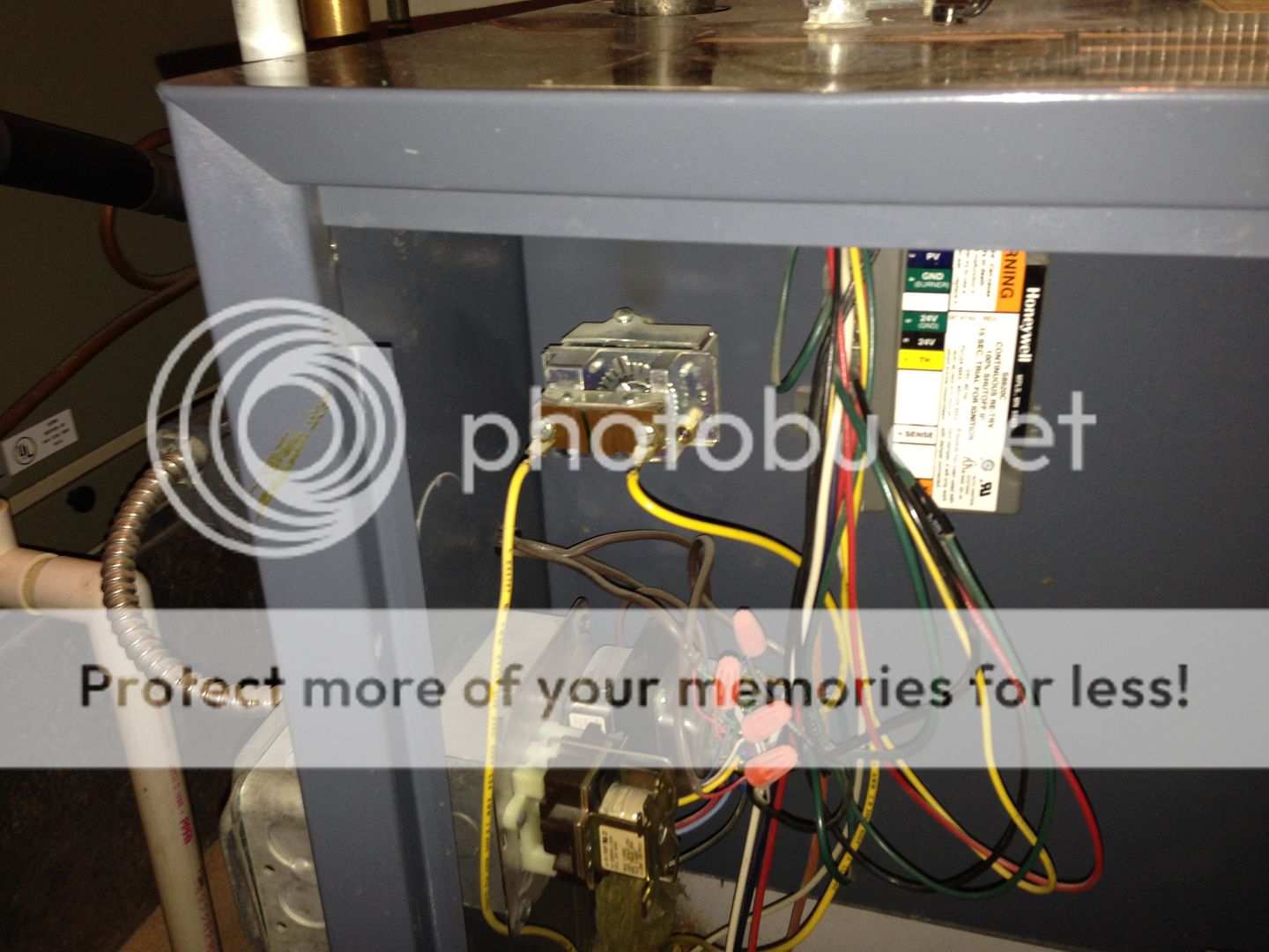

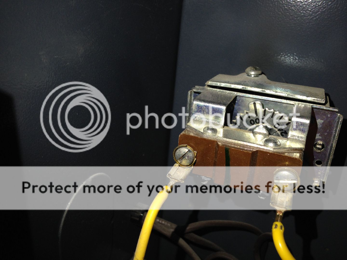

You need to lower the temp in the aquastat. Boilers way too hot.
Set it to kick off at 170F is good to start. That should be plenty hot to heat the home.
The relief valve may need to be changed but I bet lowering the temp will stop it from leaking.......

Small problem. I've not been able to locate that device. Do you see it in the pictures anywhere?
I'll look again. I'm looking for something that has 110v lines attached to it, yes?
Is it part of the Taco circulator thinggy?

WOW....what a total noob I am.
The aquastat is behind the front service panel. Pretty obvious too when you look in there.
And yeah - it was set to 210 degrees?!?
Soooooooooooooooooooo....I notched it down to 190. I'll monitor the noises at the new temperature setting.
As I'm typing this, I'm still hearing knocking. It was horrible last night...HORRIBLE. I think the outside temperature didn't get much past 20 degrees and right now it's 26, so the boiler is cycling a lot right now.
I think I have the correct understanding with the aquastat -- If I lower the max temperature, then the pipes will not expand as much and therefore less noise??
Go back to 170.

Based on the multiple pictures I see of your pressure gauge, I have ZERO confidence in it's accuracy.
1. appx 195° appx 24 PSI
2. appx 215° appx 12 PSI
3. appx 112° appx 16 PSI
These figures are totally inconsistent with physics.
The pressure should be LOWEST at the COOLEST temps, and vice versa, HIGHEST at the HIGHEST temps.
The fact that you have relief valve leakage could have something to do with the fact that physical laws appear to be broken.
The rule only holds true with all other things equal, specifically the amount of water in the system. If the boiler got HOT and spewed some water, of course the pressure would be lower...
But still, you need to get to a 'known state' ... so,
FIRST, I always recommend VERIFYING THE PRESSURE GAUGE accuracy, read:
http://www.doityourself.com/forum/bo...ure-gauge.html

I posted the link how to check/charge the expansion tank already, and that's the next step.
I really don't like the way it's mounted at all... but it doesn't look like there's enough room to properly mount it under the SpiroVent, is there? Can't tell from the pics if you have clearance, or if it will block other components that may need servicing. It will 'work' as-is... it's just not 'kosher'.
Speaking of 'service', can you even GET TO that tank where it's mounted? Looks like it's jammed into an inaccessible 'cubby-hole' up high?
You might consider adding the optional valves that are shown at the bottom of the expansion tank thread.
THAT particular picture was taken when the boiler shot up to 220 and then shut down. The zone valves then closed and I took the picture maybe a few minutes afterwards. Does the timing of that picture make any difference?
I have noticed exactly what you pointed out during NORMAL operation. When the boiler is off and the pipes are warm (not HOT) the pressure falls back towards 10 PSI. When the boiler is on and the zone valves are open (HOT pipes), the pressure ticks up towards 20-25 PSI.
Yes...I printed the procedure. I did check to see if water would spew out of the expansion tank schrader valve and to my joy only air came out. I will run the full pressure check on the tank after Turkey Day.
...it doesn't look like there's enough room to properly mount it under the SpiroVent, is there?
Good eyes. There is not enough room. The tank would hit the exhaust stack. On a slightly more happy note, I can access the tank fine, where it's currently mounted.
I am not too impressed with this utility closet. It is VERY small and I can only imagine how I will get totally raped if a contractor has to do any major work in there. They will for sure slap a premium on as soon as they see the work space. Crap...I would.

What can I do to seal the hole to stop the inrush of cold air while not messing up the required expansion space for the heating pipe?
Is silicone caulk NOT a good idea? I have rock wool and fiberglass also if that's a better solution.
Sorry I didn't see this earlier... just scrolled back and found it.
Fiberglas insulation might be the best choice... maybe open the hole a bit more in the plaster behind so easier to stuff the stuff in... you don't want fiberglas insulation compressed really. But that means air will still flow. How about getting as much insulation as you can inside the cavity around the pipe, and then use some pieces of that closed cell foam pipe insulation around the pipe itself in order to block the air flow.
I would be asking myself why there is obvious air flow around the pipe... is this an older home with tongue and groove sheathing?
I suspect there is some leakage around the window casings that might be eventually finding its way thru those holes. This air leak is in the basement. The house is 20 years old - brick bungalow with fully finished basement. We've been there less than 1-year so this is our first cold season. During the summer it was bone dry despite some very severe rain, so things could be much worse. I'm grateful for the apparent good condition of this place, all elese remaining equal.
I was thinking of renting a FLIR at the Home Depot to troubleshoot the air leak. However, the first order of biz is getting the heating system in good order before something bad happens.
