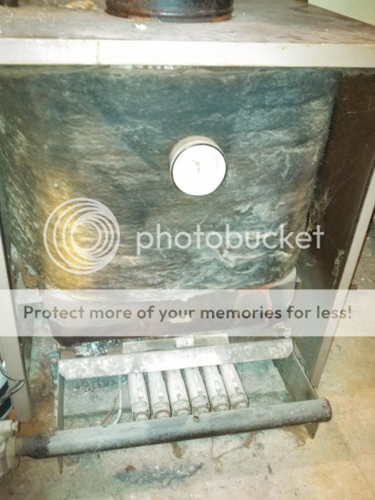

So my phone felt it should erase my whole reply with all the picture urls instead of post them, so to avoid d that this time, I'm going to kinda spam post one picture at a time. But its only 4 or 5 pictures. Anyway, here's the furnace

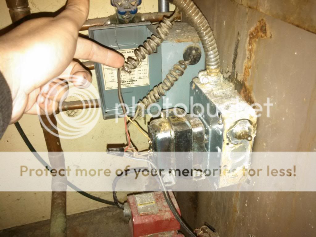

Here is all the electrical mounted to the side. For reference, my fingers on the wire going to the wall, presumably to the thermostat. Second curly goes to the relay box that seems to only click in and out with the thermostat, but not actually control anything. Metal convoluted out the top is 110 power source, and the two blacks go straight to the gas valve.

And In the interest of condensing pictures, the last one is the box under the inverter. No aquastat to be found. Pump is wired straight to the 110 power source, not the relay. Couple wires go into the bodywork of the boiler, I assume are the temp sensors themselves, but I can't tell for sure without tearing the insulation around the boiler itself up. Would seem a silly place to put an adjustable control. Hi-lo toggle switch does nothing as well. Not even sure it hooks to anything. That concludes my photo tour, but I'll take more if needed.

I'm a little nervous about this... looking at the front cover the paint appears to be badly scorched. OK, the boiler has been running real hot... but even so, there should not be enough heat behind that cover to scorch paint like that. You may have a 'rollout' condition and it's unlikely that old boiler has a 'rollout safety switch' still in place (if it ever did).
You should really investigate that condition!

The sheet metal has looked like that as long as I can remember (20+years) possibly a condition my grandpa dealt with long ago. Also running simple base board heat. Plus a panel in the downstairs living section. No joists to speak of, house is split level with the boiler on the lower level between the basement and ground level. So the boiler might as well be on ground level of a two story. Old tank was maybe 3 times tallest than the one currently mounted on it. Same width. Non bladder and mounted in the same place. I'll take a picture shortly of cover off.

Just an observation.
Besides all the mechanical things wrong, the discoloration of that door is telling me deffinetely overheating, not from hot water but from lack of proper venting. You either have a plugged boiler or very poor draft. I would be be more concerned with carbon monoxide. Unless it was there and is now fixed.
You might want to remove that cover and see what's in there. My bet is that fire might even be coming back at you.
As Trooper mentioned if you had a rollout switch it's probably toast by now or disconnected.

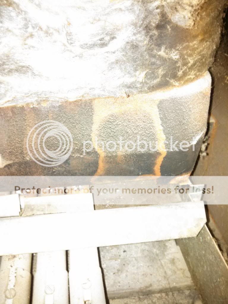

Here's the cover off
And here's a closeup of the hotspot.
Like I said, that's been discolored for decades now, so I'm assuming fixed by my grandpa. Just for the hell of it, I ran a cycle while watching it with an ir thermometer. Highest temp at the cover was ~100 degrees or so. Even across the cover, no hotspots to speak of. Burner looks nice and healthy with no stray flame.

Must admit, I feel better now.
There isn't much that can't be fixed as long as you're around to do it.

No wiring diagram on inside cover?
That 'hot spot' looks more to me like there had been water leaking at one time.

Ya, I agree, but where is the question. Nowhere can I find it on the outside, and it would seem silly to put it inside. To gain access to the wires going inside the body, I would have to disconnect the furnace water supply pipes it would seem. On top of disconnecting the electronics.

Its probably in a well somewhere external.. Take more pics of piping all around...
Back of boiler?

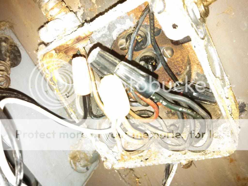

There are these two switches/sensors? inside the electrical box???

Lawrosa, I didn't even realize those were switches back there. Due to obstruction, the only way I can really see in there is with my camera. I may have to move the wife's washer now do I can really get up close to it. No other spots on the piping where a sensor could be installed. All of the wiring is in that little area on the side. Is there such thing as an aquastat that's non adjustable? More akin to a thermo vacuum switch on old cars? Simple preset on and off points preset and non adjustable that in this case may have been miswired?

Im still trying to find info on them.. They may just be a conductive type swith.. Such as a crude low water cut off....Possibly one is a high limit???
I would still like to see many more pics all around the boiler. Possibly out trained eyes may spot something....

Looks like a thermal swith... Yes pre set temp...

So after finding out those are thermal switches, I went to testing them. Found one (presumably the low) stuck closed. Didn't matter how hot the boiler got, it still did nothing. The other would open at 200 and close again at 150. Seems a pretty big gap to me, but as you guys have said before, the gauges on the front of these things aren't always the most accurate. So I wired the 24v inverter solid to 110 power, as it already was, eliminated the faulty thermal switch. Wired the second thermal switch (and thusly the burner) in parallel with the pump relay (after wiring the pump correctly to the relay) and those two in series with the thermostat. Everything now seems to turn on, pump, and cycle just as I'd expect a boiler should. This seem correct to you guys? Also if so, my next question is if I can retrofit this pup for an auto igniting pilot light to save a couple bucks a month on natural gas?
