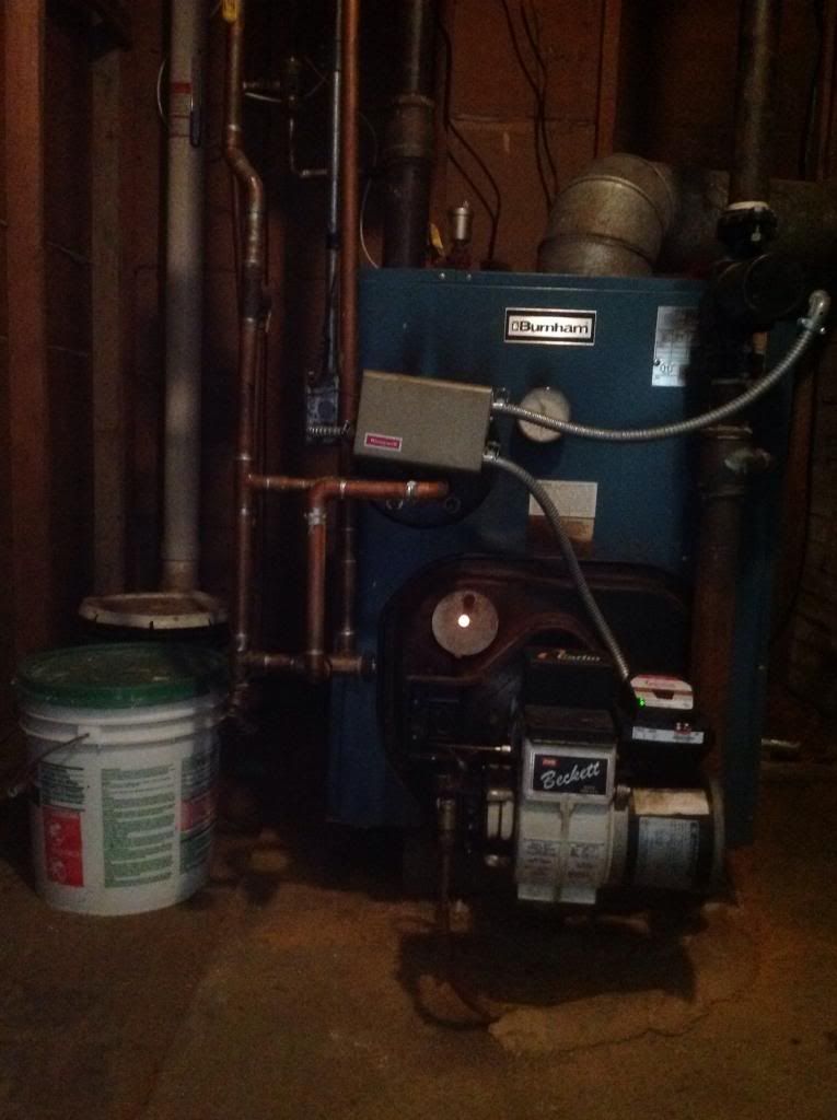

Can you post pics of your boiler?

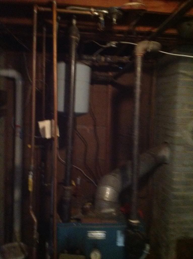

I think the problem is a lack of water in the system. The pressure reducing valve has not been working for a while. I have been feeding the boiler manually and close the valve when the pressure reaches 12 to 15 lbs. Lately i have to do it every other day. I can not find any leak in the system to justify the loss of pressure/water. Where the water is going?
Here are some pictures of the system..
This constant feed of water is causing a high concentration of minerals in the boiler water... this is a bad thing...
Worse though is that whether or not you can 'see' a leak, it would seem that you do have one. There's really not other way to lose pressure, is there?
It could be leaking INSIDE the boiler and going up the chimney as STEAM...

I can't advise much on exactly HOW to do it, perhaps Lawrosa will be along to offer some suggestions, but it would seem that if you can't see a leak anywhere the only place it could really be is inside the boiler... and if it is, short of replacing the boiler, it would seem that boiler stop leak would be the best chance you have of getting through the winter with a cracked boiler.
