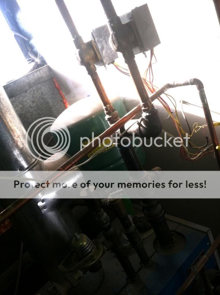

I am in the process of installing new baseboard heating . I removed all the old fins/piping and replaced them with new fins/piping/covers. The water was already shut off and drained when i started so im not sure what it what on the boiler. I need to fill and purge the new baseboard now and not sure what to do on the boiler or what side is the supply and return . All i basically know is what the parts of the boiler are. I know pretty much how to purge the baseboard too but not sure what valves on my boiler are the right ones.
My boiler (oil) has two zones ,one circulator pump. 1 zone to upstairs baseboard which is already filled and running . second zone is the downstairs which i need to fill.
Can someone tell me which are my supply pipes and return pipes and what each valve does from the pics below. Are the zones on the supply? Circulator pump with the two ball valves is the return piping ? I see that above the circulator 1 of the two ball valves is off and theres already a hose on the spicket above so im guessing thats the one i need to turn on to fill the first floor baseboard? Thats the return piping?

Yes the lines with the hose is the return.... The large pipe on top of the boiler is the feed...
You need to fill water into the boiler to purge...
What does the temp and pressure gauge read on the boiler???

So the zone valves are on the feed/supply? And to fill the baseboard i just need to turn on the zone valve? Then to purge the air i just need to drain the hose into a bucket till air stops. Or does the ballvalve on the return piping below the hose valve fill the 1st floor baseboard?
Right now the upstairs baseboard is filled and boiler working for that one. Just downstairs is not filled. The pressure and temp guage read about 160 and 15psi.Its heating the second floor.
Yes
Yes manually open it...
Yes
That valve needs to be closed when purging..........
Do same for downstairs....................

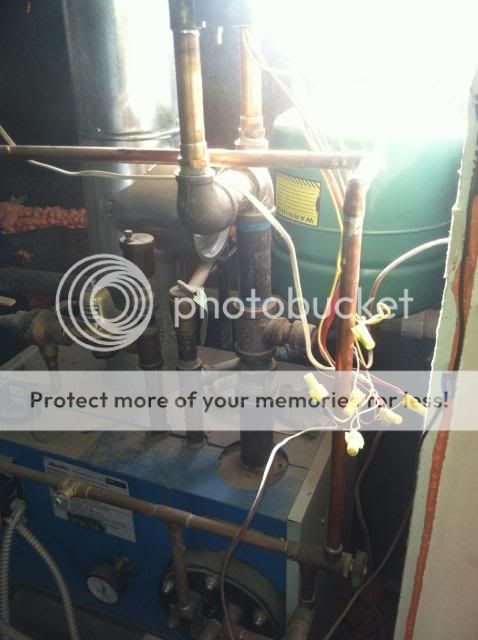

Thanks for the help . So the valve below the hose valve should be on when filling and at all times exept only when purging the air? Also what do the other valves on the boiler do ,like the black plasticv one on the right side on the copper piping and the hose valve below the black one on the pipe that leads to nothing? Also the yellow valve next to the pressure regulator on top of the boiler? And last the green ball valve right next to the emergency shut off?
Yes that is correct,
You mean the round one here in this pic?
If it even works that is a temp control for the hot waterat the faucets... Keeps you from being scalded, as the boiler temp is 180f so can the domestic hot water..
That should be set so you get no more then 120f...
The boiler drain there is just to drain the domestic side of the piping for service... The pipe to no where is a [pressure] relief valve,,,,,
If the regulator fails then the boiler may over fill... The yellow valve allows you to turn off the feed to the boiler... Some leave it open and some leave it closed... Its a bit of a debate on what is best... I leave mine open........
That valve will shut the hot water off to the home... That is the cold line to the tankless coil... Also branches off to the mixing valve with the plastic handle... Again used for service....
Hope this helps...
