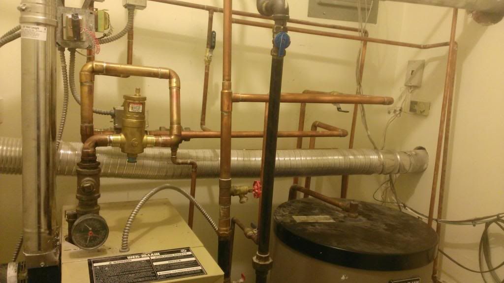

The hot water is just a tank. I've had to turn the temperature up quite a bit to get a hot shower on the top floor-- and the hot water takes forever to get to top floor sink-- but other than that, seems ok.
Yes, it is freezing here right now and I am very upset and cold. I hope these pictures are ok. It's a tiny room and I can't pan out anymore so tried to stack the bottom 3 pics as they would all fit together. I can zoom in on, and repost, anything you need to see close up.

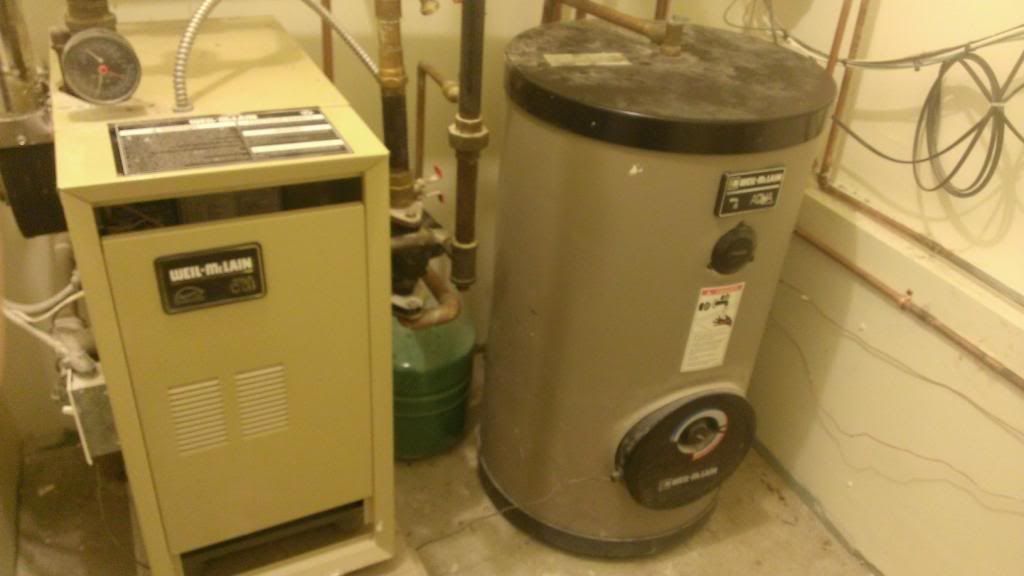

Is that the expansion tank on the floor next to the boiler?

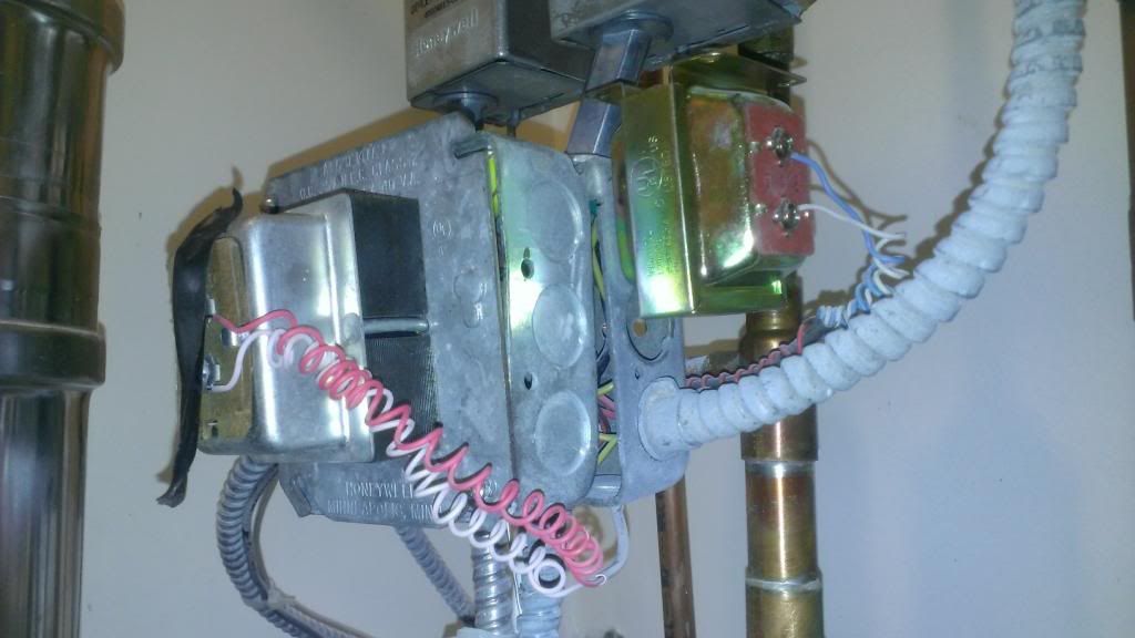

Last how are the zone valves wired? Is there a control panel? If so take the cover off and take a pic..
Oh also when there is a call for heat at any zone, the zone valves open as they should right?

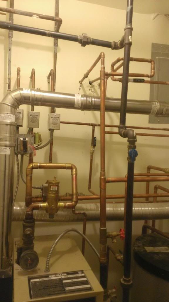

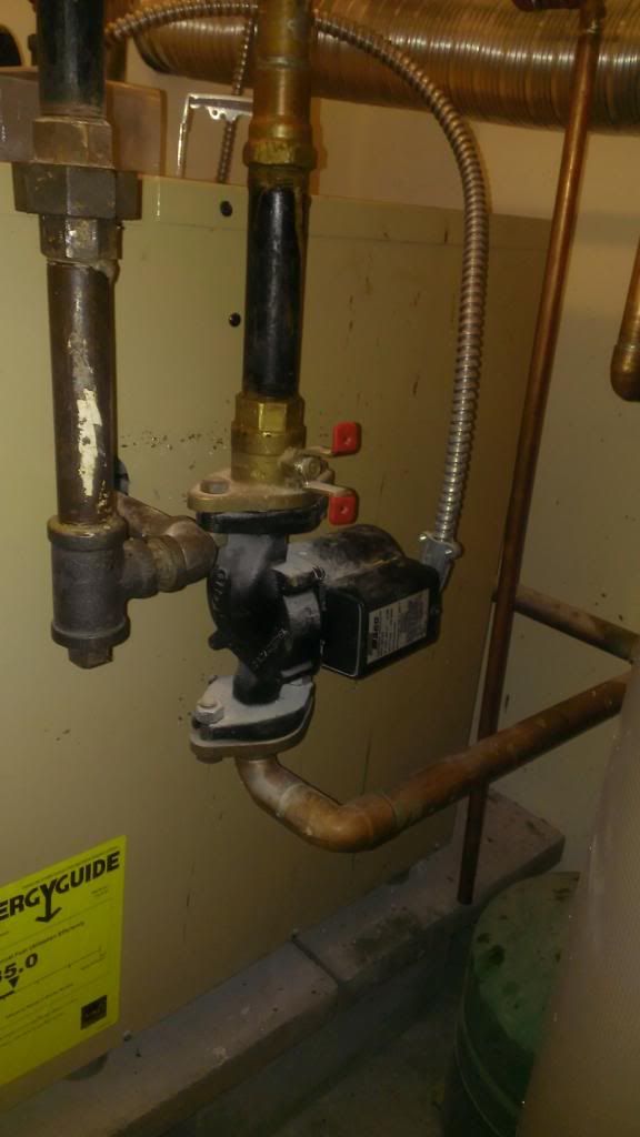

That obviously wasn't inspected. Where's the LWCO? Looks like a lot of unnecessary piping as well. I'd hate to find out what you actually paid for this job.
They should've put the pump on the supply right after the spirovent. Ive always installed my pumps on the supply and don't know what type of restriction there is trying to pump through a boiler AND a spirovent to go along with the rest of the system. You probably need a good purging and that should help a lot.
The zone valves are on the supply as well. Thats a lot of restriction for a 007.

Spott: There are now pictures. I had an old water storage tank where I never had to adjust the temperature. I have this new one up pretty high just to get a hot shower and hot water to top sink is very, very, slow but otherwise hot water is working fine.
ThomasDB: I have a shut off valve for each zone. They are hard to see at the very top of return side pipes, top right. I used to have older valves on the supply side. Also, the zone valves used to be horizontal and on the return side. They are facing the correct way for being supply. Arrow facing up toward ceiling.
ThomasDB: Yes, the expansion tank is now on the floor. It used to be up high, sort of above, and in between, the boiler and storage tank.
Lawrosa: PSI is 24. (3 story small home, basically 3 small rooms stacked on top of each other.) Temp fluctuates from a high of 215F to a low of 160F. I believe it is set to turn on at 170F and turn off at 190F.
Lawrosa: The circulator pump is what I first asked the plumber about because of the drastic variations of heat in the house. He said it's working exactly right. Sometimes I hear a faint buzz to know that it's on. Other times I hear nothing at all yet will feel heat in the return pipes, so I really can't tell.
Lawrosa: I don't know what an indirect heater is or where you see that in the the picture. My reply to spott, above, talks about the water tank if that's what is meant.
I will get a picture of the zone valve wiring and how the piping goes into boiler for you.

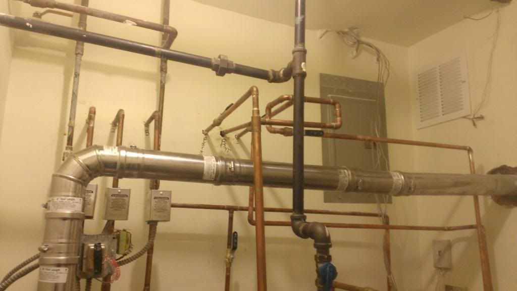

Is that the circuit breaker panel for the home up there on the wall behind all that piping?

Good eye troop. Looks like there's room to open the panel, but I'm sure someone will have a fit when they need to work on that.....how hard is it for people to do a good job when they get paid a lot of money? Makes me sick.

NJTrooper: Yes that is the circuit panel for entire house. It was never blocked before the hurricane. I did have to stand on a chair and reach over the top of the water tank to get inside, but nothing else was in the way, no pipes and no vent to outside.

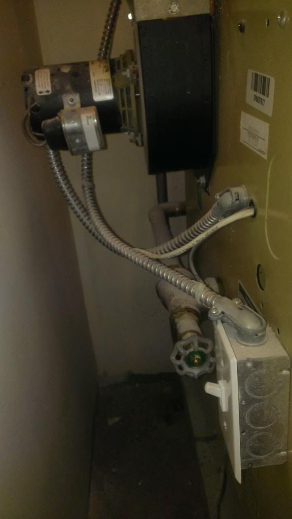

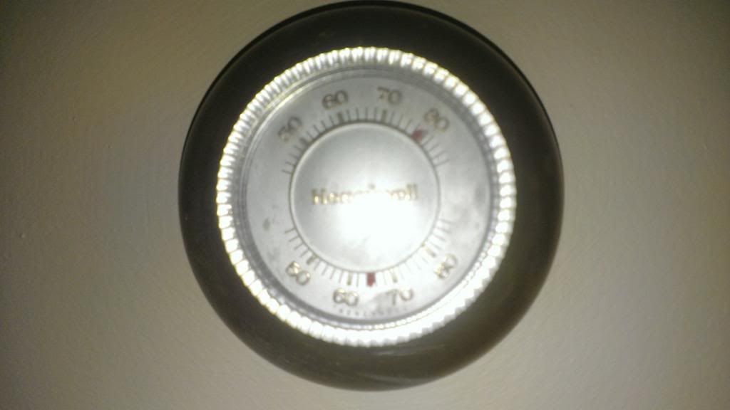

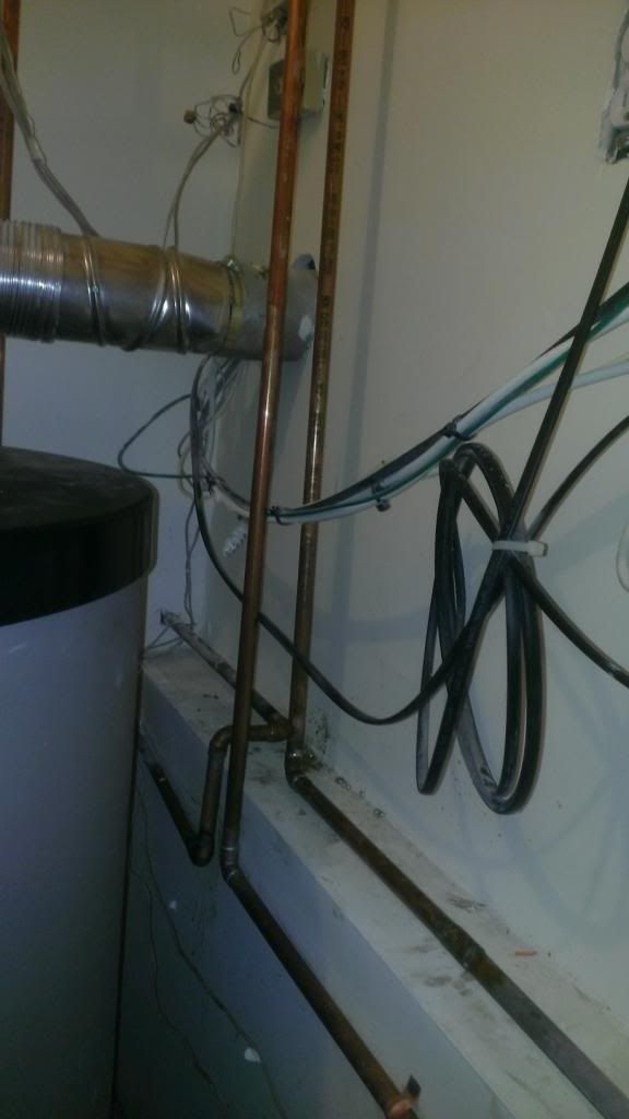

Left side of boiler
Right side of boiler
These have covers, I took them off for photo.
This is "as is" I haven't removed any covers. If you want me to unscrew the front panel I have to wait until tomorrow.
Upstairs thermostat
This is at the bottom right of room. It used to just be two straight lines supply in/out of ground floor baseboard. He cut those. Now, the loop closest to far wall is part of middle floor zone. The vertical pipes are brand new, the ones blocking circuit box. This was done after install at one of the service calls.

Are you trying to heat your house or brew beer. You could probably scrap half that pipe and get a good amount of cash towards the job or get your money back from the job. The guy ought to build roller coasters.
Where is your circulator pump and do you have the valves and drain valves to bleed the zones.
Did the contractor try bleeding the system and if he did, did it heat up at all when he was there.
Are you able to hold the pipes on the baseboard heaters. With the water temp that high, with good circulation you shouldn't be able to touch them for long. If you can hold them, you're not getting the good circulation which is why it takes so long for the boiler to come back on.

Follow lawrosa's advice. Report this guy to your town, there's no way he pulled permits for this. There's no LWCO.....immediate fail upon inspection.
The pump is in the correct direction, you can tell by the size of the volute towards the top side of the pump. There's definitely several problems here that need to be redone. If you can't get this guy back, then you should definitely get your money back.
On another side note, what's the point of putting in a valved flange if you don't install one or another shut off valve after the pump?

A: As zone 4, I see a zone valve (hiding) behind the B&G air sep.
Same for the spirovent?
A: EAS Jr. Air Eliminator "The air separator is bi-directional so that water can flow in either direction."

What way is the arrow facing on the pump??? I could not find an arrow. RDSteam said: "The pump is in the correct direction, you can tell by the size of the volute towards the top side of the pump."
Which way are the arrows pointing on the zone valves? Up, in direction of water flow.
Same for the spirovent? Took picture of it from every angle. Don't see an arrow.
What is the pump model #? Taco 007-F5, hp 1/25, amp .71, 60hz, 115v, 3250rpm
How big is that boiler? CGi-4E PIN Series 2, Input 90,000 btu/hr D.O.E. Heating capacity 76,000 btu/hr
How many feet of baseboard on each zone?
Top floor baseboard: approx 20 feet
Middle floor baseboard: approx 27.5 feet
Ground floor baseboard: 18 ft in ground floor loop, another 2.5 feet is part of the middle floor loop and not counted as middle floor baseboard, above.
Was the installer a licensed plumber? NYC Dept of buildings website shows a current master plumber liscence and current insurance.
How is that water tank heated?
The hot water from boiler comes up through the spirovent, goes through the zone valve right behind that (left to right arrow) and continues into the back of water tank. (Best seen in the second to last picture of my first picture post.)
The return (from water tank to boiler) goes up from behind water tank, through pipe with green shut off valve underneath it and past the red handled outlet just above circulator pump. The expansion tank on the floor is on that return line from water tank to boiler-- on an offshoot between the green and red valves. (Hard to see as it is a very thin pipe and hidden behind gas line is most pictures.)
Some asked if I can hold onto the pipes in the baseboard. My answers would be all different depending on location. The middle floor ones are the least hot. To me it fells like the entire system is running in reverse. The baseboards that were the hottest before hurricane are now the coolest and vice versa.

Take more pics from around the ceiling so we can see where all the zones are tied to...
This on I see a blue handle ball valve back by the wall... Middle of pic..
Looks like it goes from the indirect feed to a pipe that goes to a basement feed line... ( Looks like it dont go to a zone valve but ties in somewhere else..)
Close that valve...
( Can others confirm that the valve and pipe in question probably should not be there....???)))

Can you tell us what these 3 pipes are again? The two on right according to the piping are returns.. The one going in the wall look like a feed ... Is this right?
