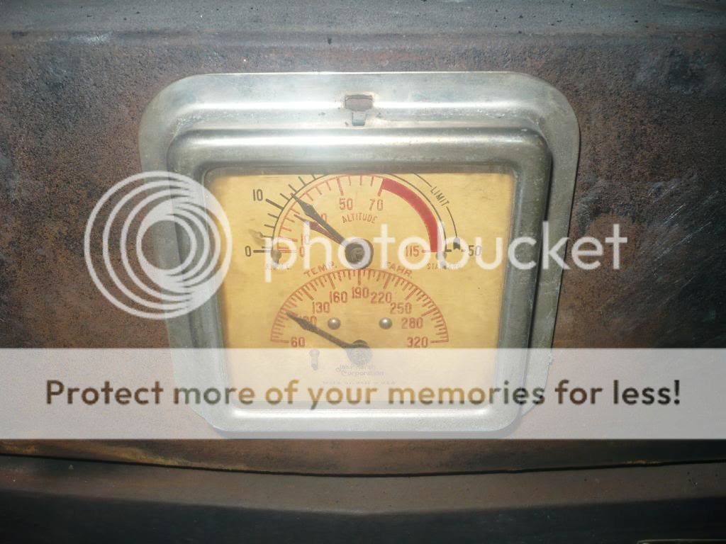

Hi Guys, It's been 5 years and I needed to purge my 2nd zone again and for got how. I managed to get heat in there but I forgot what valves need to be shut off and which ones need to be left on. My boiler is reaching the red line on PRESSURE. Help!! Please!!!

Hi Joy,
Purging a zone of air will not cure high pressure in the boiler. It may help temporarily, but will not cure the 'root cause' of the problem
Tell us the make/model of the boiler for starters.
Tell us what PRESSURE you are seeing in addition to the TEMPERATURE.

You talking about this gauge? ... did you mean the PRESSURE being up close to 30 PSI?
[edit: yes, you did]

Yes it is the pressure guage that I was referring to. sorry. I did find the release and brought the pressure back down to around 18 right where the picture is. lol my biggest problem is I can't remember what valves should be turned off. I'm now thinking that the water feed to the boiler should be off?

With your boiler there are basically TWO things that can cause the pressure to go up too high:
1. EXPANSION TANK NEEDS SERVICE. There are step by step instructions in the thread I posted link to for doing that. All you need is an ACCURATE tire pressure gauge, and a decent air pump or small compressor, and some time... and maybe a garden hose and a bucket. It's relatively easy.
2. WATER FEED VALVE IS _SLOWLY_ "LEAKING THROUGH" and over-pressurizing the system.
Item ONE is the FIRST STEP. You need to get to the KNOWN STATE of a correctly charges and properly functioning expansion tank before you can know if the feed valve is at fault.
As for having constant air problems in that other zone, that's because there are no air vents on the boiler, so the air that comes into the system dissolved in the water has no way to get out after it comes out of solution in the water and forms bubbles.
