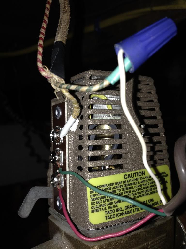

thank you so much for your help and i apologize for the duplicate threads - didnt think i did it right the first time - the system is weil mclain gold
i sent you pics of our system if you need additional information, please let me know
OK, forget what I said previously about 'zone valve' and 'endswitch' because you don't have them. Your system has individual pumps for each zone instead of zone valves...
When thermostat calls for heat, and the LED does not light on the Taco SR 502 panel, it indicates that the problem can be anywhere between the thermostat and the Taco panel.
Do you own and know how to use a multimeter? There are some checks I can have you do if so...
Slide the cover off the Taco panel...
Best to SHUT THE POWER OFF before removing the cover as there is 120 VAC EXPOSED INSIDE! You can be ELECTROCUTED if you touch the wrong thing with the power turned on!
You will see a row of these (click link to view):
Taco Circulator Relay Replacement Relay Head - 24 Volt - SR024-001RP
First make sure they are all firmly seated in their sockets.
If they ARE, then determine which one of the zones is not working and put a mark on that 'cube relay' so you know where it originally was. Gently pull it from it's socket.
Swap this cube relay for another one that you know is working.
If the problem FOLLOWS the marked cube relay, you need a new cube relay.
If it does NOT FOLLOW the marked relay, there is something else going on and will require further troubleshooting.

Join Date: Jan 2014
Posts: 12
Received 0 Upvotes
thank you - i uploaded a pic of the inside and the thermostat just in case they would be helpful to you. i took out and switched the two taco circulator units but nothing changed.
also, this zone would occasionally go out on us over the past couple of years and if i powered down the whole system and turned it back on the zone would kick on - not sure if that helps at all.

ok sorry about this but after review and shutting all zones off we just realized this is not a wiring issue - the second red light that is working is the light for the zone that is not working - we thought all three lights would light up
Confused again...
Let's recap:
Where is the THIRD THERMOSTAT wire? What is it going to?
You are saying now that the zone that is NOT working is the SECOND zone on the Taco panel, but that the LED for that zone IS lighting when that thermostat is calling for heat?
Does the PUMP for that second zone that is not working on the Taco panel run when the thermostat calls for heat?
Let's recap:

Join Date: Jan 2014
Posts: 12
Received 0 Upvotes
the pump is not working for zone 2
turned on zone 1 and can hear the pump running
do we replace the cartridge in the taco pump?
nothing else is kicking in that I can hear
If you put your fingers lightly on the pumps, can you feel a slight vibration?
In other words, be certain that nothing is happening.
Ask your brother to set his multimeter to read 120 AC volts and and CAREFULLY ! so as not to get zapped by high voltage, measure the voltage at the TACO panel on the " H and N " terminals for the pump that should run when that zone calls for heat.
Tell him not to be concerned that there is no wire on the N terminal... it will still read 120 VAC if the taco panel is working properly.
Compare to the OTHER zone that IS working properly if there is any question.
If you DO see 120 VAC at the non-working zone H and N terminals when there is a call for heat, AND the associated pump does NOT RUN, then you need to follow further...
Need to determine if the pump is getting power first.
If you do NOT see 120VAC at the pump terminals on the Taco panel, then the problem is in the Taco panel. You might try swapping those relays again since the first time there might have been some confusion...
Following the above test, since you know which pump should be running, and IF you DO have 120VAC at the pump terminals on the Taco panel, the next thing to check is if that power is actually getting to the pump.
Slide the cover off the electric box on the pump and measure for 120VAC at the pump.
If you have 120VAC out of the Taco panel, you should also have it at the pump.
If you DO have power to the pump and it still does not run, then yes, the problem is with the pump.
If you do NOT have power to the pump, then the problem is inside one of those electric boxes on the front of the boiler, a loose wire nut or something.

turned off the other zones to check it out
when the red light clicks on there isn't any sound or vibration at all in the pump - just silence
brother will probably come over tomorrow and check out the voltage stuff
Join Date: Jan 2014
Posts: 12
Received 0 Upvotes
NJ Trooper
thank you so much for your patience and your assistance.
we didn't need to wait for the multimeter - found a loose red wire inside the gray switch box.
the switch itself was cracked and replaced it and we are all set
