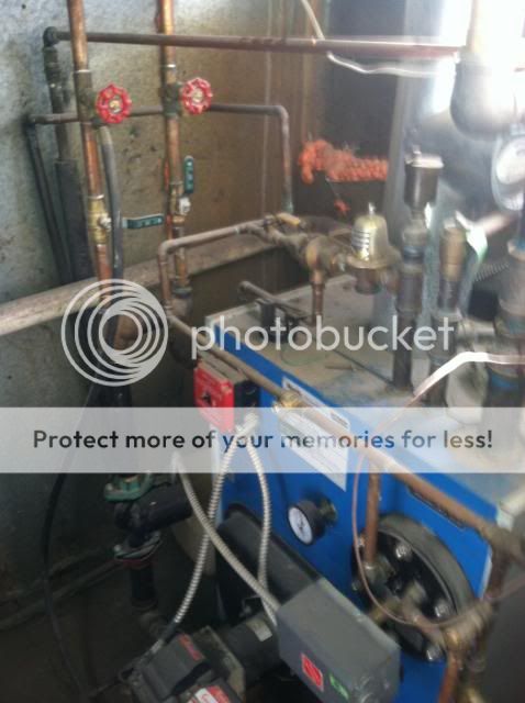

I am planning on installing radiant pex heating under my tile floor in the kitchen. I will be using warmboard and 1/2" alum pex . Its not a large run .Only about 200ft so i would like to only do one loop on one zone. Do i need a manifold if only one loop? I read up on the internet but most info is for multiloop systems.

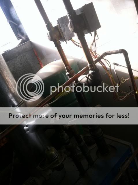

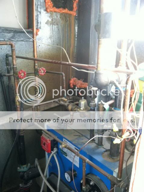

The way my boiler is set up now is i have two zones on the supply side.One zone for downstairs baseboard and another zone for upstairs baseboard. The radiant pex i would like on a third zone. My boiler is set up basically honeywell zone valves on the supply side and single circulator pump on the return side.
Do i need another circulator pump for the radiant pex or can i just tap into the existing circulator pump like the other two zones are doing?
What do i need for the boiler to add the radiant pex system exactly and how do i set it up ? BTW the radiant pex loop will be right next to the boiler room and both on the first floor.
Here is a few pics of my boiler setup to go off of

Is that a NEW boiler after the storm? What happened to it? Looks 'aged' already...
Who did that beautiful neat wiring job?

Yes its a brand new boiler put in by rapid repair(city run) after the storm . Its just dust from the house being renovated and the contractor who we fired not putting up something so the dust wont get all over it. Wiring is also rapid repair.Funny how the city is allowed to pass crappy work as long as its them who does it. lol.I cant really complain though as they gave us a brand new boiler for free and its not a bad boiler either.
